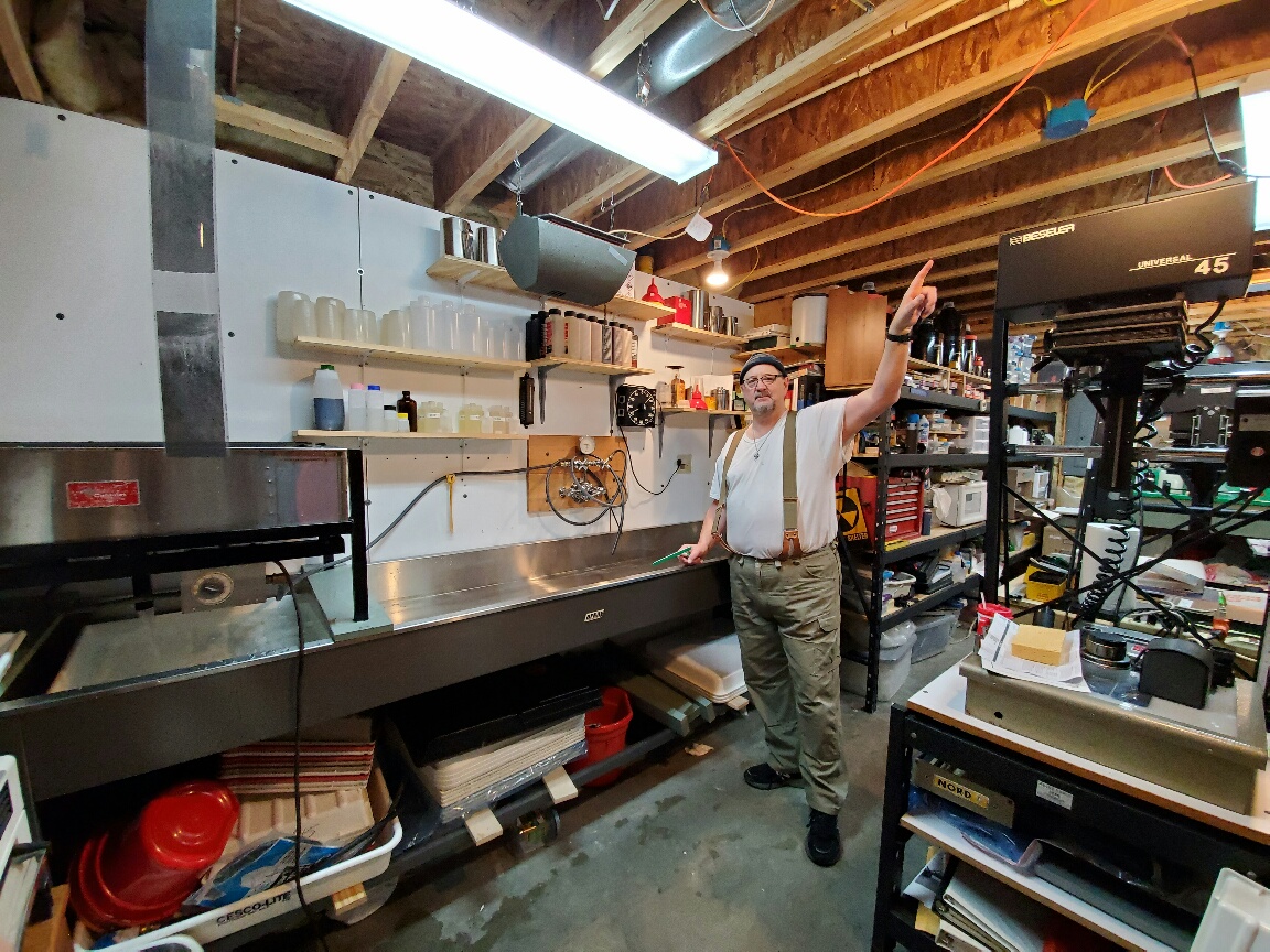

Yesterday I printed a 6 x 17 negative on some 10" × 24" Ilford Classic FB paper. I have plenty of space, and I needed it. Usually I don't go much over 11 x 14, especially with fiber base paper. I had at least 6, 20 x 24 trays going at one time. Developer, stop, fix, rinse, hypo clear, toner, hypo clear after toner, then into a big print washer. I have a drum dryer that allowed me to end up with reasonably flat dry prints. But I was exhausted after 5 hours in the darkroom. Had to take pills and a hot bath.
I made some similar RC prints from the same negative in a previous session. I used 1 tray. Kinda like a rocking print tray, just poured the solutions in, quick fix and wash, Se toner etc, (Ilford directions ) piece of cake.
It's good thing RC paper is as nice as it is these days. FB in 8x10 easy as can be. I see the guys making murals with FB on the internet, I bet they have plenty of young lab assistants :laugh:

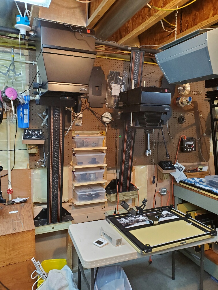

I've done the "trough" method of developing 6 foot long pan shots. That was a long time ago. Much younger :happy:.
I have 2 Zone VI 5×7 + 8×10 -enlargers with twin tube VC cold light heads. This was about a 5X enlargement, exposure was 10.5 s at f 11 with a 180mm f5.6 El Nikkor . Metrolux II integrating timer. No problem with light intensity. I have big drums, don't like as much as trays.
My enlargers and my old large self :smile:
This would be 45s at 10x, which is pertty fine at f/11...
As an aside, I noticed the folding table to holding your easel. It doesn't seem too solid--wouldn't that introduce alignment and vibration issues?
No, everything is level on 6 inches of concrete. I have other enlargers with fancy tables, this surprised me how well it works. There's no traffic or external vibration. I'm very careful. One careless bump and I recheck everything. Somehow I have a level floor. For split grade printing, I don't need to touch the table or enlarger, the controls/timer are independent.
When I first set up I built a huge platform, must have weighted 250 lbs. I moved it to add the 5x7 enlarger, I slid the table in to play around a bit and I fell in love. It's a substantial table.

Kidding aside, you have a great setup there. Stainless steel sink, even better. I've got everything I need for a darkroom except the space...it's really making me antsy.

NIce darkroom. Can you tell us how you attached the 4x4 cleats to the wall for mounting your enlargers?
I let in a 2x12 into the wall studs. Cut the center stud to allow the 2x12 to be flush. Then used SPAX brand (amazing German designed ) lags to fasten both ends to the outer studs, the 4x4's are lagged to the 2x12, and the enlargers are lagged to the 4x4s and the 2x12. I have the hardware to run guy wires to the wall, but not necessary, no vibration. I was in the right place when the original owner of these two enlargers wanted them gone. Worked out great.
I'm lucky, my wife is an artist, she's been very supportive of my obsession.

Just remembered, I glued and screwed the 4x4's to a 5/4 (actual 1 inch thick) Oak board the screwed that to the 2x12 and the studs. This isn't going anywhere.
