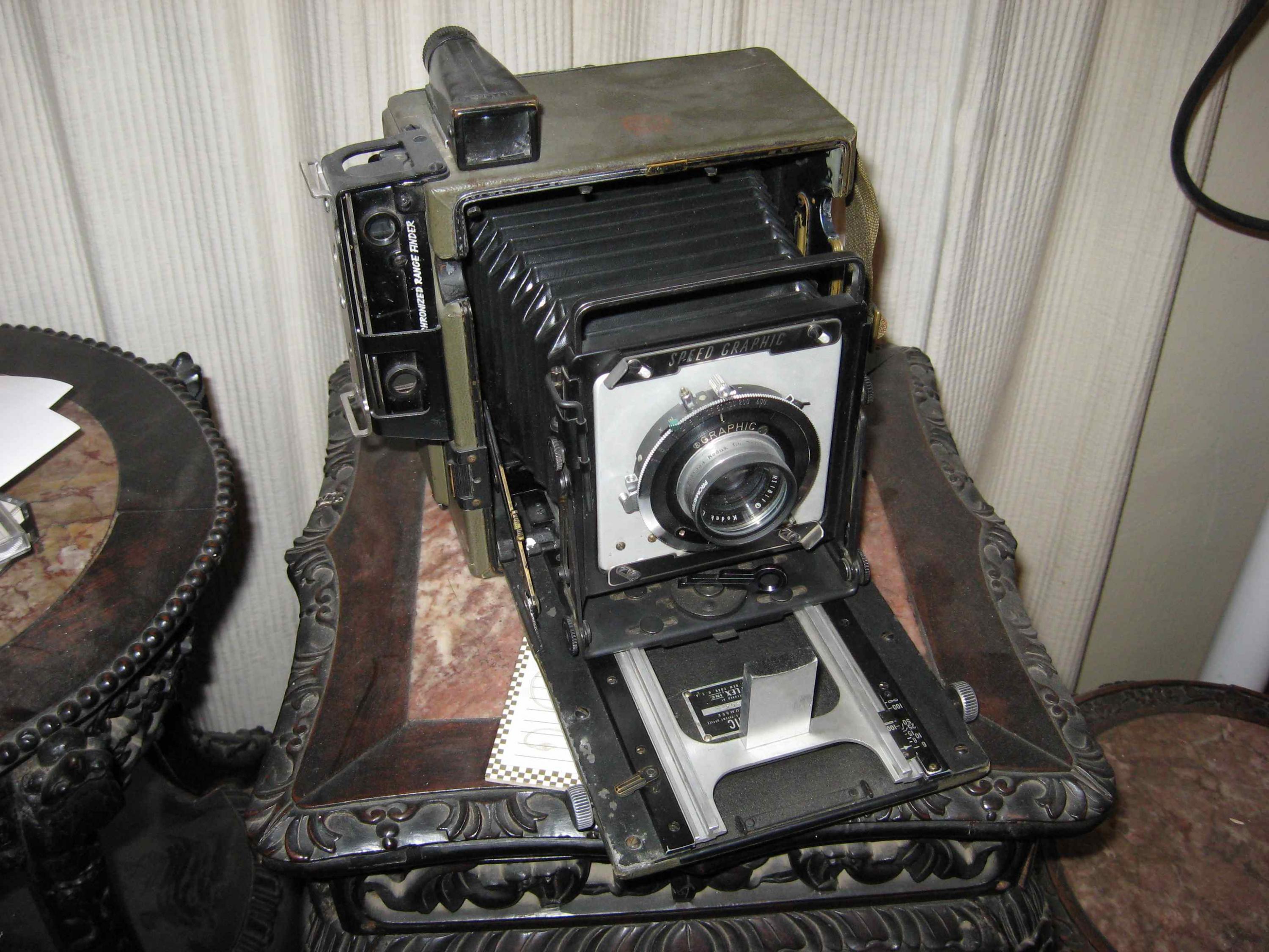

Not quite as big, but I still need a tripod.
Mike
1930artdeco
Dec 8, 2011
8
Oakland, Ca

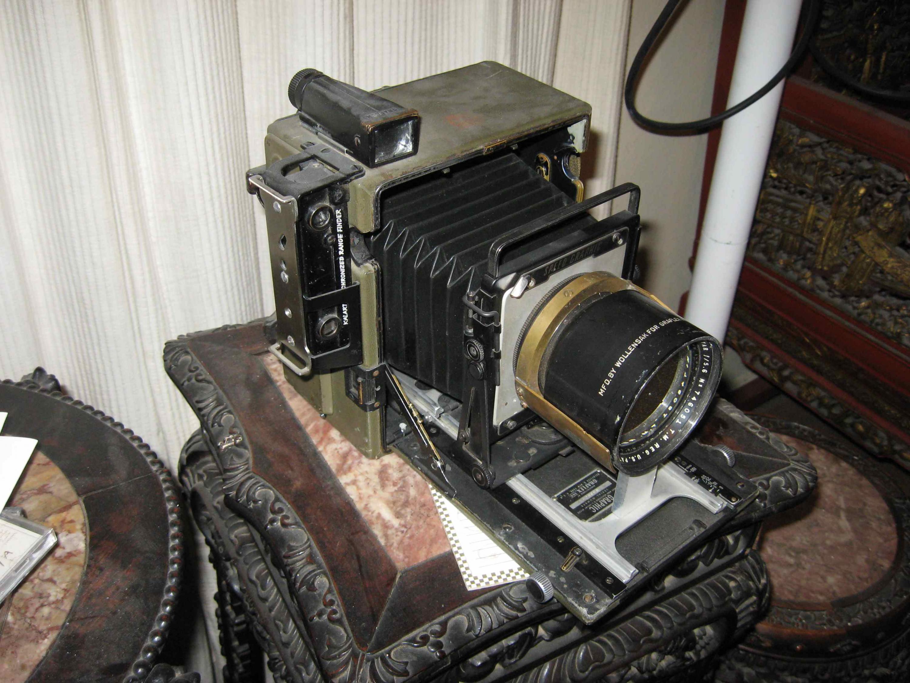

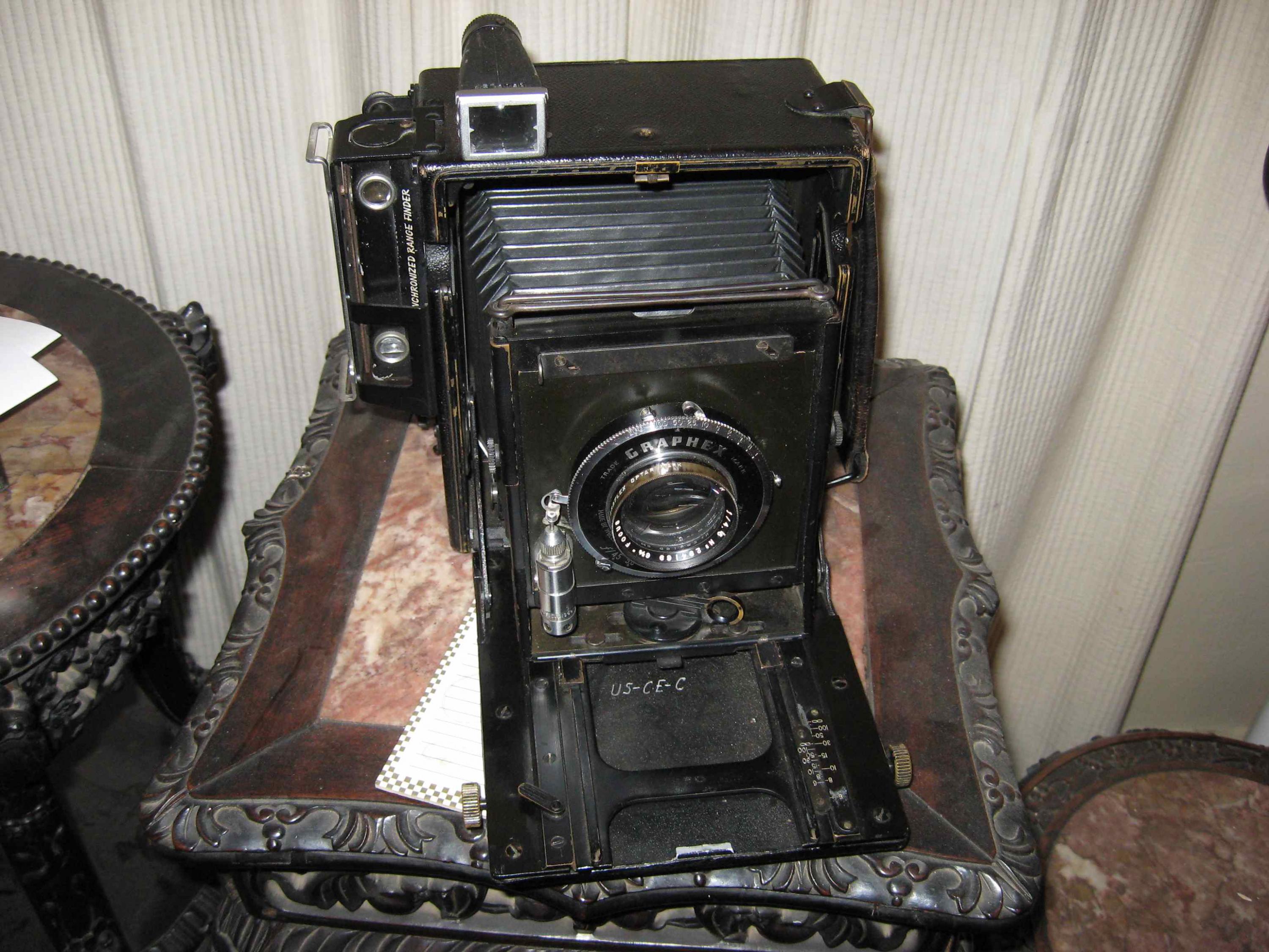

Here is the other one I use with a standard lens and the modified one with a standard and the 15" lens. They are both ex military, I am guessing from WW II. Newt_on_swings, thanks they are antique Chinese from my Great Grandfather.

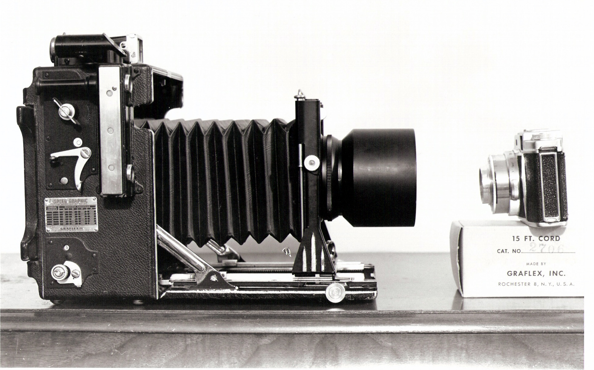

5X7 ~ 4X5 didn't matter as the papers would crop what they wanted out of whatever size neg the photog brought them. I would think 5X7 might increase your "chances".
Here's a page from a 1959 (I think) Burke and James Cat. $800 1959 bucks would stagger you now I suppose
