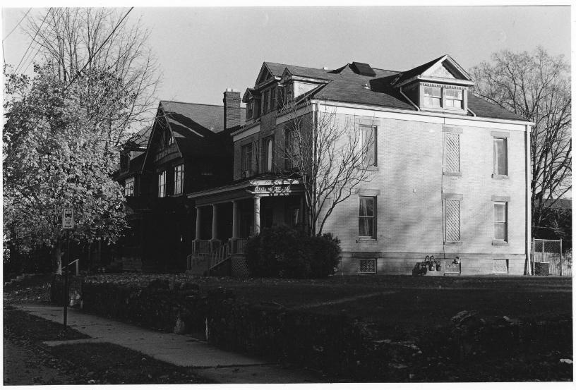

how well the detail is held in the brightest and darkest areas, no dodging or burning
From your pdf (here's a page explaining various ways to include photos in your posts):
Personally, I find that a poor example of the point you wanted to bring across. Shadow detail in that image is sorely lacking, and it's problematic since so much of the composition relies on large shadow areas. TMY2 can do a whole lot better, regardless of how it's developed - but it does need a little more exposure than this.

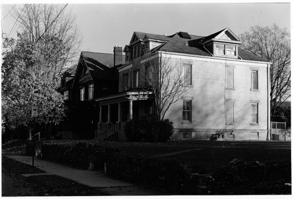

I made prints from several negatives, bracketed. This one has barely enough exposure to get shadow detail in the shaded side of the house (above the front porch). Taken at f/8 @1/250. The next one (not scanned yet), taken at f/5.6, is better. The problem is, of course, trying to get detail in the deep shade while holding it in the brightly lit area of the house in the upper right-hand corner of the image. I selected this house as a test, and the TMY-2 FX-21 combo did a fantastic job of retaining detail in both regions. The other print has not been scanned yet. My friend is doing it for me. I plan to post it when I get it. Note that the "open shade" (the front porch lit by open skylight) does have detail. The very darkest area is shaded by trees, so the light level there is very low. Remember that this was taken on a cloudless day, and the SBR is huge!
That's what burning & dodging are for. You can get it all in one exposure and it's actually not all that difficult, esp. with VC papers. But that doesn't mean the tonality will be very pleasing; you generally end up poor local contrast just so everything will fit in the total tonal scale. That also happens here. I don't understand the composition and why it was framed this way, but I suppose that wasn't relevant as it's apparently a test shot. Assuming that the shadow area at the front of the block is important, there's so little differentiation there that it just renders as a dark, undifferentiated mass anyway.
Keep in mind that this is one of those scans that for some reason lifts the black point considerably above the actual digital black point. This is a bit misleading as it can suggest (if you don't look carefully) that there's tonality in areas that are in reality void. Corrected for an objectively zero black point, this is what the scan looks like:
That makes it clear that either the print was overexposed, or, more likely, the film was considerably underexposed - again assuming that the black mass front and center serves a compositional purpose, which to me is not really clear. Either way, that supposed shadow differentiation - I guess we'll have to wait for the other print(s) to materialize, but this one most definitely lacks it.
Now, you could photograph a scene like this in such a way as to squash more of the brightness range into a more favorable part of the film curve, esp. with a flexible film like TMY2. But at that point it actually would start to make sense to think about concepts like the zone system or other approaches aimed at very deliberate tonal control. In a sense, the example you've shown illustrates the opposite of the point you tried to make: if you just develop as it says on the tin and then print straight, the end result is not necessarily very convincing. It may show what's on the negative, but it doesn't make a compelling print. Although in practice, with this particular film's long, straight HD curve, you would have a decent starting point if you just gave enough exposure and then matched the scan or paper grade to the negative.
Of course, a compelling print at the very least requires a compelling composition, so I'd always start there when it's about learning things and spending time on what happens between a camera, a photographer and and output medium. This is one reason I do ultimately agree with you (despite an IMO counterproductive example) in that OP would do well to just "do as it says on the tin" when it comes to development, provided he knows what role exposure plays (I agree with what @snusmumriken says about 'zone awareness'), so he can focus on the more important aspects of the photograph - such as what ends up in the image frame.
No, I don't think that burning and dodging are necessary most of the time. And no, the print is not overexposed. The brightest area in the upper right of the print has some specular reflection. There is shadow detail where there is "open shade", which is all that one could ask for in such a scene. I think that asking for detail on the porch (under the porch roof) is asking too much. The porch is "shaded" twice: once by the trees, and again by the porch roof.
This was a test shot, chosen because of its extreme SBR. I looked at the print again today (my friend had misplaced them) and indeed this frame is a little underexposed if the goal was to preserve a lot of detail in the background shaded areas. But looking at the print, there is detail in the foreground (the grass in the vacant lot). My goal here was to see how well the combo would work in such an extreme situation. The house behind this one is dark red brick, shaded by large trees. The grass and stone wall in the foreground are not shaded by trees, and receive light from the open sky. The other print, made with one additional stop of exposure, does show more shadow detail, but the very brightest areas (the upper right area of the print, in full direct sunlight) are barely holding. When I get the scans back I'll show you. By the way, the brick on the house is that pale yellow that was popular way back when; it is not white. There is a white splotch on the outside wall though, close to the top of the wall near the center window, and if you look closely you can see it.
One other point is that the lens used for this was the 50mm Summilux-R type II, 8-element lens (E60 filter size). It produces very brilliant images. I was testing this combo and lens too.
