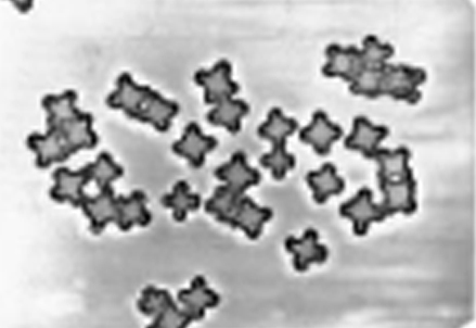

Roger;
You can tell an epitaxial emulsion from the characteristic knobs on each corner of the grain.
PE
Epitaxy on cubes
Roger;
Here is a picture of epitaxial growth on a cubic emulsion.
Originally, it was a technique developed for making high speed chloro-iodide emulsions for color paper. IDK if they ended up using them, but I know a lot of work was done on this.
Hope this helps.
Photo by T. Shiozawa courtesy of Bruce Kahn, blurring by me.
PE

Roger;
Hope this helps.
PE

In Photographic Sensitivity Tadaki Tani mentions epitaxial grains, and he does show the above EM of AgCl cubic host grains with eight epitaxial (AgBr(Cl)) guest grains at the corners. He cites Joe Maskasky, as already mentioned by PE, along with T Sugimoto and K Miyake of Fuji, and a google on those two names together will turn up some references.
