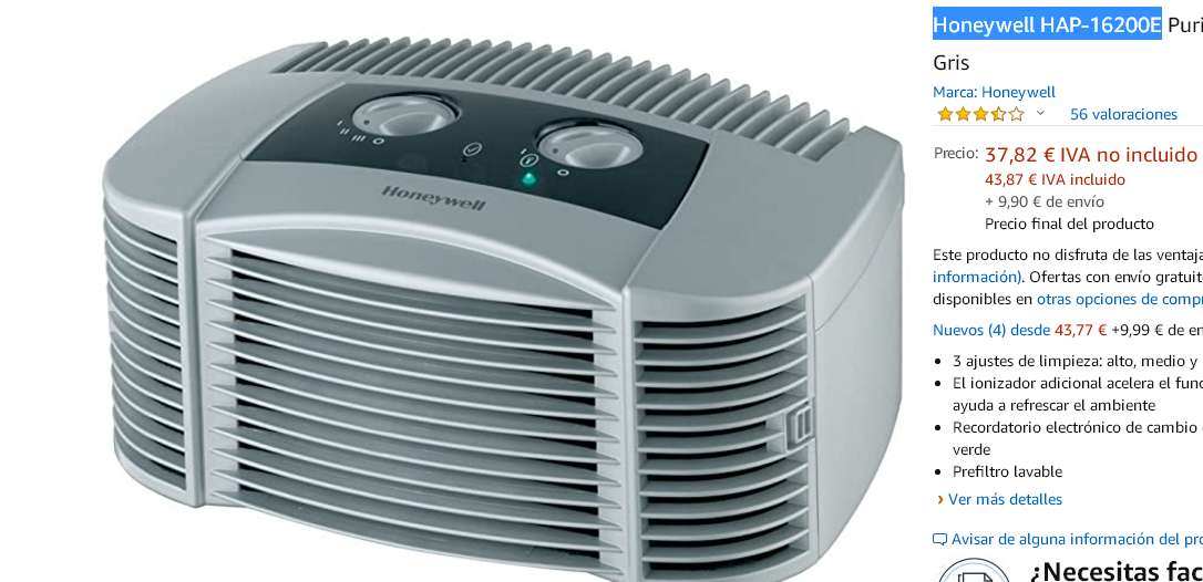

and I have developed a technique / procedure which results in almost no dust.
I use this to clean air when scanning and in the darkroom, no dust at all.
HEPA filtration makes wonders
For Epsonscan and Vuescan, the 8x10 mask gives the scanner the needed information as a holder does. I would think it would work with SilverFast. The lower glass raises the negative to the proper height. I’ve been scanning LF and 120 this way for at least 15-years.
The HEPA filter is also a good idea.
