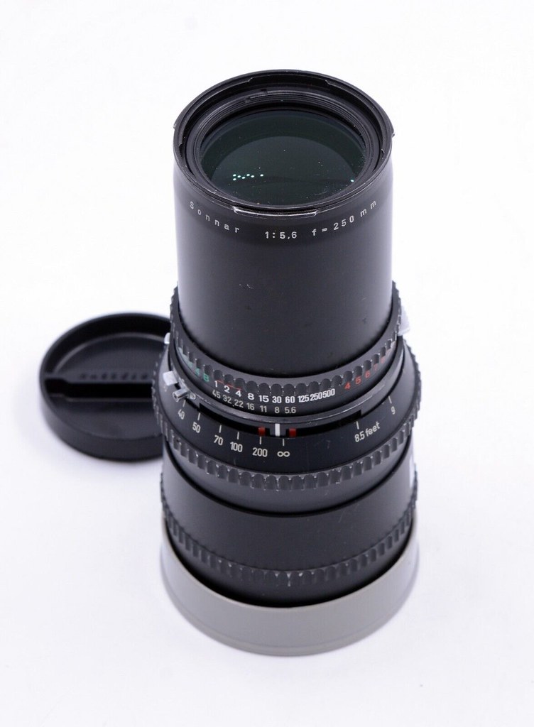

New to Me Hasselblad 250mm f5.6 TStar Sonnar by Nokton48, on Flickr
New to me Hasselblad Zeiss 250mm F5.6 T* Sonnar lens in excellent condition. Needs a CLA but was only $100 US from MPEX. Went to pick it up but that already shipped it. Should have called first LOL. Anyways it's coming soon.
"Speaking as a lens designer , the standard 250mm Sonnar is built with 'normal' glass and hence has quite a lot of secondary axial colour and lateral colour. I'm not saying that good pictures can't be taken with it, but there's a reason that the Superachromat version was offered."
Thanks for this. I had one of these many years ago and didn't use it much. This may change with my new CFV Hasselblad Back; I'm trying to fill in the gaps.
I just snagged a great copy (I hope: haven't received it yet) of the 180 from someone local. Also got the 100 a few weeks ago, and I really like it. Thinking I'll leave the 80 at home and carry the 50, 100, and 180: almost symmetrical.
<snip>
Zeiss has very specific optical definitions of apochromat and superachromat, which align with the dictionary definitions.
- achromat - 2 wavelengths to a common focal plane
- apochromat - 3 wavelengths to a common focal plane
- superachromat - 4 wavelengths to a common focal plane
The 250 super was designed for IR and UV work, the 2 extra common focal nodes are in the IR and UV spectrum, the visible spectrum has the same # of nodes as the standard 250. However, the side effect is that secondary aberrations are reduced in the visible spectrum, which is why it's a nice lens.
And note that the term "apo" has been used by marketing to mean pretty much anything. And having 3 or 4 wavelengths focus on a common focal plane does not mean the lens is sharper, but if your are going to all that extra trouble, you may as well ensure it's good.
I would suggest you checkout CLA prices. It is my understanding that my 250mm CF's CLA required all the lens element be removed to get to the shutter to service it and the lens elements required recollimating. In my case KEH covered the CLA including the recollimation and shipping at no cost to me.
It does actually, because the residual errors across the VIS band are inevitably lower if you can get 3 or 4 crossing points.
But otherwise I completely agree with you. Zeiss took the 'academic' version of the naming and stuck with it for most of the time ; however the use of the term 'Apo' was more loosely applied by other manufacturers. On balance though, even though a lot of 'Apo' lenses are only reduced secondary spectrum, the MTF is higher and colour rendition better, so the user is not normally short-changed.
The 250 Sonnar was designed a LONG time ago, and has a very thick central element, to avoid having extra air/glass surfaces, which made more sense in the days of single coats. With later T* versions, it should have very good 'microcontrast' around highlights, despite its limited MTF.
ps. Any lens with colour like this will get usefully sharper once you use filters, when shooting in B&W, just bear this in mind if you have a choice.
pps. I designed the 300/2.8 TSA, but i can't remember how many crossing points it has !

It is my understanding that my 250mm CF's CLA required all the lens element be removed to get to the shutter to service it...
I believe that all Hasselblad lenses require removal of the lens modules to access the shutter (and probably many other brands of MF lenses with shutters too).
And not having to imprecisely refocus for IR work is certainly a boon for such a long focal length. Both lateral and axial CAs for the lens are reduced to the Rayleigh limit, so are effectively non-existent. As to resolution, the image center hits the diffraction limit of white light wide open.
Yes, an assuredly "nice" lens indeed :wink:
