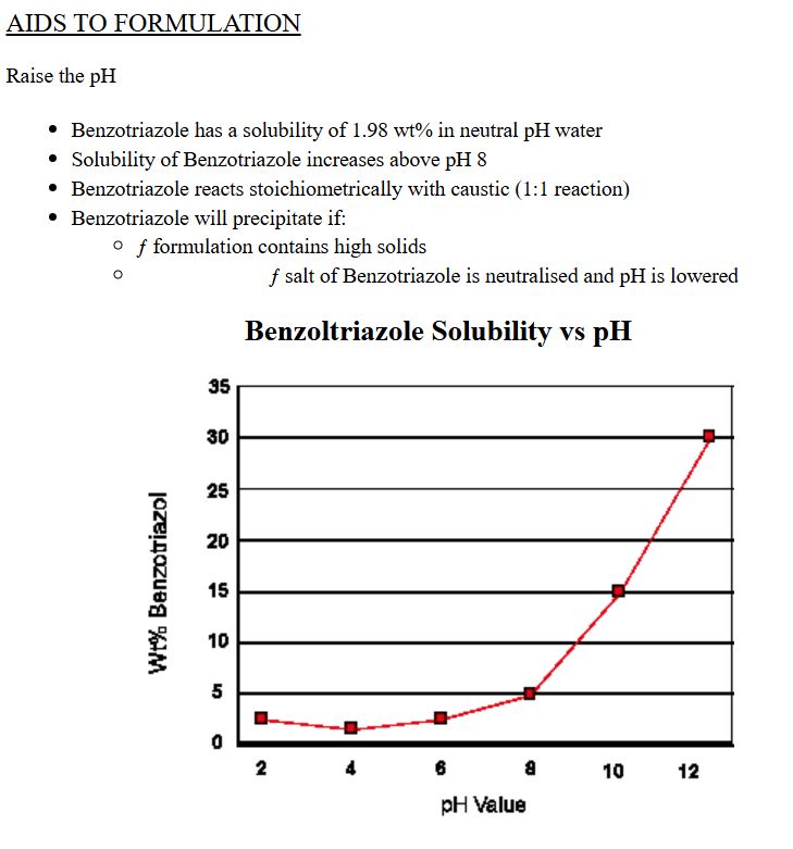

Benzotriazole is more soluble in alkaline water. A bit of sodium sulphite would be enough to help, and even a little carbonate wouldn't hurt the developer. See attached, copied from the web years ago from a US manufacturer's site, name forgotten sorry.
Thanks for this, John. Good to know,
