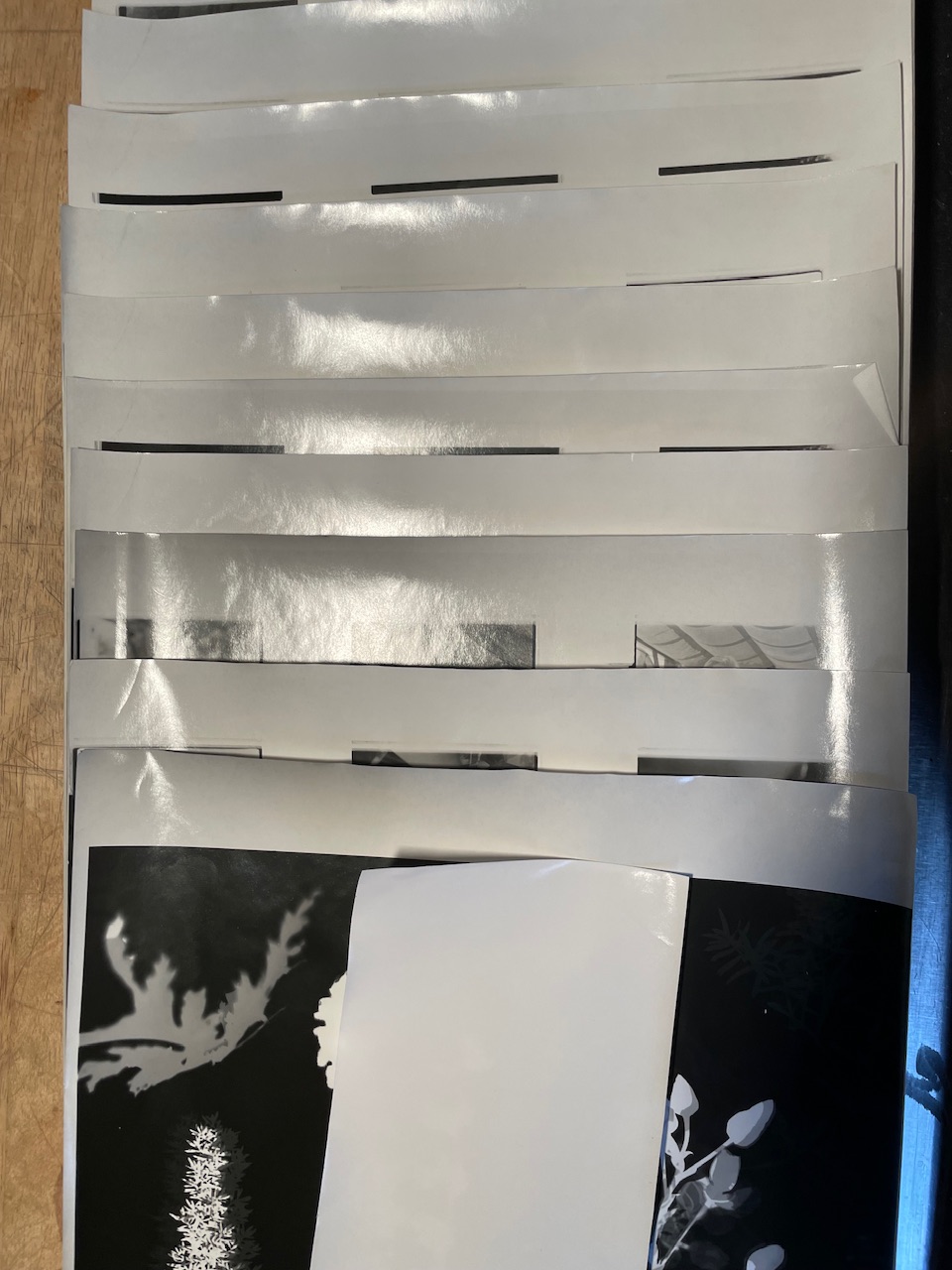

Maybe good for a base for alt processes or emulsion making (e.g., fix, wash and dry then you have a good quality paper with baryta coating to print on.) A friend on a Facebook group about Alternative processes, Katherine Zelda would take the paper if you can’t use it. to coat with a homebrew emulsion using a formula by Mark Osterman (of Osterman and Scully, Rochester).
Don’t cut the paper until you find out the part that’s good. For example this 11x14 Kodabromide F3 single weight paper is slightly fogged on the open end of the package. As I go deeper in the box it’s getting better but still I would only use the middle.
A piece that’s fixed without developing shows the base paper. I don’t know why every corner is cracked but it’s probably the way I pull out each sheet without fully opening the wrapper.
It’s frustrating to use fogged paper. You’ll doubt that the fixer is fresh and think you turned the white light on too soon. You’ll wonder why your best print looks off.
So definitely do use it experimentally after you have confidence from using fresh paper for a while.
