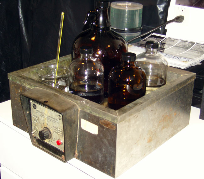

I inherited this water bath my dad used to use for heating chemicals in the biology lab. It has become indispensable.
American Scientific and Fisher Scientific both made them.
An outfit called Shellab still makes similar devices. In a size similar to what you have would be quite pricey. You have a great find there.
