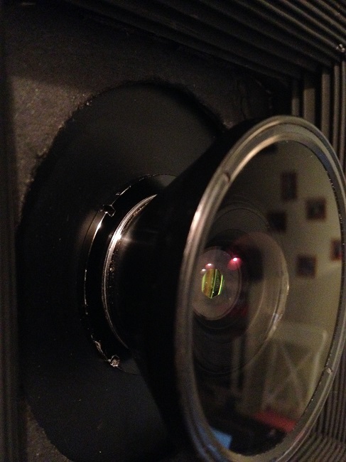

Dan,
tih has described exactly what I'm talking about. Here are the pictures from my SA showing what I mean. As you can see, the front of the lens blocks some, but not all of the image-forming light when wide open. Stopping down kills it all but completely.
BTW, I have experienced this in the field, i.e., getting what I thought was enough illumination when observing the ground glass wide open, then stopping down and discovering vignetting only after developing. Now I check at taking aperture :smile:
Best,
Doremus
