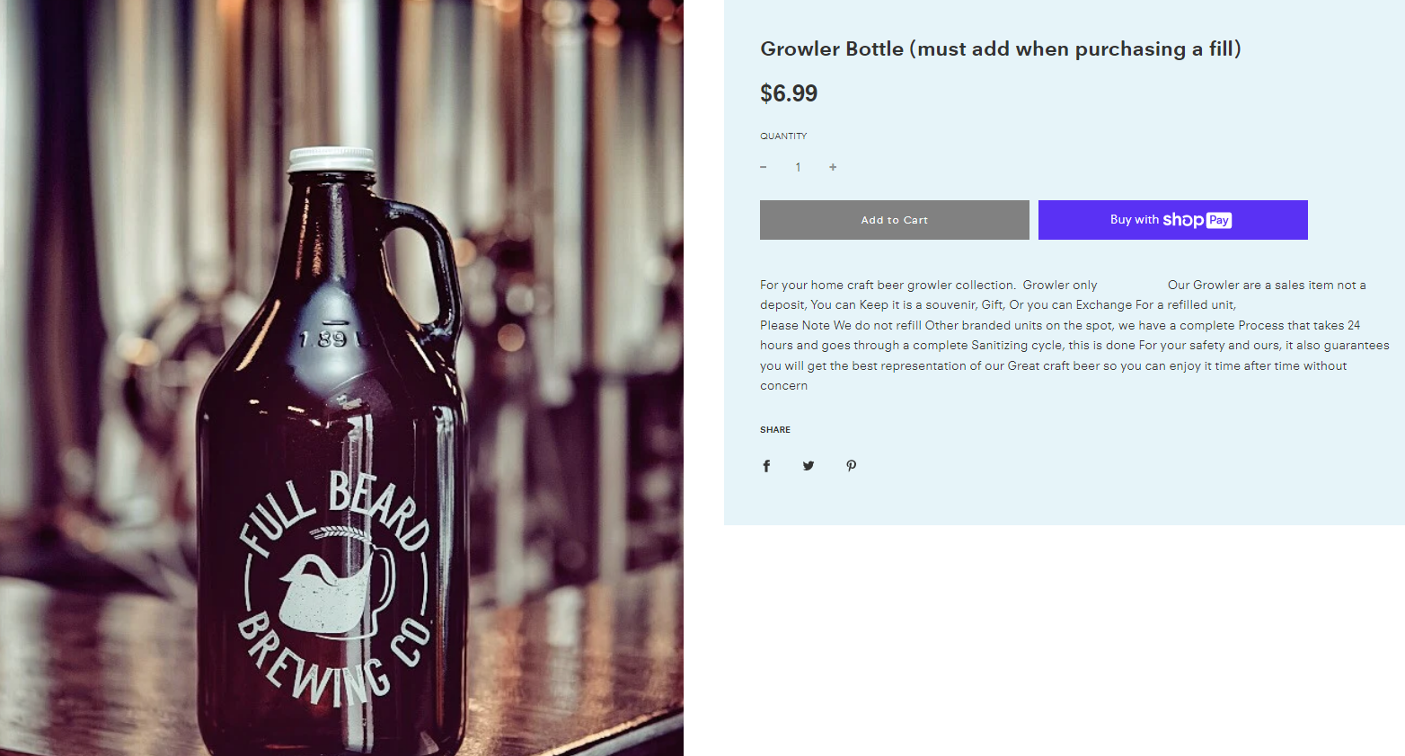

The "growler" bottles that can be used for filling with a craft brewer's beer (in some jurisdictions) are particularly good. Good, amber glass, good sealing caps and a fingerhold as well.
This sort of thing:
