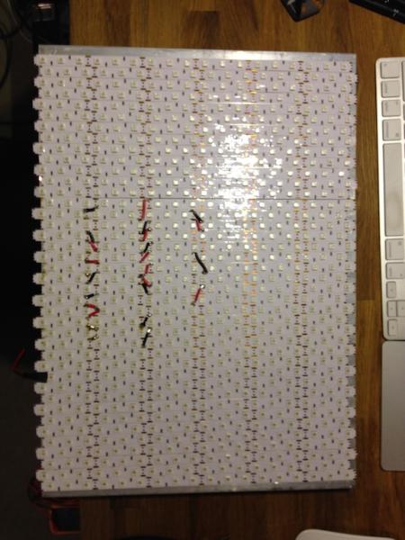

I'm going to try a relatively cheap eBay experiment with 395nm UV LED strips... Will total 180w for 11x14 of area - I would like to think that will give fairly quick exposures but lets see. I'll make the whole top of the printer a large heat sink. The cost for all the LED strips is about the same as two good UV tubes here in Australia - and that doesn't factor in mounting, starters and so-on. I'll update here once I've got it all together.
jamespierce
May 22, 2007
75
Australia
8x10 Format
For the interested I assembled 1/3 of the lamp and did a couple of quick tests. Without glass it can fully blacken a platinum/palladium test strip in about 15 seconds. A quick 4x5 contact print looks good but a little light at 1m15s - I'm expecting working exposures in the 1m45s to 2m30s range once it's all together. The exposure is extremely even too. I've just finished soldering together the second and third panel and will make a box to mount them in in the next few weeks - then I can test the full size with 8x10 negs.
Here's a quick photo of the LED array.

It's 720 5050 UV SMD LEDs (actually 2160, but they are mounted three into one surface mount enclosure) - Total current draw is around 15A @ 12V to power the array - So compared to a bank of UV fluros it seems like it should be much more efficient.

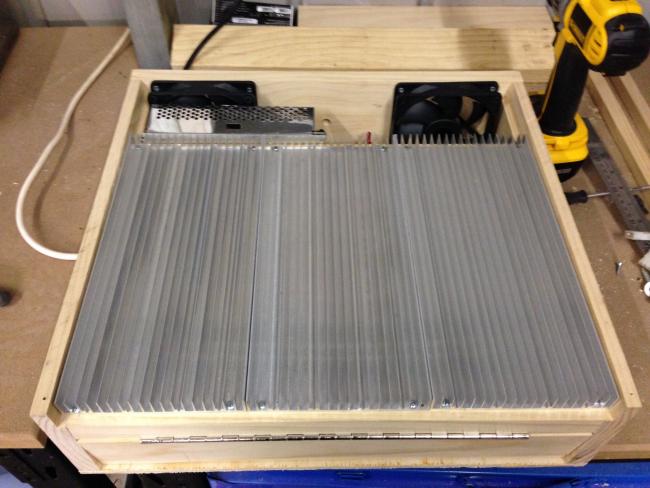

A construction update
And it's finished and into testing. The imaging area is ~280x400mm - The box was designed for printing 8x10s and just fits an 8x10 contract printing frame because that's what I shoot. Because I wasn't sure how long the exposures would be I built it with a fan setup for both the power supply and also the heat sink that the LEDs are mounted on - in retrospect this may have been overkill. Printing times are in the 3-5min range and the heatsink doesn't seem to get warm to touch at all after that length of time. Probably with very dense negatives I'll need to go much longer and this will pay off. I made an 8x10 test print last night and the exposure looks extremely uniform across the whole printing area with ~75mm between the LEDs and the surface of the paper.
Now I just need to conquer the ins and outs of managing humidity and making great prints - I'm currently following this process (http://www.mikeware.co.uk/mikeware/Platino-Palladiotype.html) because the chemicals etc are available here in Australia but would welcome advice and sources for the cheapest supplies of particularly the platinum and palladium power / solutions.
Total cost approx ~ $150USD. LEDs $60, Power-supply $20, Heat-sinks $40, Timber switches, and so-on $50. Total construction time around 8 hours.
Before wiring and a putting on the lid.
In place in the darkroom, the total foot print is 450mm x 400mm x 135mm

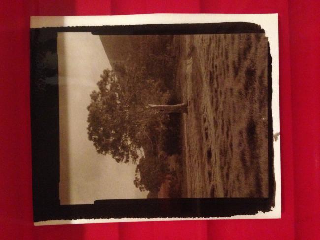

My first test print out of the unit barely into the clearing bath, 5min total exposure - just a touch over
