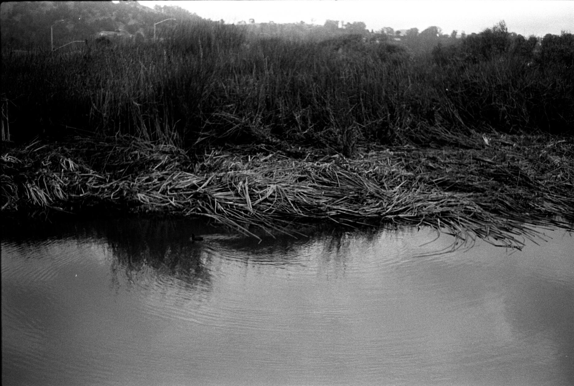

Meanwhile I often walk about with a camera that only has center weighted averaging.
I struggle to get correct auto exposure with the ES-II. Constantly checking indicated shutter speed to make sure it’s not stupidly wrong.
Here it was exceeding max 1000 when I first brought the camera to my eye since there’s sky in the frame.
When the light throws off the meter I will go to manual. That’s 1000 to 60 and B (plus on self-timer ES-II gives one second on B). First check the indicated shutter speed with the stray light excluded, then use that manual setting and take some pictures without checking again.
The old “meter the palm and open a stop” trick often comes in handy.
