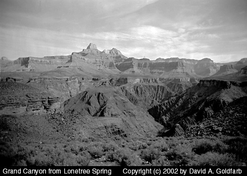

Here's one of mine, circa 1985. The scan isn't so great, but the detail in the print is pretty remarkable. As with K-25, I eventually gave it up when I learned it was easier to get just better results by using a bigger camera. Of course, if I were really obsessive, I could use Tech Pan in 4x5" or 8x10" (which is really expensive compared to other kinds of sheet film), but I don't really make huge enlargements, so I can select a film more on the basis of tonality than issues like grain or the resolution of the film.
