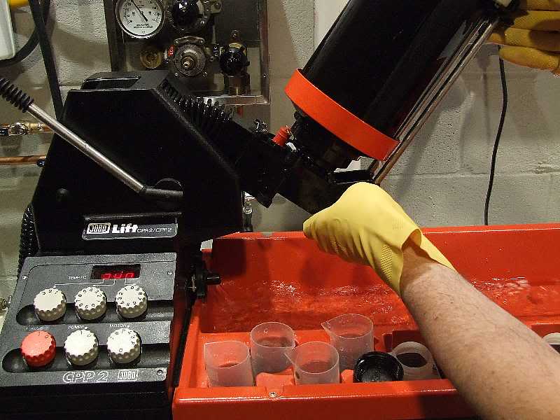

Almost 20 years after making the decision to use the ATP in my arms to power the chemical transfer process (rather than tiny hoses and pumps) I'm glad to have purchased a Jobo CPP2. The chemical transfer function is still working fine, never had an issue.
