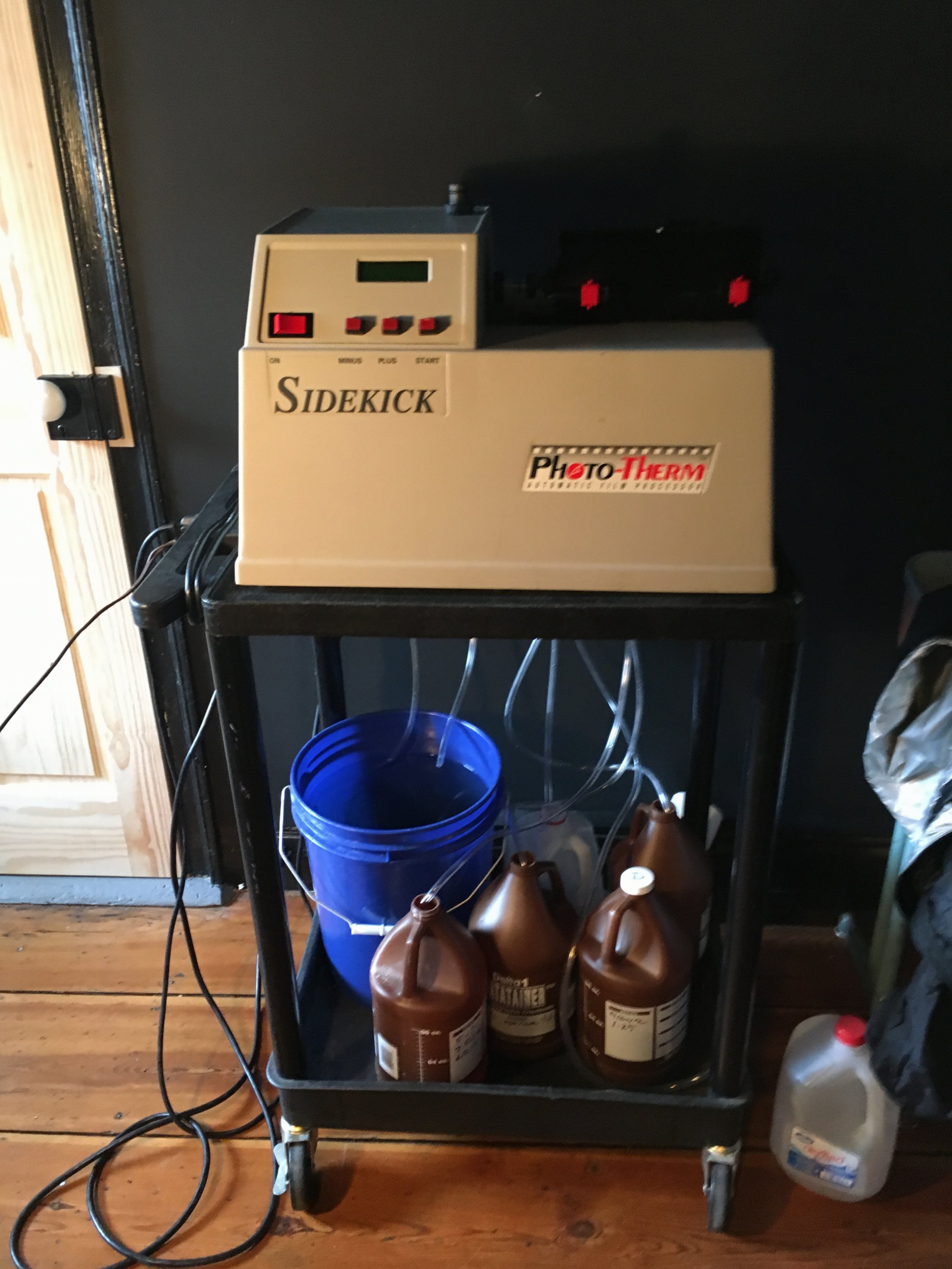

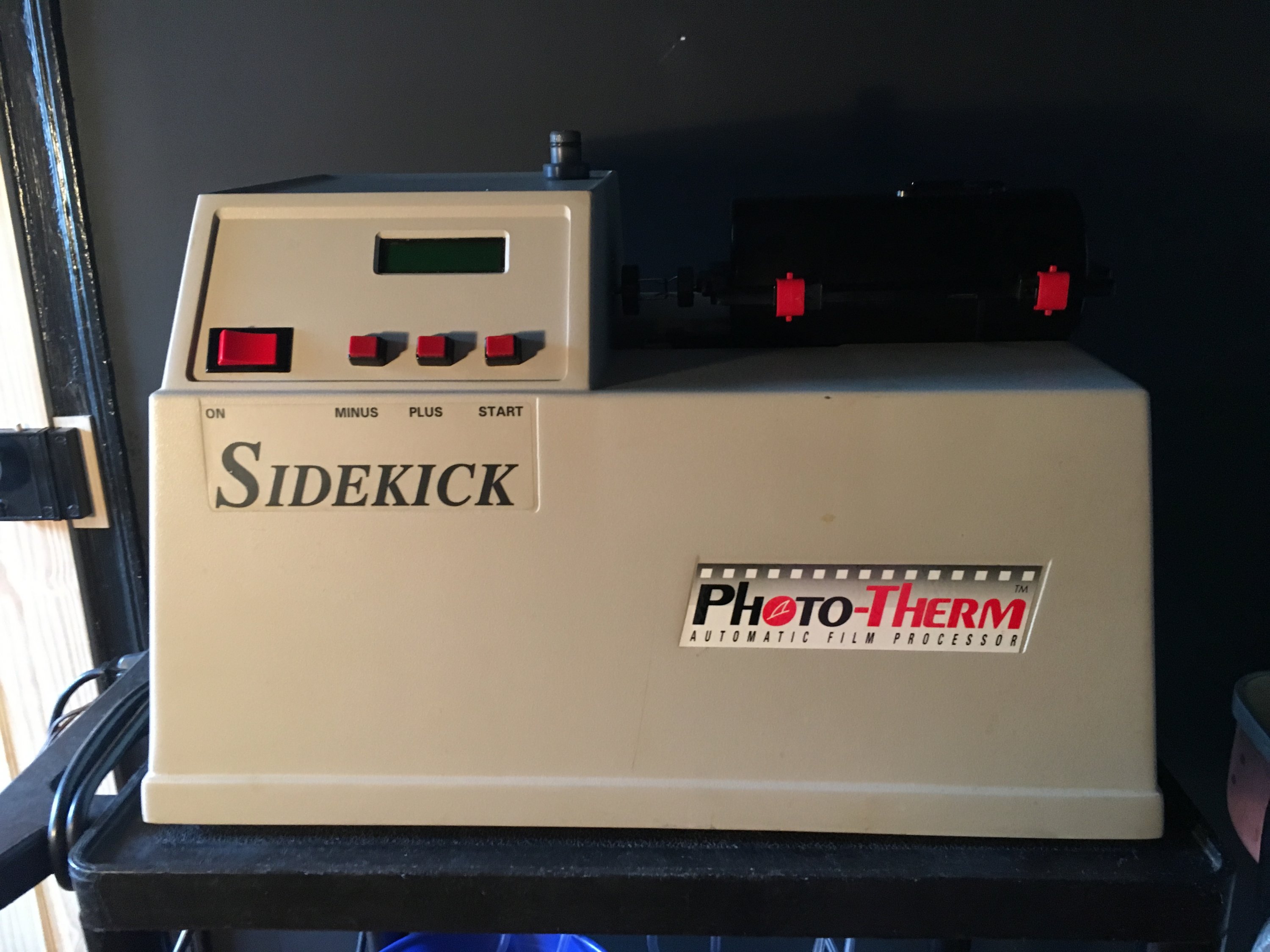

Thanks Matt and PittP, So I'm the proud new owner of a used Photo-Therm Sidekick! It looks to be in very good condition. It came with some new hose but no chem. bottles. Do need to use the specific Photo Therm bottles special bottles or can I use more ordinary chemical bottles?
Also any tips on setup appreciated, thanks!
-James

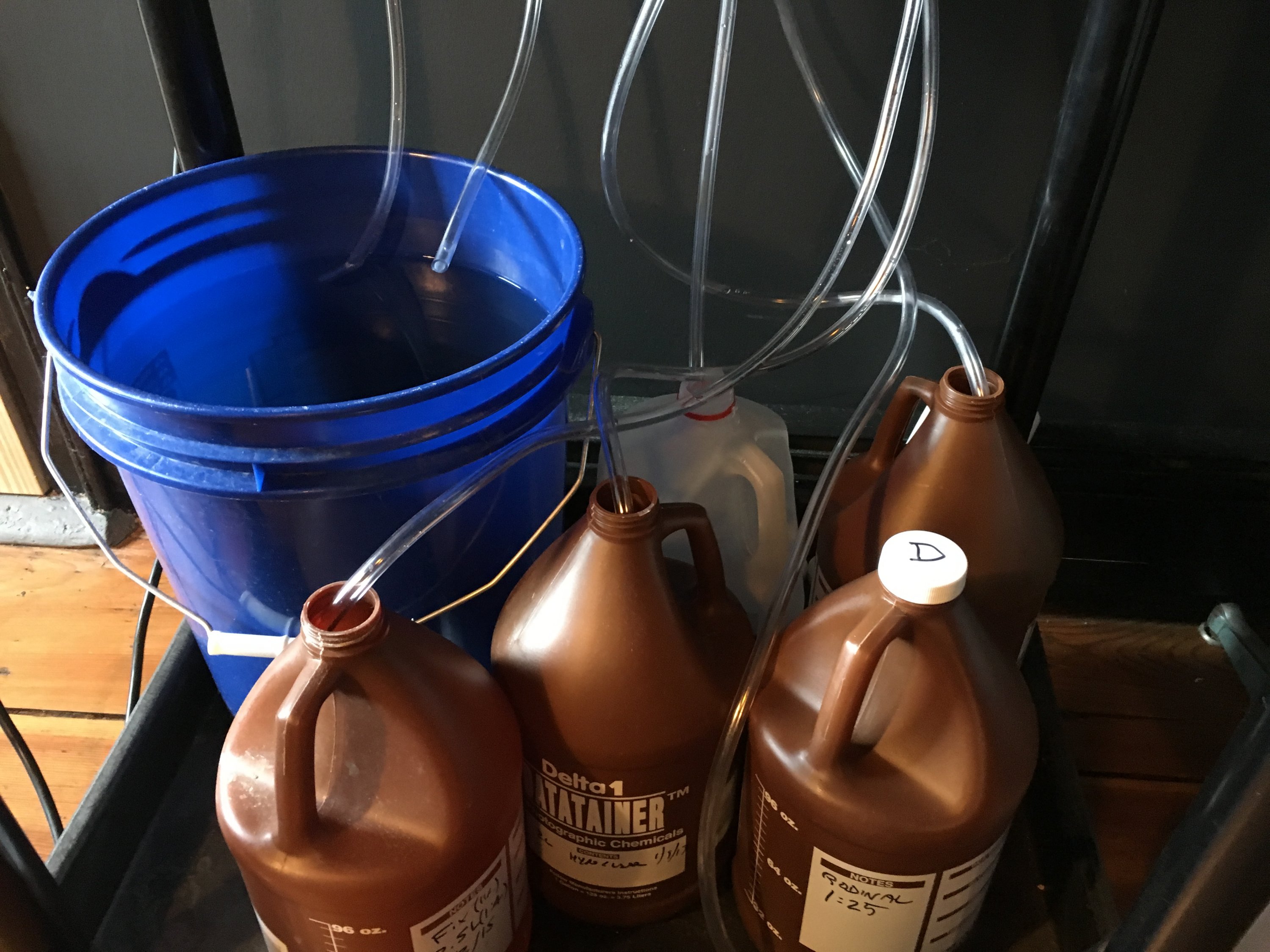

Bottles: Anything clean is good, make sure the clean water reservoir (tube 5) is big (and full) enough to allow for the machine's wash cycle at the end of each run.

I use generic 5L containers from walmart for the phototherm chemistry bottles, and a 5G carboy for water supply (which will cover 3 complete runs of 4 rolls of c41.).

Thanks everyone for the tips. My first impressions are wow, it works. I ran new lines and everything seemed pretty clean so I decided to go ahead and test a roll. I shoot BW Tri-X 135. I use Rodinal and have been processing by hand in steel tanks for years ( I like the sharpness, big grain, and dynamic depth of tones ). But I wanted to automate the process so I can shoot more and take care of other chores while processing is going on. One thing I'm not sure of is exactly which model I have. This is not a Super Sidekick so I don't think it is programable? I believe I have a SK-4. It processes Tri-X at 4:40min at 75 degrees F with constant agitation. I used Rodinal at 1+25 which has a similar suggested dev time at 75 degrees.
First run I developed one roll w/ the spacer in the tank. The film looked fine except uneven processing/underdevelopment on first three frames. I noticed the spacer leaks and may have old chemistry in it which could contaminate developer during processing, it could also drop the level of the chemistry by absorbing fluid in tank. This is a problem I need to fix. ideas?
Second run I developed on roll w/ spacer in tank. The film looked fine but again there was one frame, this time near the middle of the roll where I saw uneven processing. weird, eh?
Thoughts: I'm using Delta 1 Gallon chemistry bottles because that's what I had on hand but they are opaque so its hard to read chemistry level. Also I just dropped the hoses into the open neck of the bottles but I'm worried that evaporation will change the dilution strength (developer critical). Any specific suggestions for bottles, and lid fittings to see levels of chemistry and prevent evaporation?

About the model, what does the serial number plate say, and what do Phototherm tell you?
And what do they say about the uneven development and the spacer?

Depending upon the size of the bottle's neck, maybe a brewer supply. I believe they have rubber stoppers with holes for venting, etc. that you could possibly use.

I spoke with Jerry at Photo Therm today. He was very friendly and helpful. Ordered a new spacer ($70). It turns out I have a SK-8G manufactured in 1996. He suggested I reset the fluid level sensors in the heat tank and explained how to do it. He said this would fix my uneven development problems on first few frames.
I'm excited to learn that I have an 8 reel model, unfortunately they no longer stock the 8 reel tanks. Anyone have one they'd be willing to sell me? For bottles he suggested buying them from US Plastics.com and just drilling a hole in the lid for the tubing with a second pin hole for pressure equalization.

Regarding bottles, I would recommend buying bottles that are similar shaped to the originals because they are 1) easy to fill and mix with due to the large mouth cap, and 2) very space efficient and can be secured in a smallish rectangular box for each process. Also Photo-therm can supply the fittings for the hoses, that keep things neat and avoids spills. You insert small diameter black tubing into the inside of the clear tubing for a nice fit and the black tubing goes into the fitting which is compression type.
