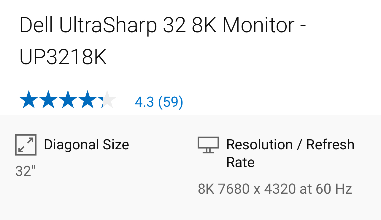

As I stated earlier high resolution isn't as important as color accuracy but a high resolution screen is better as it allows you to see a larger part of your image at pixel level. Right now only 8K class monitor can display a 24MP image from the 262 entirely at pixel resolution.
Wow, they’re getting there…🖥️
