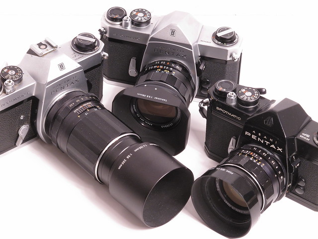

I have used a variety of Pentax Spotmatics and all were upscale/professional cameras. Since all are now used cameras, their used condition is probably the most important factor.
Pentax Spotmatics by Narsuitus, on Flickr
