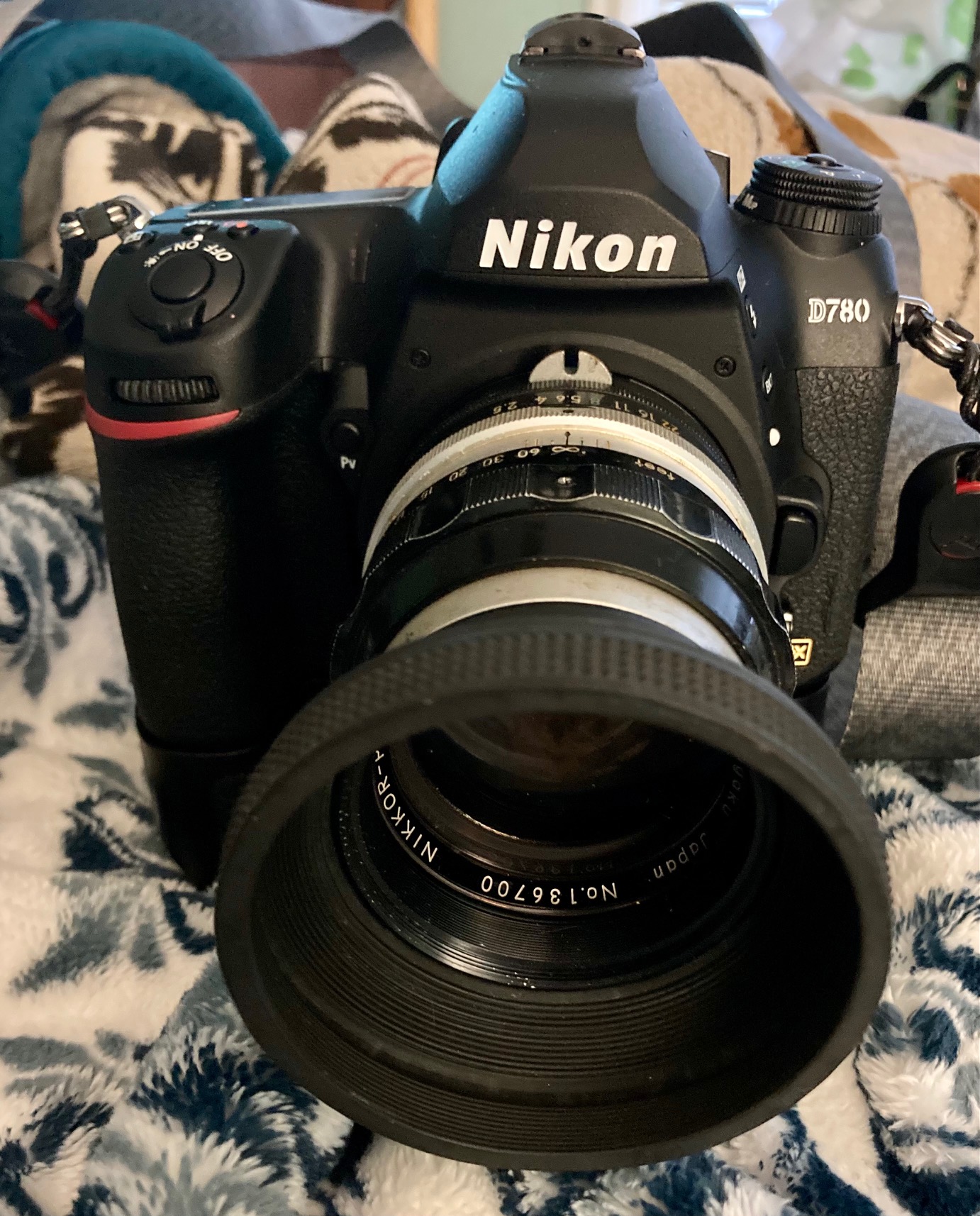

Just got an F so my Pre-AI lenses have a home now. It came with a 105 2.5 but it's an AI-S with prongs.
