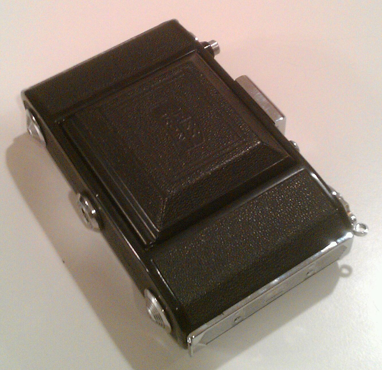

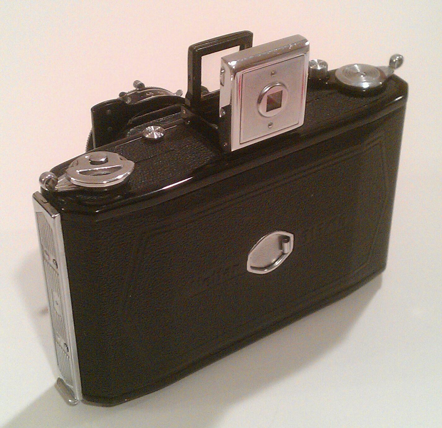

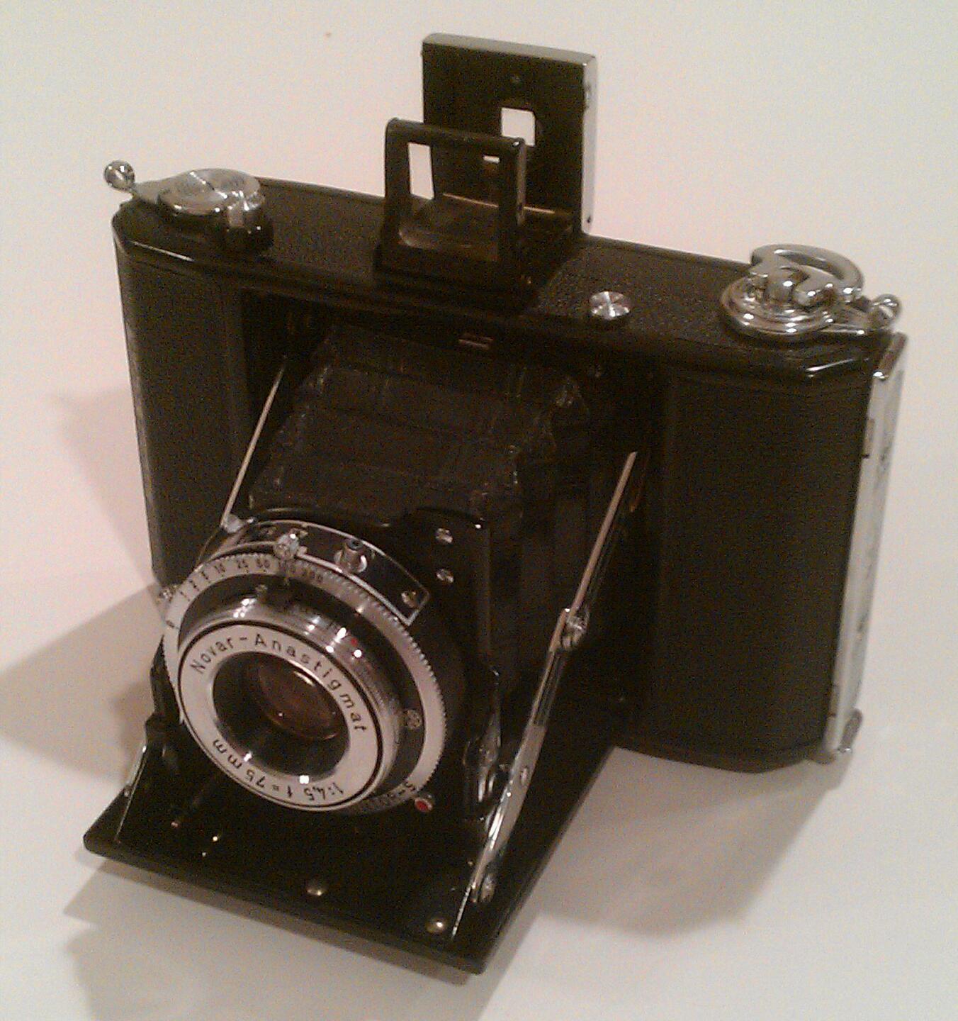

The Zeiss Nettar 515/16 is 6x6 format. It has a direct optical viewfinder, scale focusing, apertures from f/4.5 to f/22, shutter speeds from B, 1 sec to 1/300.
They are very compact and rigid when opened. The bellows material is of good quality. This camera is fun to use.
Mine originally had a reversed rear element from someone's prior attempt at fixing something. That produced blurry fringe areas. After fixing that, the images are now normal, but I don't think this lens produces very sharp images - maybe it's just my camera. I don't know about the reputation of the Novar lens. At infinity the images are soft. Medium distance seems acceptable. Close up requires careful distance measurement at wider apertures. I've tried to choose f/11 or f/16 for best sharpness - not the usual f/5.6, f/8.

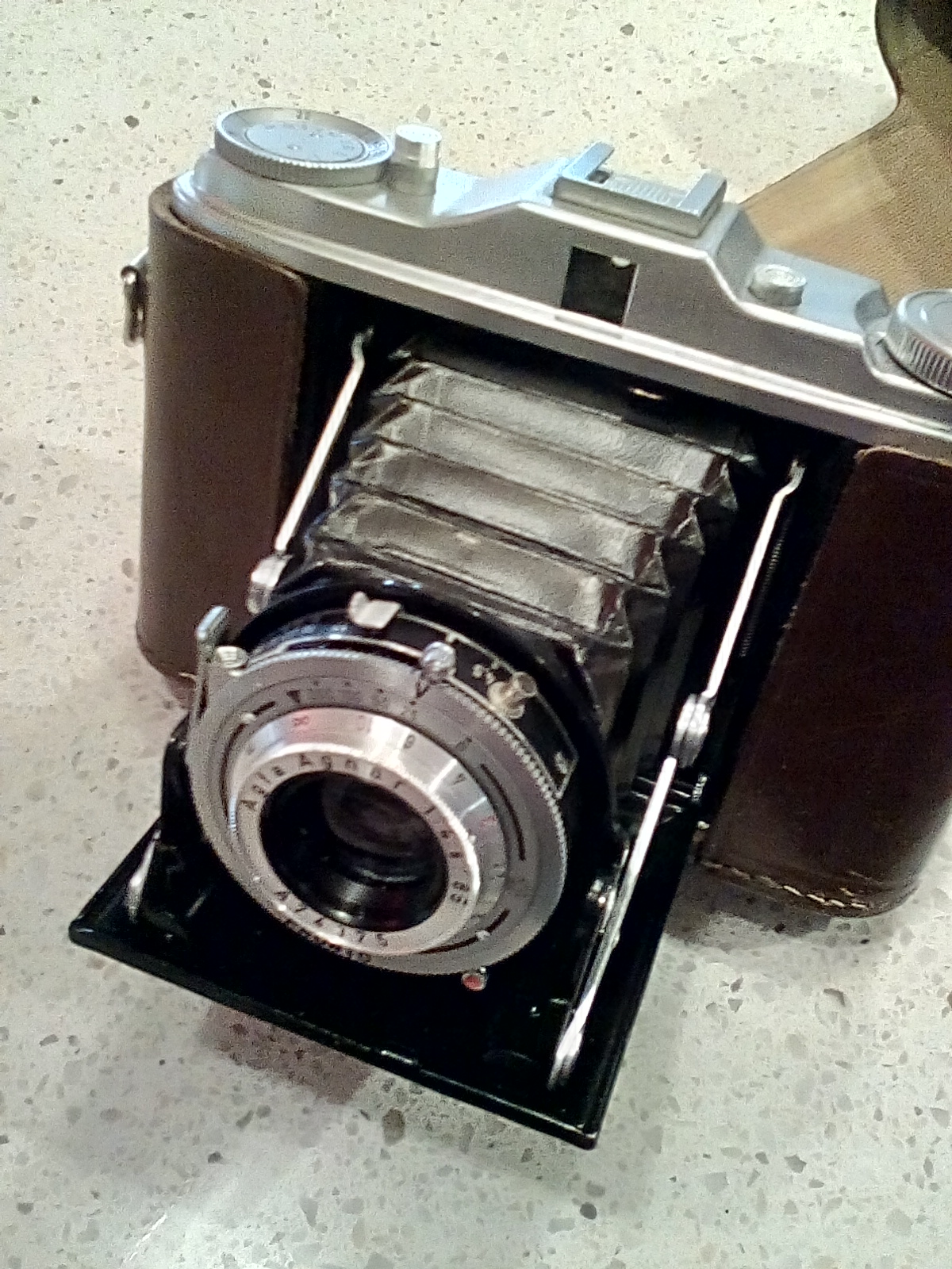

A warning on the agfa folders, they have a bad habit of the grease used for focusing turning to glue..
I've restored an Isolette I and a III. No solvent would loosen that epoxy-like green gunk. I put the lens group in the oven at 200° for 40 minutes or so, and they unscrewed with a simple home-made grabber-thingie (some people use two hose clamps). Then they cleaned right up.
The III has an uncoupled rangefinder, and it was seized as well, same green gunk. I held a soldering iron to the threaded bolt where the lube goes and it eventually came loose; cleaned and collimated it and it is simply a kickass little camera now. Stopped down a bit and the negs are very close to RB sharpness. Really love that little guy!
The Isolette III has an uncoupled RF that's very accurate. I've gotten good at finding eBay auctions that just say "Isolette" and look for the extra RF window. I think I paid $25 for my III, it has the Apotar which really surprised me with sharpness when stopped down a bit. I did have to bake the lens as mentioned above.
