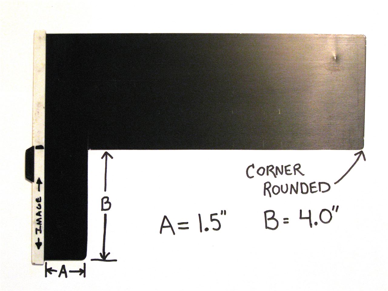

The easiest way I can think of would be to use rollback on a 4x5 camera with a modified darkslide to expose half the frame. Then flipped the darkslide over to expose the other half.
I have done this with 8x10 and 11x14, but the same concept should work for most roll backs. I have attached a example of a modified 8x10 darkslide for making two 4x10 images on a 8x10 sheet of film.
It could possibly also work with some 120 cameras that can do multiple exposure and use a darkslide.

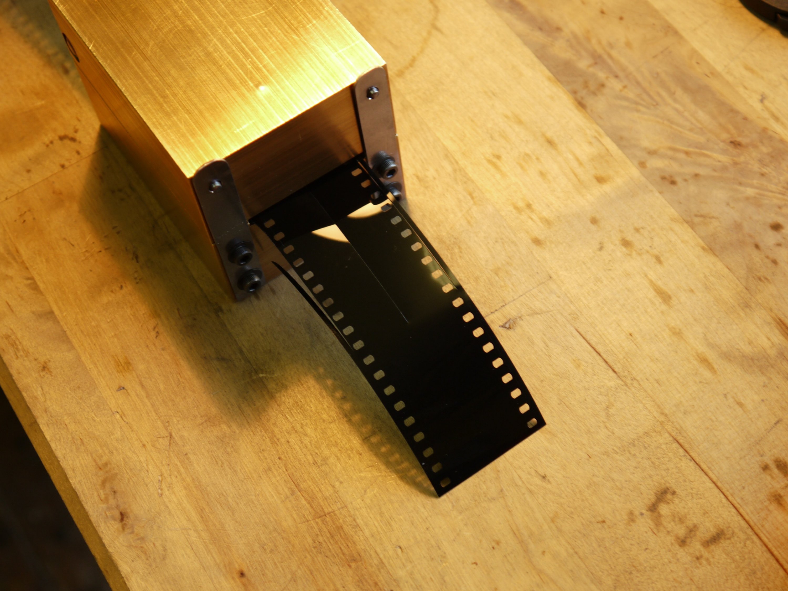

A splitter I made for somebody some years ago
Two 16-mm. strips can be cut from 35-mm. film.

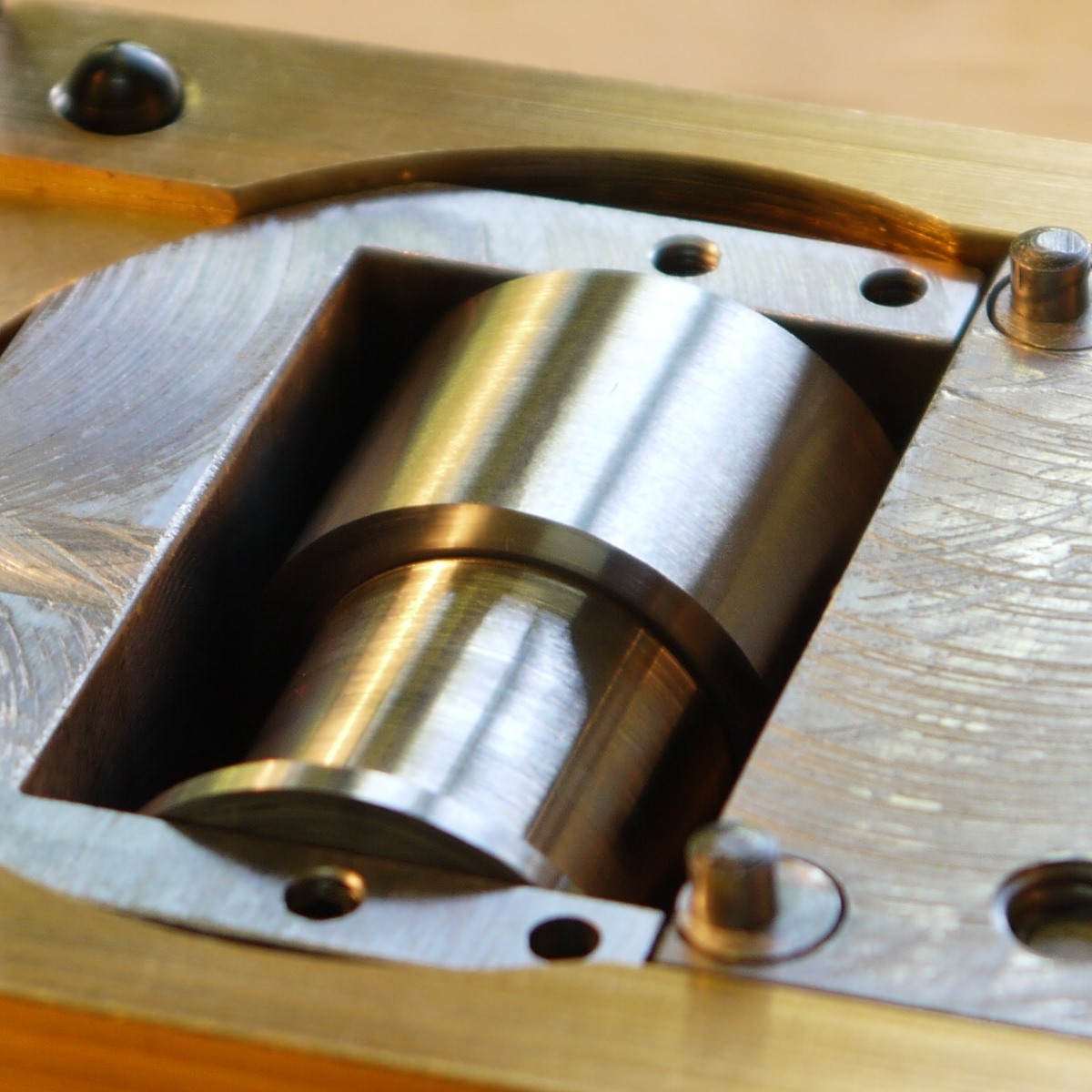

A view of one of the cutting drums
This is by far better than any design that uses a blade. Did you buy the cylinders or did you make them?
I did everything myself. The cutting drums are made from a through-hardening tool steel, turned roughly prior to the hardening (nice martensite), then the ID honed to a slide fit, set up on a ground mandrel, and the exterior ground. I have left 0,01 mm play between each of the cylindrical lengths. You can just nest them together in your hands but easier on their shafts. On the inside I turned them free, so the drums revolve on two outward surfaces each. In between I have left a piece of felt into which I worked some grease.
I thought you did it all. It looks like an exceptional little device.
It was made on order but sold too cheaply. Had I asked the correct price the commission would never have come. Worse than that, the customer never used it because he failed to pull the strips around an additional rubber roller on his contraption. The strips need to be pulled straight.
Slitters employ rotary disc knives, the cutting edges barely touching each other. Polyester webs are too tough for cylinders, the necessary energy in shearing goes up insanely. Another advantage of discs is that you can shift them on the arbor for varying strip widths. On the other hand, if the arbors are long, the pressure can bend them and separate the blades. Mirko Böddecker has reported on this.
