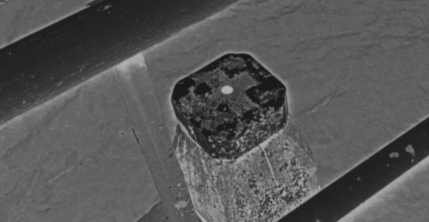

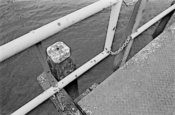

When going through my last pieces of Fomapan 100, I ran into something pretty extreme. I can imagine this being a fairly old-fashioned type of emulsion and therefore probably a little more prone to this sort of thing.
Full 35mm frame (scan)
Zoomed in a little.
From here: https://tinker.koraks.nl/photography/to-a-crisp-an-extreme-example-of-edge-effects/
Pyrocat HD 1+1+100, 12 minutes with an agitation cycle every 3-4 minutes.
Zoomed in a little.
That’s an interesting example. Extreme, indeed. Is this the negative or an inversion? If it’s inverted (positive) it’s even more surprising since it would mean we’re seeing very pronounced “fringe” effects.
It's inverted; scan from negative and then flipped in GIMP. Here's a bit from the same negative:
It's the most extreme example I've had on hand; I'm still not quite sure why it came out this extreme.
I can’t offer an explanation for anything this extreme (beyond the boilerplate film-developer-technique combination) but if nothing else it’s great for illustrating what is meant by edge effects or unsharp masking.
Yeah, that's what I mostly use it for. I had a couple of rolls come out similarly, processed in pyrocat and parodinal. It's nice to have these examples, even if I doubt I'd be able to replicate what happened here.
