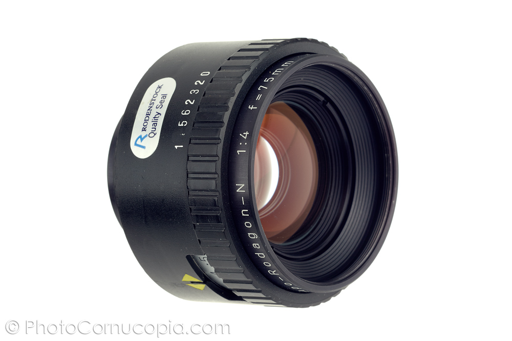

Before buying you should know that there were different versions of the APO-Rodagon. The first APO was the 90/4. You can easily identify it by its huge and protracting rear lens. Nowadays it is the cheapest of the APOs. Then came the 80/4. Then the 80/4 N and 90/4 N. The latter are the most desired versions. I cannot say how big the difference between these versions is. Some people say it´s there, others doubt it. The non-APO Rodagon 80/4 is very good as well...
There's also a Rodenstock Apo-Rodagon-N 4/75 which is a bit hard to find, not that I'm recommending chasing it up or anything. Not really sure why it was ever made as it seems to have only been sold through the machine vision channels and probably not for too long either.

The APO-Rodagon D 4/75 is a 1:1 Duplication/Macro lens and is not the lens I'm talking about. I'm referring to the 'N' variant, ie 'APO-Rodagon-N 4/75' which is corrected for typical enlarging magnifications (2-10) and is quite different to the APO-Rodagon D.
Hi,
that's interesting. In my papers there is only the Apo-Rodagon-N 4/80. Is this something like the 8-element Apo-Rodagon-N 2.8/45 for 35mm? I can't find any mtf data for the 45 or 75, unfortunatally.

The mtf graphs look very similar to the 4/80 Apo-Rodagon-N...
Best
Jens
I have both the 75 and 80 apo-rodagon-N's and at least from my experience, which is to use them as taking lenses on a digital camera, they perform about the same. I'm not sure why a 75 and 80 both exist as they seem very similar. I'm not 100% certain but I think but I think the 80 (c. 1995) predates the 75 (c. 1998).
