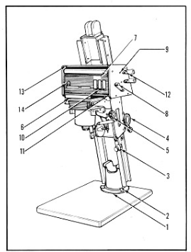

I never had an omega, and probably never will. Only because when I look at them, they look ok, then my eyes look at the column which is okay, then down to the crappy looking base that looks like it was made to support one of those retractable arm table lamps. Do they pivot on that thing? It just doesnt look right.
I do not know what you mean by "then down to the crappy looking base that looks like it was made to support one of those retractable arm table lamps. Do they pivot on that thing? It just doesnt look right." There are no table lamp arms.

Omega baseboards are very solid, and the base of the enlarger clamps down very tightly and reliably for the long haul. Of course, like all tabletop enlargers, it helps to have a wall brace at the top. But you can also reverse the direction of the enlarger in the opposite direction, to make it project over the edge of the baseboard. I did this with a custom cabinet allowed bigger enlargements. Those baseboards aren't like the kind of particle board Ikea furniture is made from. It's good stuff.

That Omega base is quite massive, it is attached to a baseboard that is very solid and substantial and the means of attachment is very rugged and reliable.
If you ever have to move a D5/XL or D6, you will soon realize of what I speak:wink:
