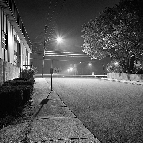

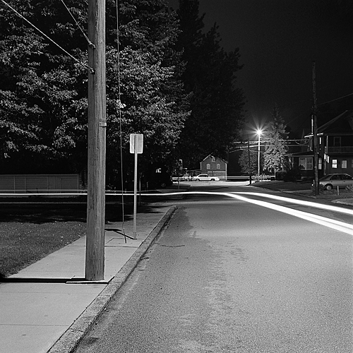

Everyone, here's two scans from a nighttime shoot I did last night. I developed them per Shawn's Rodinal process. Dilution 1:200. One roll of film in tank with one other empty reel. 800ml of developer. Water pre-soak. Agitated first 1.5 min of development, then sit til half way mark, then another 30 sec of agitation. The negatives looked good for a first attempt, although a little thin and with high amounts of fog. Next time I think I'll try reducing exposure a little and agitating two times in 40 minutes instead of once at the halfway point. Film is Neopan 400

Scans look great, Brian! I've never used Fuji B&W film so I'm sure some adjustments will be needed. Looks like you're quite close though.
I have not developed any night exposures for probably a year or so. Since that time I have changed my process to minimal agitation:
Rodinal 5:900 for 40 minutes with agitation at the beginning and then every 10 minutes, this works for me on everything from N, N+1, and N-1. FOR NIGHT WORK I would probably not agitate more than 3 times total and keep dilutions at least 1:150 to keep those crazy highlights down.
Looking forward to seeing more and glad that I could help in some way. Steve Sherman was a big help to me when I first started doing this, while he uses Pyrocat HD he was still able to give me some great advice on the process in general.
