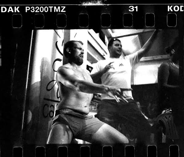

The only developer that makes me enjoy TMZ @ 3200 a lot, is TMax Developer... And apart from a healthier tone than Microphen, Xtol and DD-X, it gives crisp, beautiful, yet controlled grain... The first time for me was wow! And the syrup is sooooo long lasting! That developer was not designed for TMax films, but to push TMZ, some say... I never was able to make Delta3200 that good in any developer. I would use TMZ if I could buy it here! Film has to be very fresh...
