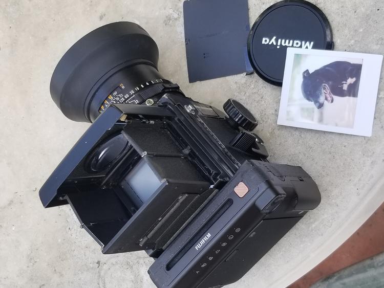

I have that back and love it!!! I feel that the good glass on a Mamiya really makes the Instax shine!!!
