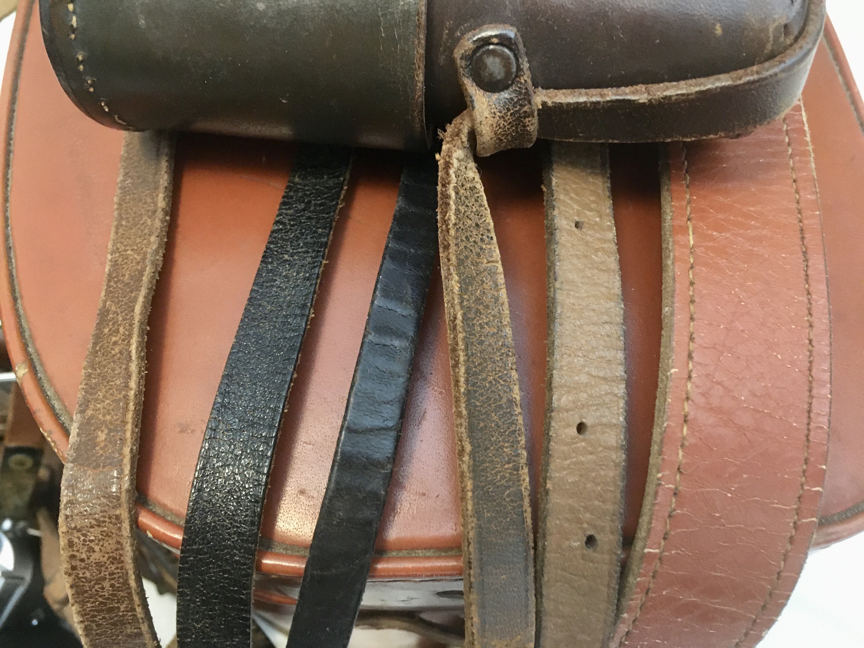

I have a large number of cameras cases and straps, mostly from the 1920s to the 1950s. Is there a product I can use to increase their longevity? Thanks!

My experience with SnoSeal, especially on dry leather that looks like the examples in the photograph, is that it will soak deeply into the leather. You need minor heat to get it to penetrate. After it cools, brush with a shoe brush. The leather will not be slimy or slippery.
