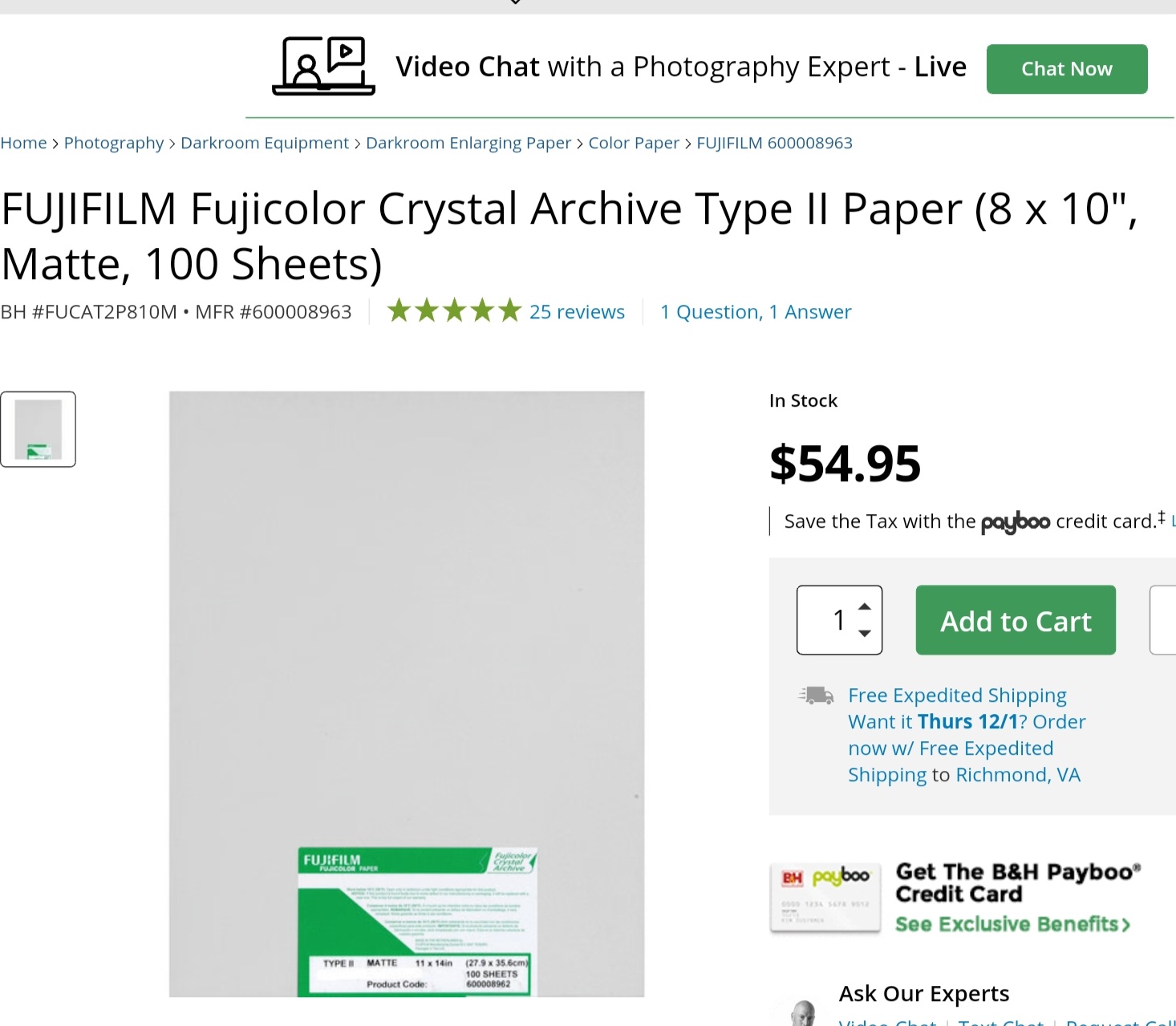

Obviously crystal archive type ii is printable, but I've read vague rumors about this stock being inferior to their other options.
Well, I suppose I'm one of the people rumoring this. In my hands this paper doesn't produce the same solid blacks that the higher-end Fuji papers do, and it's also the thinnest/most flimsy paper base in RA4 country. YMMV though; some find it a fine paper. It does have a moderate color saturation going for it, which is nice if you want something more muted and subtle than other papers.

Thank you for sharing this link! But I'm not sure if the DP II sold on this site is the same thing as the "type II" available in the US. Do you know?
Not the same. European DPII is American Super Type CN or C (Fuji seems to use both designations indistinctly) as metioned before.
I think US Type II is EU Crystal Archive Supreme, standard Crystal Archive with a thicker base.
Supreme is not the same as standard Crystal Archive. I think US type II is Crystal Archive II. Plain Crystal Archive hasn't been manufactured for years; it was superceded by II a decade or so ago. Maybe longer.
Fuji's nomenclature is ridiculously confusing.
