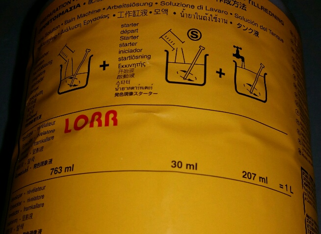

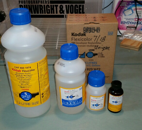

Here's the Developer I get from Unique .The replenisher is 14 usd for 5 liters. The starter is reasonable and 1 bottle will a lifetime.
The close up is the starter bottle to make Developer you take 763mL of the Replenisher (this is the 5 L ), 30 mL of the starter and 207mL of water. Use this developer once and toss if you are using a Jobo . If you are using tanks that use general agitation you use the replenisher to top off the developer
