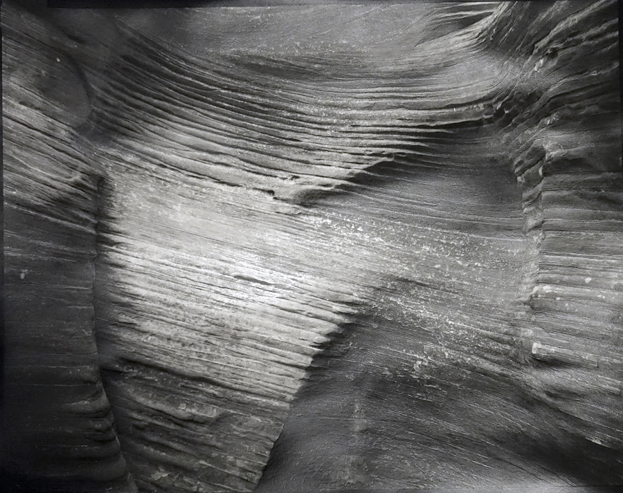

Carbon print from the second negative:

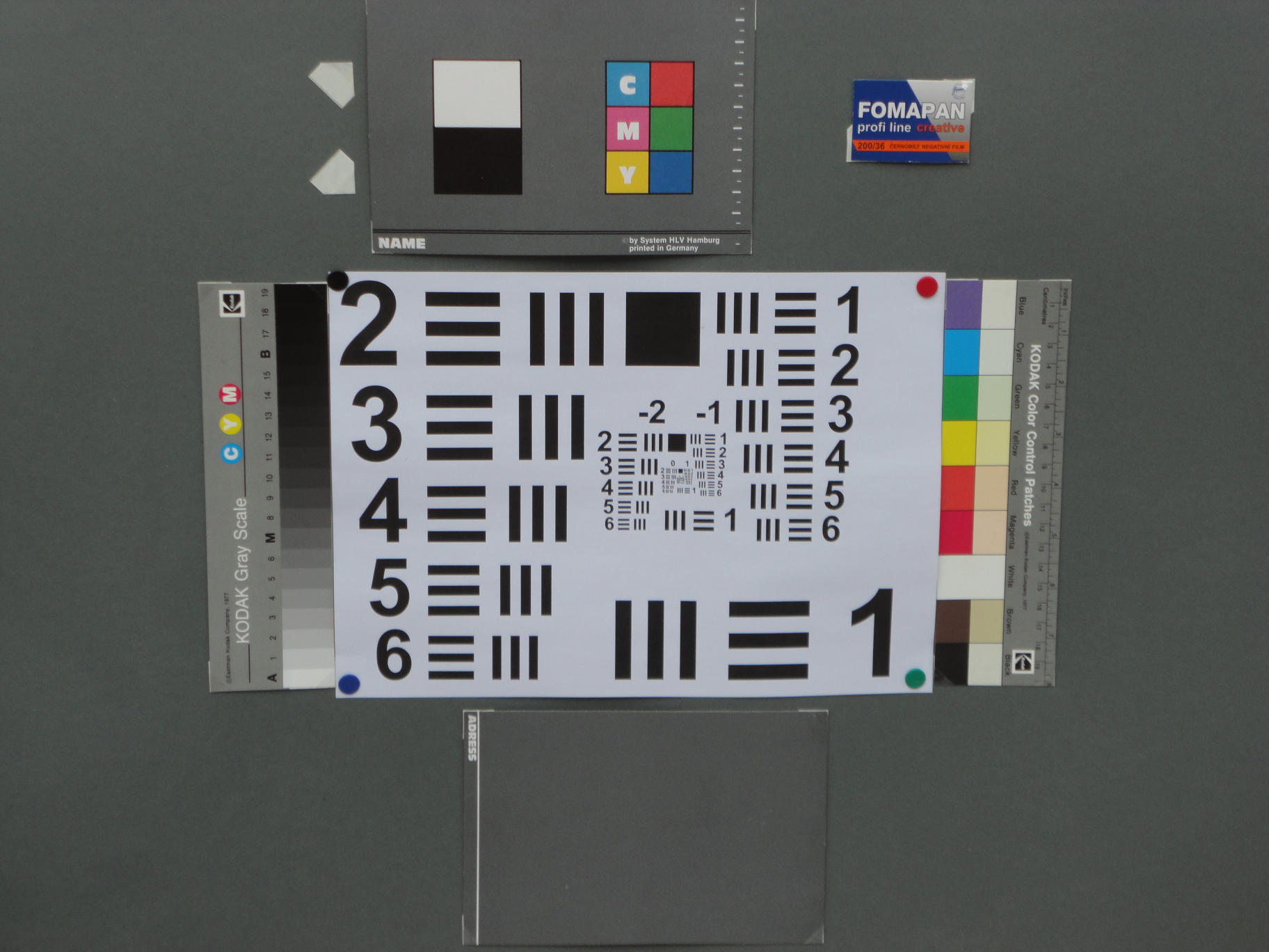

A few years ago I tried to compare the spectral sensitivity. So I shot several films outside on the same day around noon - without filter (Normal), then with Yellow, Green and Red. For sure not very scientific, just my two cents.
Interesting. One type of contrast or effect that colored filters give is differentiation between colors, as most modern pan films are designed to give a flat response. Foma 200 and to a little lesser degree Foma 400 really create a differentiation between RGB and CMY (Foma 400 a little less here). Foma 400 with a green filter is good also.
Did you just shoot that target pictured, or did you derive those densities from some other scene?

I used a target made up of several items on a grayish background, see picture attached. The gray card at the bottom was used for metering. The gray card was then also used as reverence point when enlarging the negatives, trying to get the prints as similar as possible. Later the prints were scanned and on the computer I only cut out the upper part you saw in the pdf file for easy comparison.
