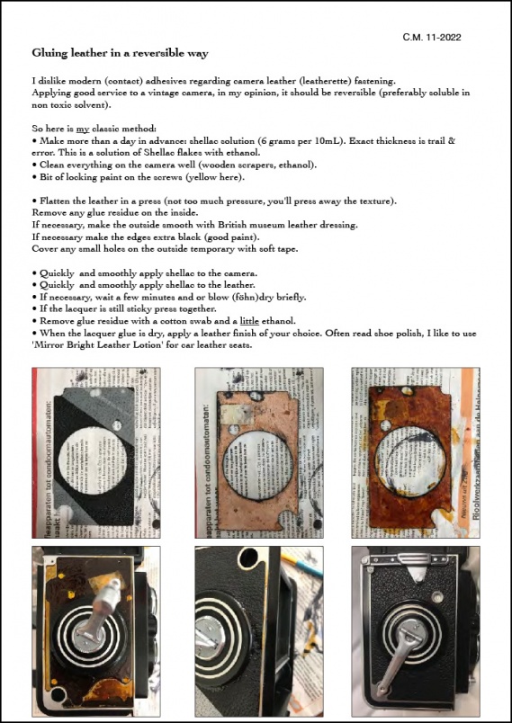

I use flake shellac in methylated spirits.
I made a test glueing pieces of leather to an aluminium angle using shellac, PVA and contact cement. Shellac was my favourite both for strength and ease of use. Prepare as described above. Best quality flakes are available from specialized woodworking shops. I used ethanol as a solvent. The only downside is that ethanol can shrink leather but since you are glueing vinyl it is not a problem.

Shellac even hundreds of years old can be removed. You just need a decent grade of alcohol. Ordinary drugstore and hardware or paint store alcohol is watered down. Of course, in this case, you'd allow the alcohol to seep in at the edges of the camera vinyl or leatherette, and gently proceed, and not try to pull it off all at once.
Shellac has also been used as a hot-melt adhesive. Iron-on clothing patches were based on shellac. Early print drymounting tissues used shellac.

I make my own by dissolving shellac flakes in denatured alcohol. However, good ventilation and nitrile gloves (and eye protection, of course) are mandatory. Ingesting the fumes or absorbing denaturing agents via skin absorption is a not good thing.

Yes, buy flakes and dissolve in IsoPropyl Alcohol.
There was a guide on how to safely apply leatherette so that it can be removed in French

I've mentioned this before but Shellac is pretty safe stuff, I mix my flakes with ethanol, in this case "Everclear" liquor about 95%, which is often used to make extracts of Vanilla, Almond, Orange, etc and shellac is edible, used for example for an outer coating for some candies.
It's what is used on old and new fountain pens to glue up a new ink sac, latex or silicone to the nib holding end of the pen.
I use ethanol instead of denatured alcohol because, other than alcohol poisoning, it's safer to have mixed up for use, especially if kids get into it.
I use a low volume of Orange shellac flakes in Everclear, for a three pound cut of only a few ounces of finished product, as needed.
The mixed shellac can be diluted by more alcohol, to drop to a two or one pound cut.
Keep your jar of shellac flakes in a tightly shut Mason jar, stored cool and out of direct sunlight.

shellac in isopropanol is great to glue real leather (the thin Morocco/Saffian like on pre-war Rolleiflexes) onto the camera. Here you can get it in art supplies, I use a quite concentrated solution, it flows similar to honey.
