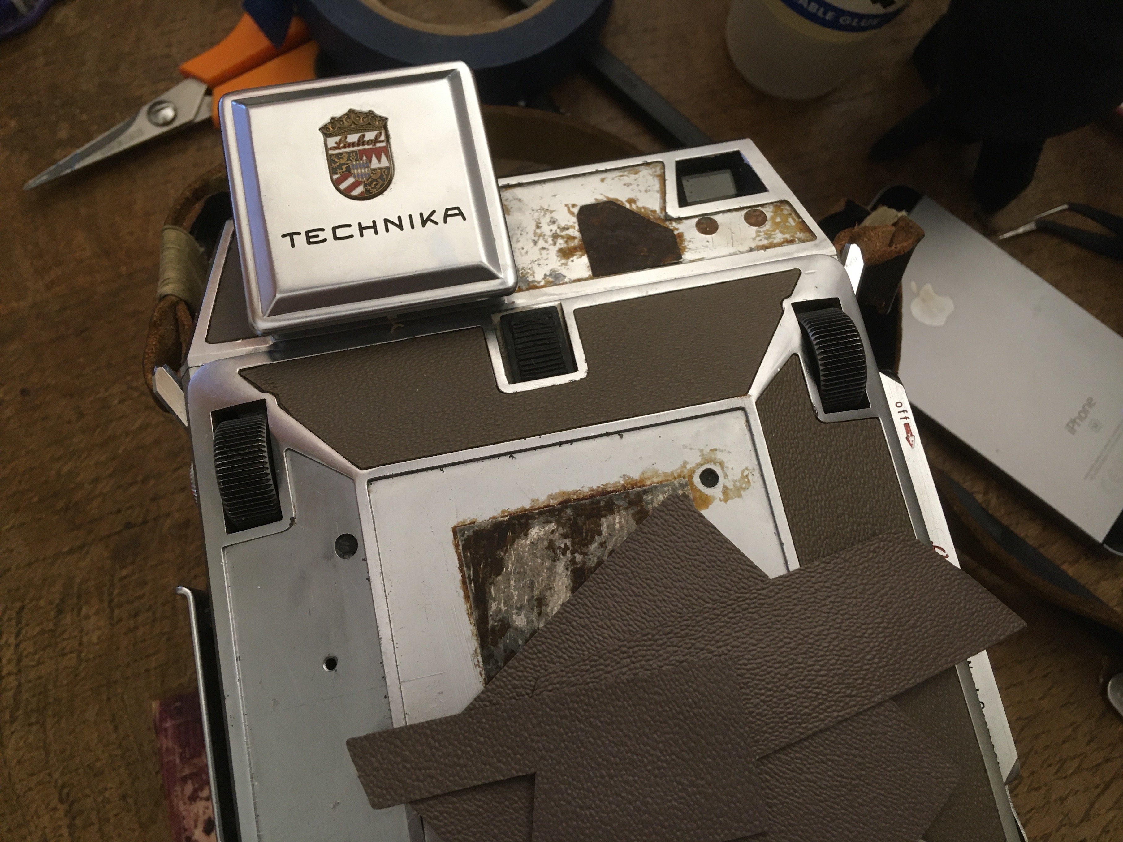

Some of the vinyl came off my Linhof Technika, and I wondered what the best adhesive for glueing it back down would be.
I actually tried a contact adhesive but I found it impossible to spread it perfectly evenly, and after glueing the surface of the vinyl looked uneven/lumpy. Perhaps a double sided tape would work betteer? Thanks!

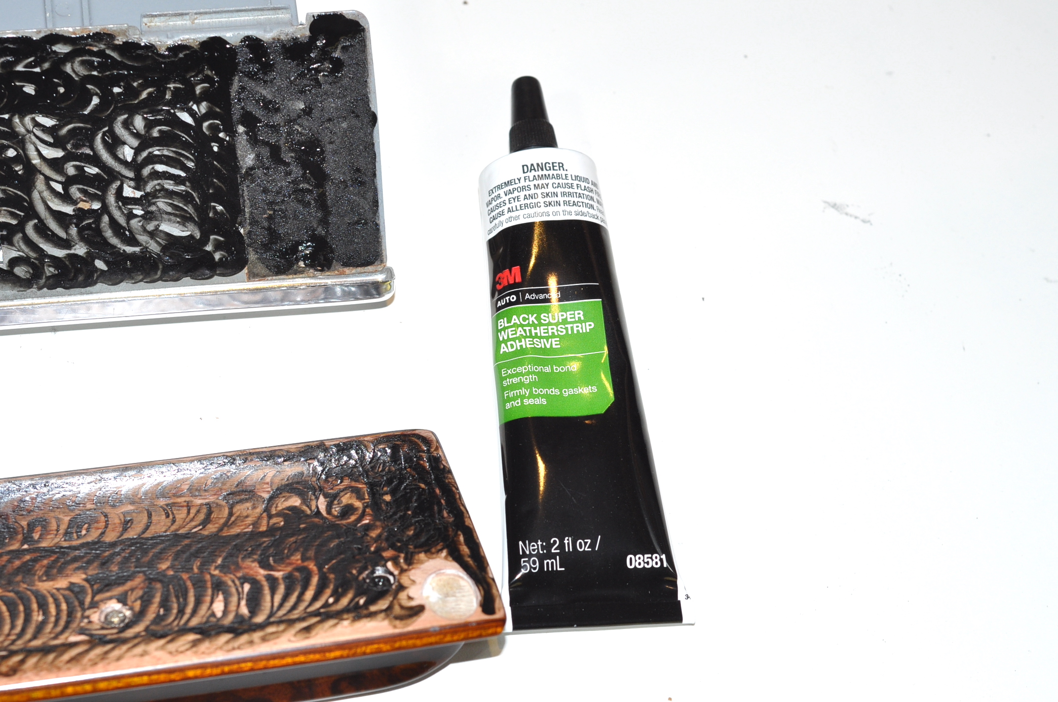

Not all contact adhesives are the same. I also sometimes struggle with thick adhesive that leaves unfavorable results. For the last few years I have been using this 3M product that goes on thin and is black.
There are also spray adhesives that go on thin too.

Looks good, I guess the contact adhesive I used was just too thick
