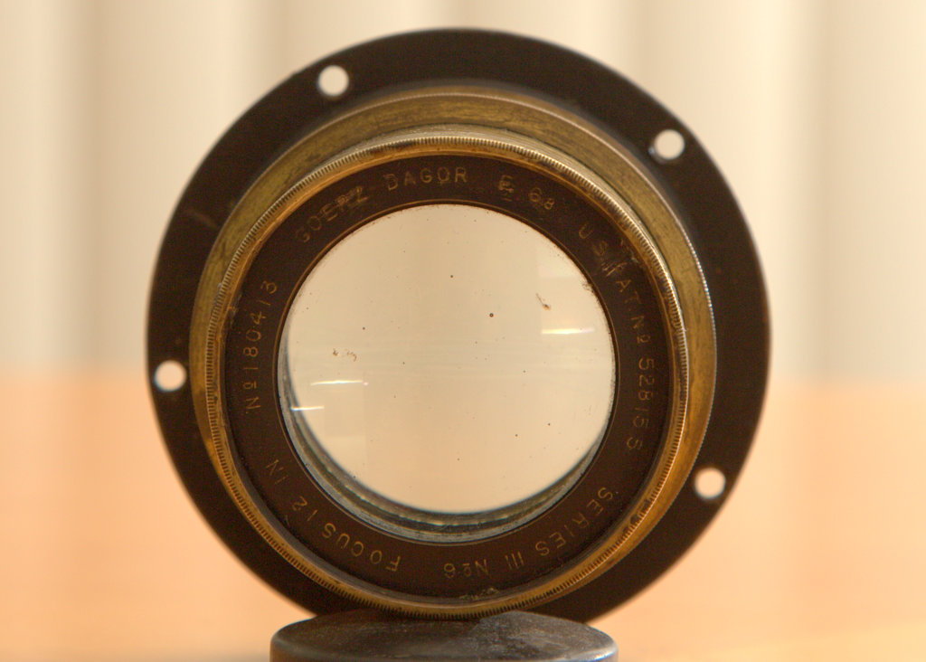

Anyone have info or know how good this lens is? No aperture blades and some nicks/scratches on front element.
