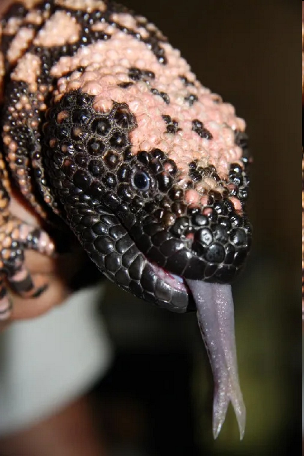

I'll leave it to the OP to decide if Gila Monsters will be on the table top. Their beads are beautiful at 1:1.
Oh my! Send that poor reptile to the dermatologist! - or else is will never get invited to the Prom.
