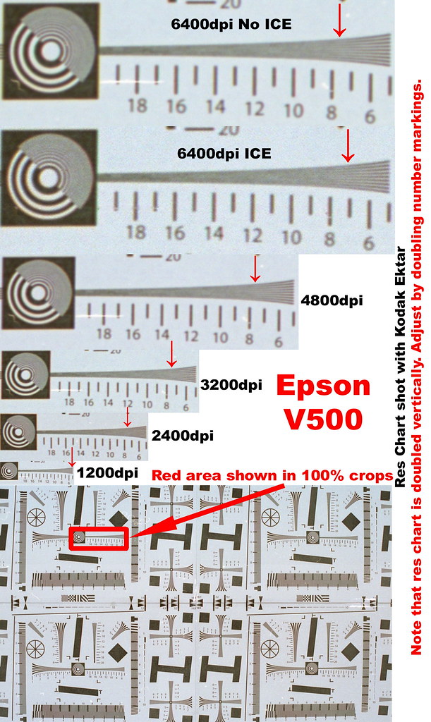

I only had an Epson V500 and not the V600 so it might be similar. On Kodak Ektar 100, it doesn't appear to get much above 2400dpi setting which goes with what you understand it to be.
Kodak Ektar 100_12-05 V500 by Les DMess, on Flickr

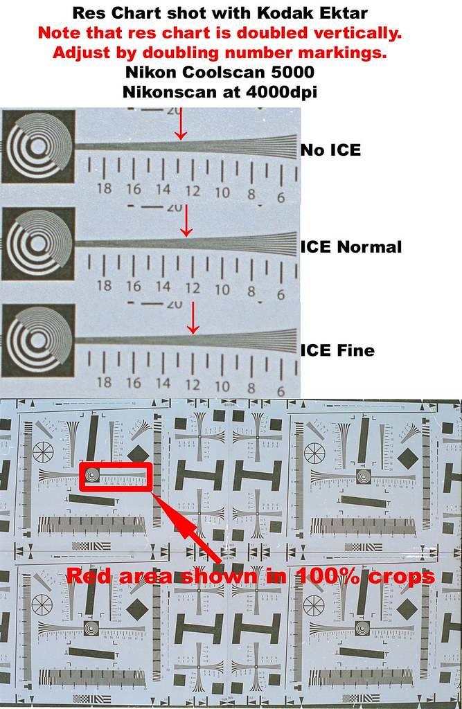

This is the same Kodak Ektar 100 using a Coolscan at 4000dpi and may not be too disimilar to the Plustek.
Kodak Ektar 100_12-05 CS5000 by Les DMess, on Flickr

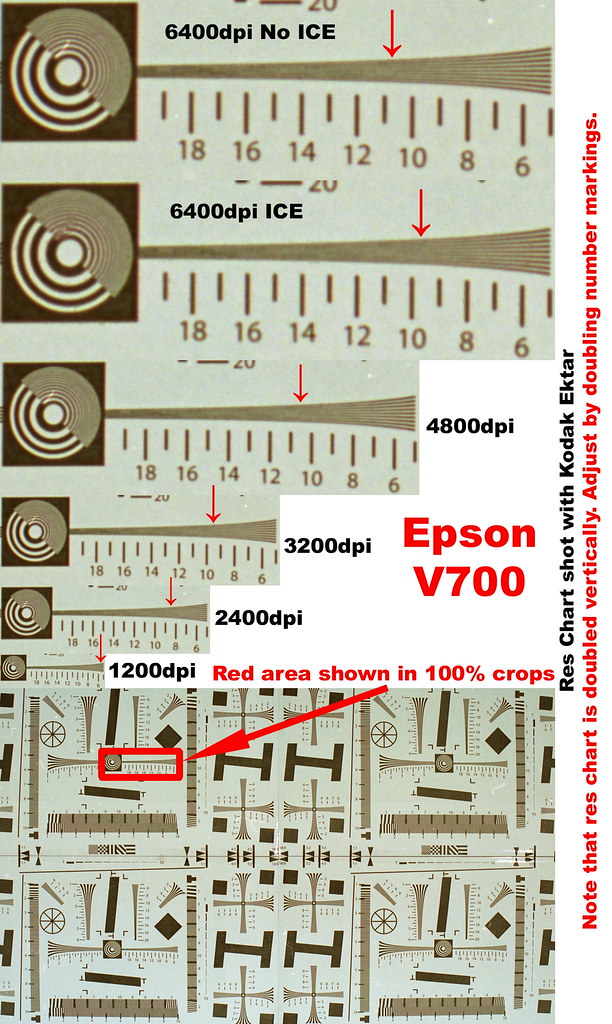

Same Ektar 100 on Epson V700 and maxes out at 4800dpi. Notice the difference between Epson 4800dpi and Coolscan 4000dpi in terms of sharpness and actual detail achieved even with ICE turned on.
Kodak Ektar 100_12-05 V700 by Les DMess, on Flickr
