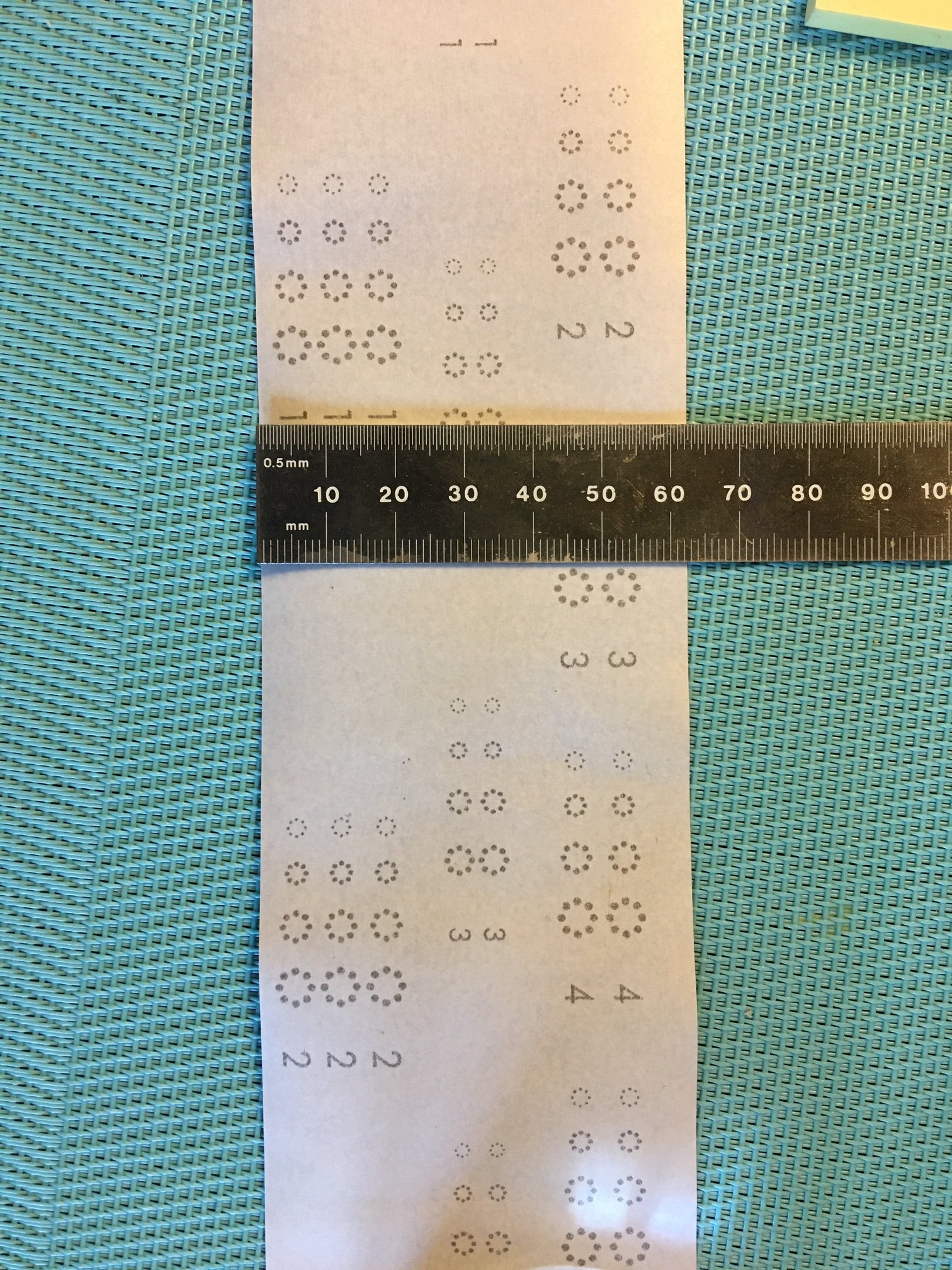

I looked at some pretty recent (last year) rolls:
Acros (not II) has three tracks for 6x9, but only the outer one has the warning circles (the other two just have numbers
Tmax100 has three tracks for 6x9
TriX has three tracks for 6x9
Ilford seems to use the same backing paper for all rolls because the paper doesn't list the emulsion (unless I'm looking at the wrong paper.) and it shows three tracks for the 6x9.
EDIT: sorry, now I think that the unlabeled roll wasn't Ilford, but Bergger Pancro.

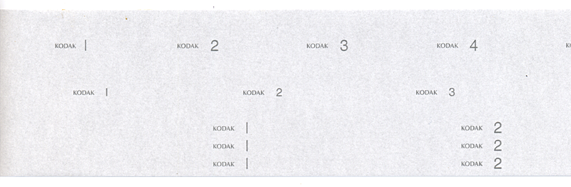

Feeling a bit frustrated reading all this as the perpetrator of some scans in the earlier thread. A combination of having over-bought for two trips and being deeply entangled in some heavy remodeling -- and now Covid-19 shutdowns -- I have no very recent purchases and relatively few uses to enable me to add any useful contribution here. I do recall in the earlier thread there were indications that The Great Yellow Father might address the problem, but can't say I've heard anything since. I have no recent Tmax in 120. The last roll of 400TX backing paper I have laying about the darkroom is a shiny, plasticky looking stuff, but I have no confident info on its dating. (I'm thinking there used to be an emulsion number stamped {not printed} along the edge of the film toward the end, but my aging bleary eyes aren't picking it up on the last 400TX negatives.) I "think" it was shot last year on a Rhine cruise and given the cost of that little trek, it's likely that to be safe I used my more recently acquired stock which had expirations of 11/20 (Emuls. #1001 011) and 05/21 (Emuls. #1001 013) -- but I can't prove it. :unsure:
In any event, here's a snip and there are indeed 3 rows of numbers on the 6x9 track. But all this monkey business has been a moving target to say the least.
