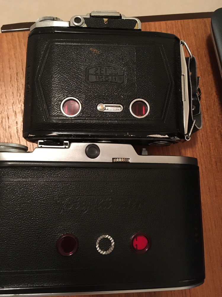

I need help. I just loaded my first roll into my new Voigtlander Bessa I 6x9 and I plan to take it out for its maiden voyage tomorrow. Notice the 1s in the lower right red window (it seems Acros gives no warning that the number is coming). In the Ikonta 6x45, when the number is in the right window, the edge of the film that will be exposed is within the left window. But on the 6x9 Bessa, the edge of the exposure area is another couple of centimeters to the left.
Is there enough film to the left of the window that the first exposure will get a full 6x9 shot??
BTW, the left window on the Voigtlander is blocked so there is no visibility to the film backing paper there.

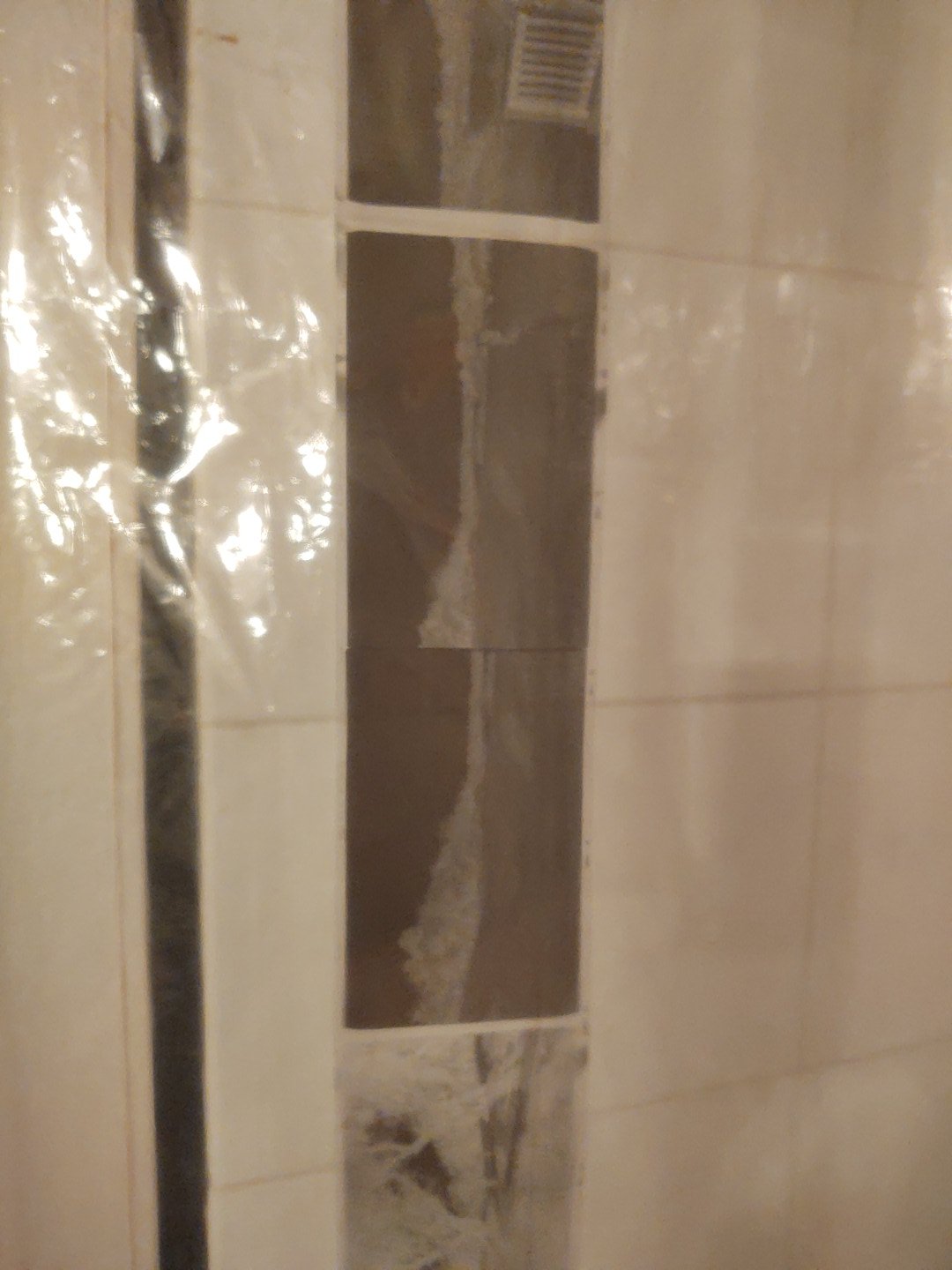

Just expect to have a little overlap on that frame. No biggie. Lots of real estate left on a 6x9 negative.
-I have a roll from another Bessa drying right now. Frame #4 I advanced a bit too fast and have the same thing.

The second window is probably for use when using a mask to shoot 6X4.5.

Oh the left red window only opens if you have the mask inserted.. there is a little nubbin on it that engages something.

The frame spacing using the red window is very narrow. The bottom space in this is the normal gap. The top is my mistake.
Both of these are correct. In fact, you're only a couple millimeters past where you should be; if you remember to wind about half that much too far on frame 2, by frame 3 you should be back to centering the numbers in the window. Or, you could just wind each frame for the rest of this roll the same amount past -- there's plenty of blank tail on 120 with 6x9 (a couple inches).
That auto-block for the second red window is a nice feature that I've never seen on a lesser dual format folder. The only one I 've owned that I have the mask for is a Welta, and you're completely on your own to a) remember you're shooting 6x4.5, or b) remember you're not shooting 6x4.5, as well as c) use the correct framing lines in the glassless frame viewfinder.
Simple answer to your question: Yes, there is enough film to the left of the window so that the first exposure will be a full 6x9 frame.
