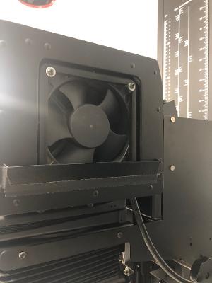

Ok so I stupidly pulled the fan from the Universal 45 head without checking flow direction . Can someone please confirm if flow direction is left or right facing unit.
Fan operates counter clockwise.
The electronic feedback system can overheat if there isn't compete fan efficiency. I think it would be best to add a supplementary pull fan device taking hot air clear out of the room. After all, there are three 250W halogens all packed into a single tight space. I never like to operate these on a warm day. I might try putting a leakproof ice pack atop the head one of these days, just to see if there is less risk of a tantrum. Anytime engineers try to pack just too much into a relatively compact space, there's more complication. It isn't unique to this particular colorhead, but several expensive types with a surplus of bells n' whistles. It's been an especially cool season here, so I've only had one brief tantrum the past three months, with the loss of only a single sheet of paper.

The lightbox to me looks adequately ventilated. Just pull the TOP cover to clean dust out. Do not remove the fan screws until you look at how fan is mounted. Its a weird setup with heavy metal brackets which fall free. I think they are light seal.
