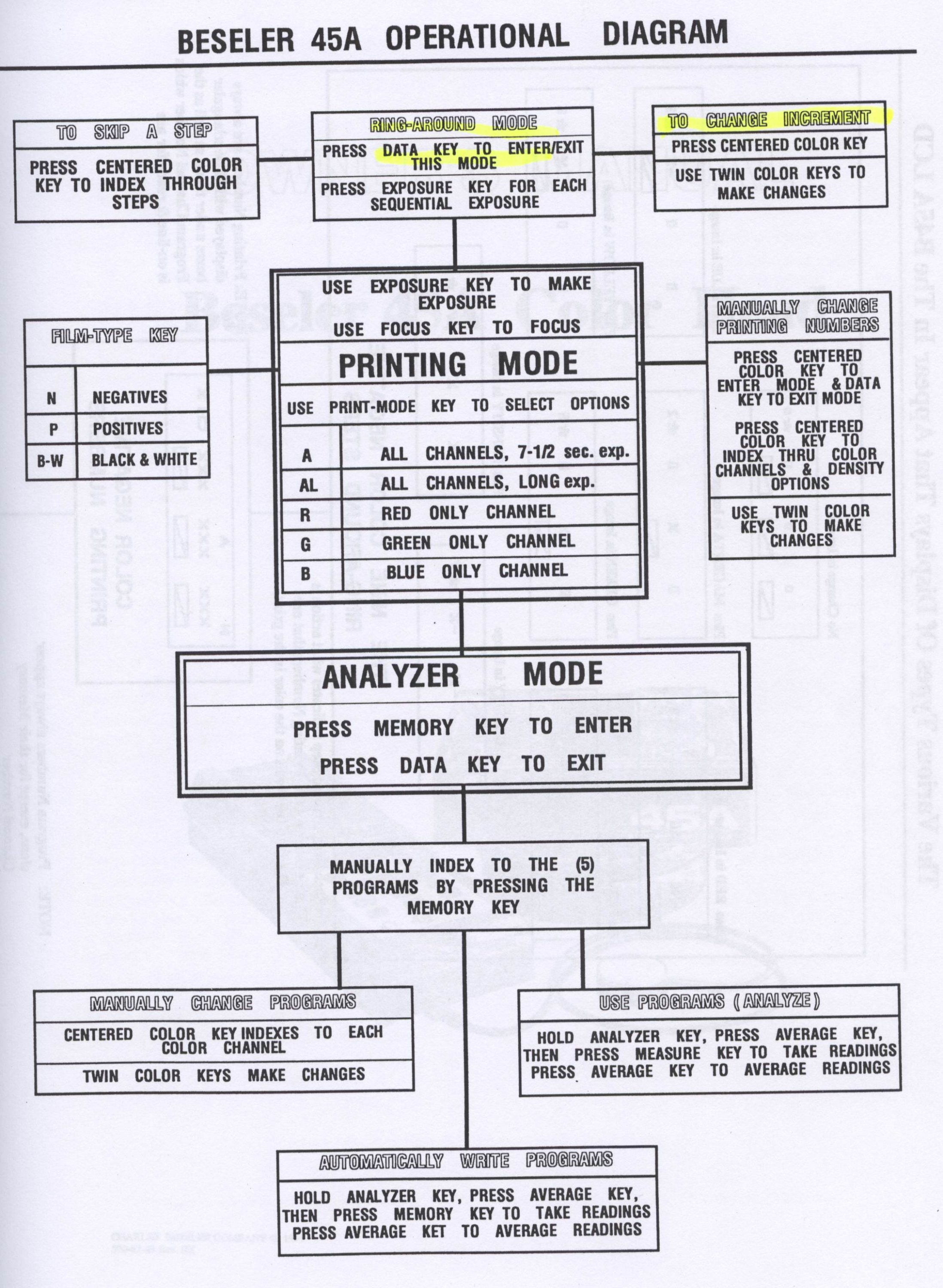

However, something to review:

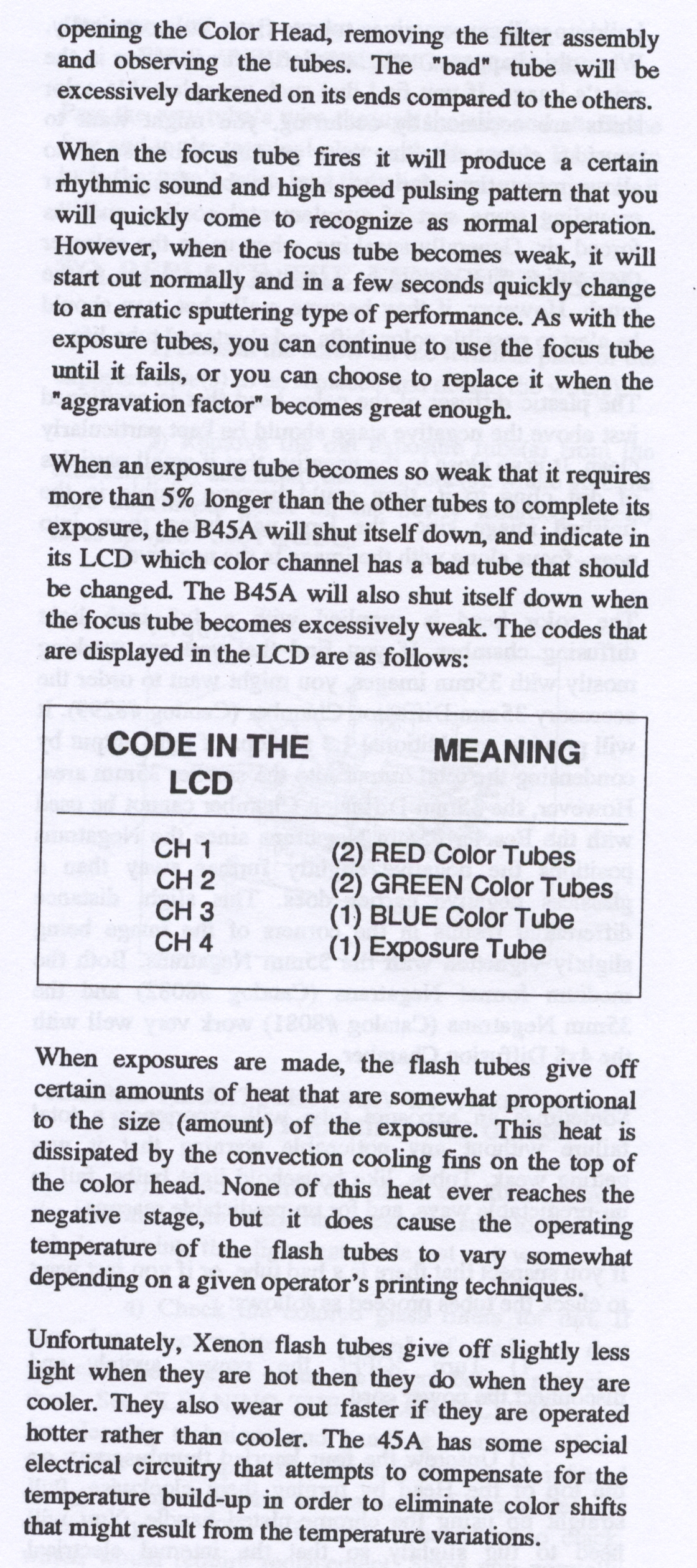

That was my initial thoughts but the manual excerpt posted by sasah zib points to a temperamental system, e.g. "the B45A will shut itself down". The full manual can be found here https://www.photrio.com/forum/threads/besler-minolta-45a-manual.163508/. It would probably wiser to use an LED system instead (diy, Intrepid, or Heiland) to get the same benefits without the maintenance factor.

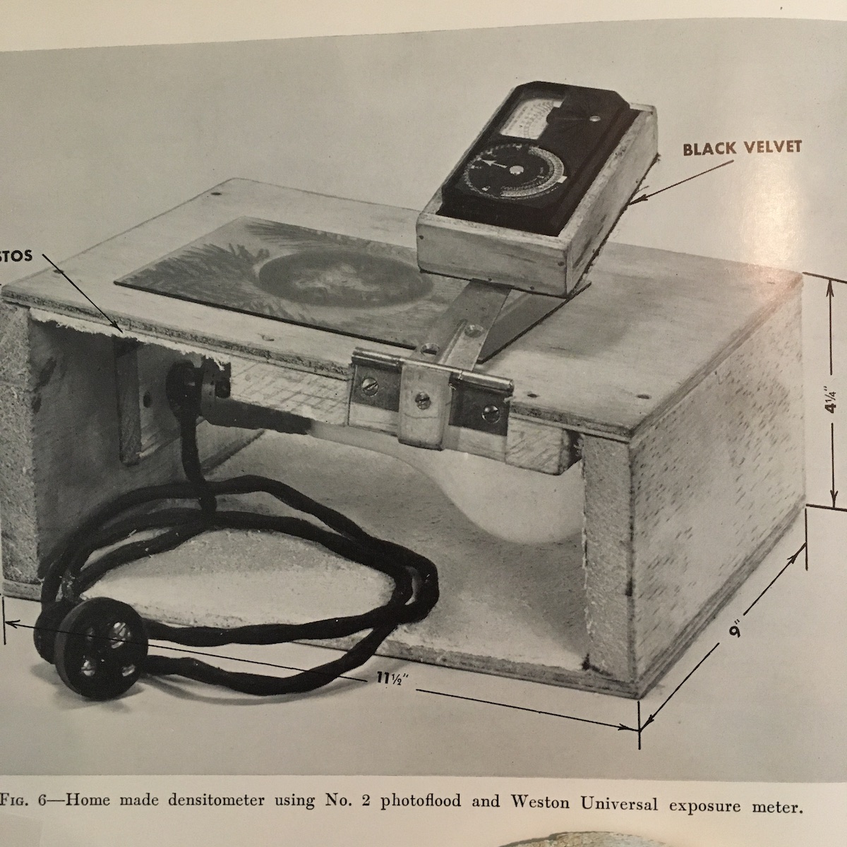

Paul Outerbridge used this as type of equipment:paulo_8487.JPG
His emphasis was on picture driving process. That meter was also his studio meter.
