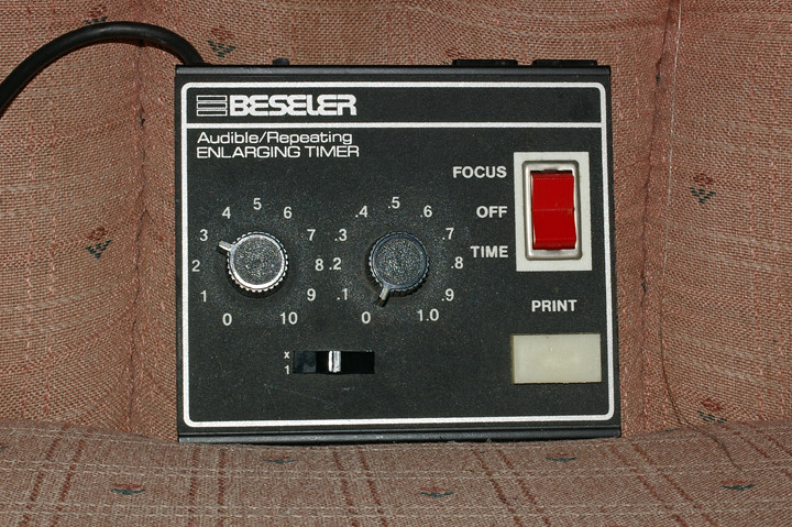

I have a Beseler Audible/Repeating Englarging Timer that is slightly off. If I set it to 20 seconds, I check it against a good stop watch and it only runs about 17 seconds. The audible beeps seem to be correct though. In any event, I took the back panel off and there are what look to be 3 variable resistors labeled R7, R10 and R20. I take it that I can adjust this device moving these a bit. Before I just randomly start fiddling with this, does anyone know which one would help my timing problem?
As I don't see a model number on this, I will describe it. It is a basically rectangular black box, about 6.5 x 6 x 2 inches, 2 big dials for seconds and tenths of seconds, a 10x multiplying switch, red focus off time switch and rectangular print button. A pretty standard unit a few years ago.

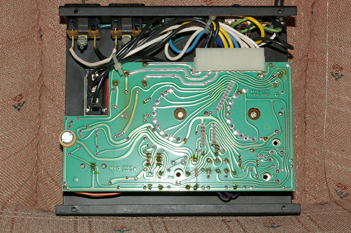

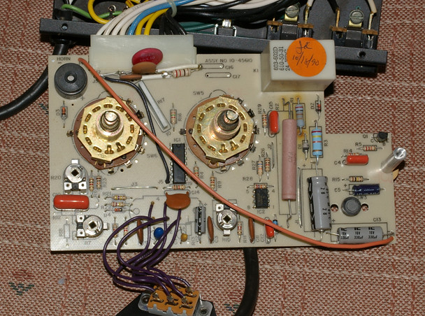

Okay, here are some pictures!
The front:
Opening the back where you will notice that they made the circuit board so that these variable resistors (that is what I am calling them, I may be wrong) are easy to access as there is a hole in the board at each of these points. They are located in the lower middle, lower right corner and above that corner:
And then finally, the front side of the circuit board (you will notice R20 the mid left side, R7 below that in the lower left corner and R10 in the middle of the bottom edge.
Any ideas?
Dave

Looks like an RC timing circuit to me...
Do you see any numbers on those two IC chips? I'm guessing one of them is 555 or 556.... the other one may be 723. I'd really have to trace the circuit and draw it out before I can be 100% certain.

Thanks for the pictures. I see two ICs. Perhaps IC2 is a 555 chip?
WILD, PARTIALLY EDUCATED GUESS: one trimpot each for high and low ranges and a second trimpot to affect linearity.
If it were mine, I'd mark each trimpot as to where it is now and then see what each one does.
Since it is probably not quartz regulated, I'd be happy to be within 5 seconds at one minute.

I was guessing, one is for 10x multiplier switch, one is for 0.1 second min, the other is for 11.0 sec max.... As ic-racer says, linearity may be an issue... in which case, it will never be right at all setting.

The IC is labled NE556N so you guys know what you are speaking about.
If I trace the circuit board, the one wire from the 10x switch is directly connected to R7, one prong of R20 is directly wired to the 1 second switch, and R10 is well, not connected directly to the .1 second switch, but to some other resistors and capacitors. Would you start with R20 that is connected to the 1 second switch? I am assuming these things rotate without harm, correct?

Huh? Both are 555 derivatives? Both 555 and 556 are RC based timer circuit chips. The difference is, 555 has one timer, 556 has two timers both of which are identical to one 555. This is weird.
You *can* rotate them, but it will change the timing and probably for worse. Don't do that yet.
IC-RACER, can you think of a reason why a design like this would use THREE 555s? What the heck?

The two timing adjustments are R7 and R10: one is for the x1 range and the other for the x10. I can't tell which is which from the photos supplied, but you will see one pot is connected to each side of the range switch. I take it it works OK on x1 but not on x10.
The remaining pot is probably for adjusting the 1 second beep period.
The reason for 3 timers: one is for timing exposure; the second for timing the one second beep period; and the third for generating the beep tone.
The circuit design is a train-wreck. There is no transformer to generate the 12 volts (or so) that the timer circuitry works on. The 120VAC is connected to a large power dropping resistor (you can see where the circuit board has been discolored by heat from the heat of the transistor. As the circuit is directly connected to the AC line you can get a 120V shock from contact with the circuit parts. When you get shocked there is also a very good chance of blowing out the 555/6 timers. If you are going to adjust timing with the timer working then adjust the trimpots with a plastic or wooden tool - something like a Popsicle stick that has been whittled down to a square point.
555's are very linear - adjusting the basic timing will have little to no effect on linearity (assuming the circuitry has been designed properly [possibly a bad assumption]). Linearity is set by the accuracy of the resistors connected to the two time adjustment switches.

Thanks everyone for your help. To complete this thread I can confirm the following:
R10 adjusts the 1x time (clockwise increases time)
R7 adjusts 10x time (clockwise increases time)
R20 adjusts audio beep increments (clockwise increases time in between the beeps)
You have to be careful, but I am quite satisfied with the accuracy. I just used a phillips head screwdriver for adjustments.
