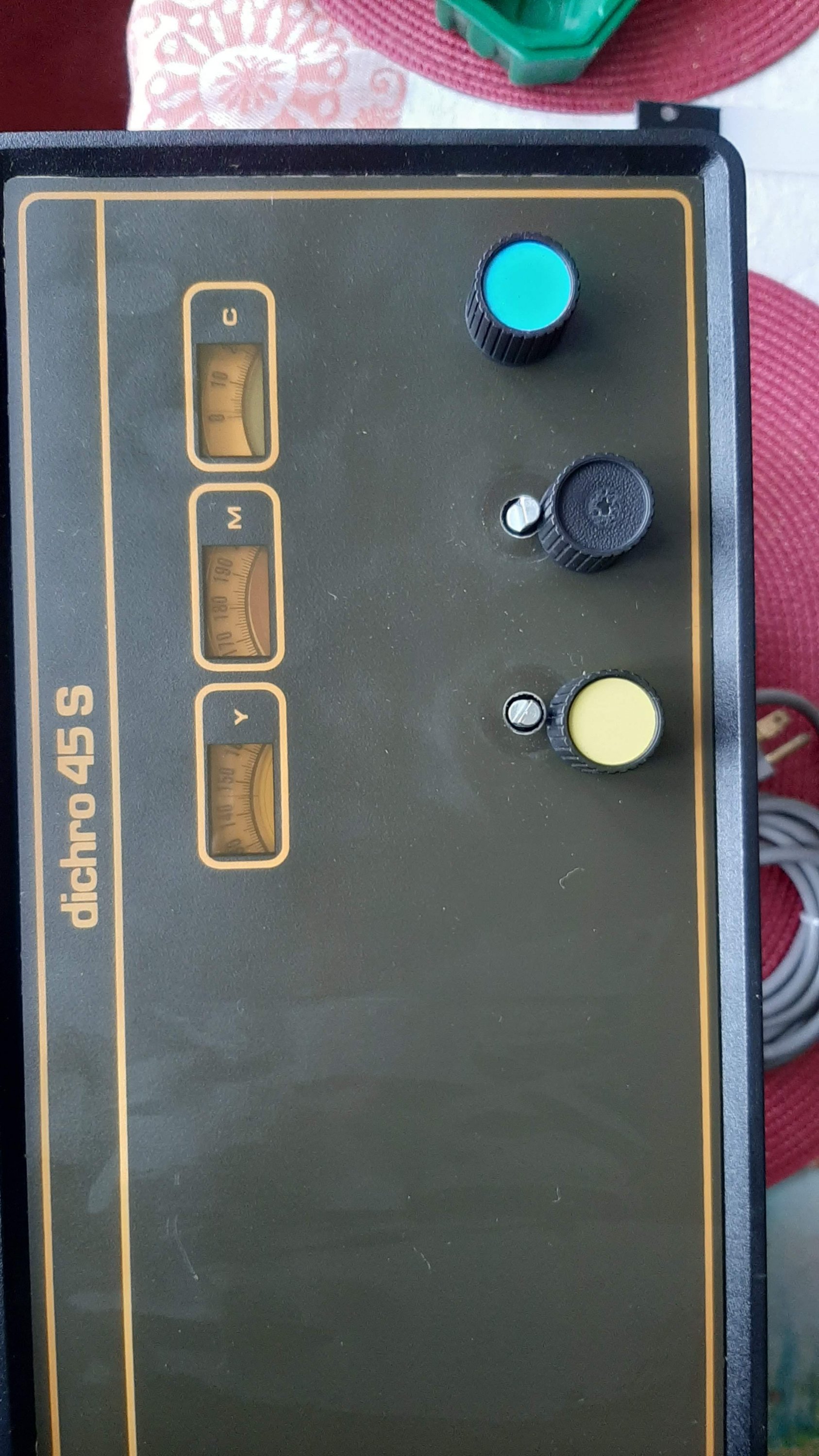

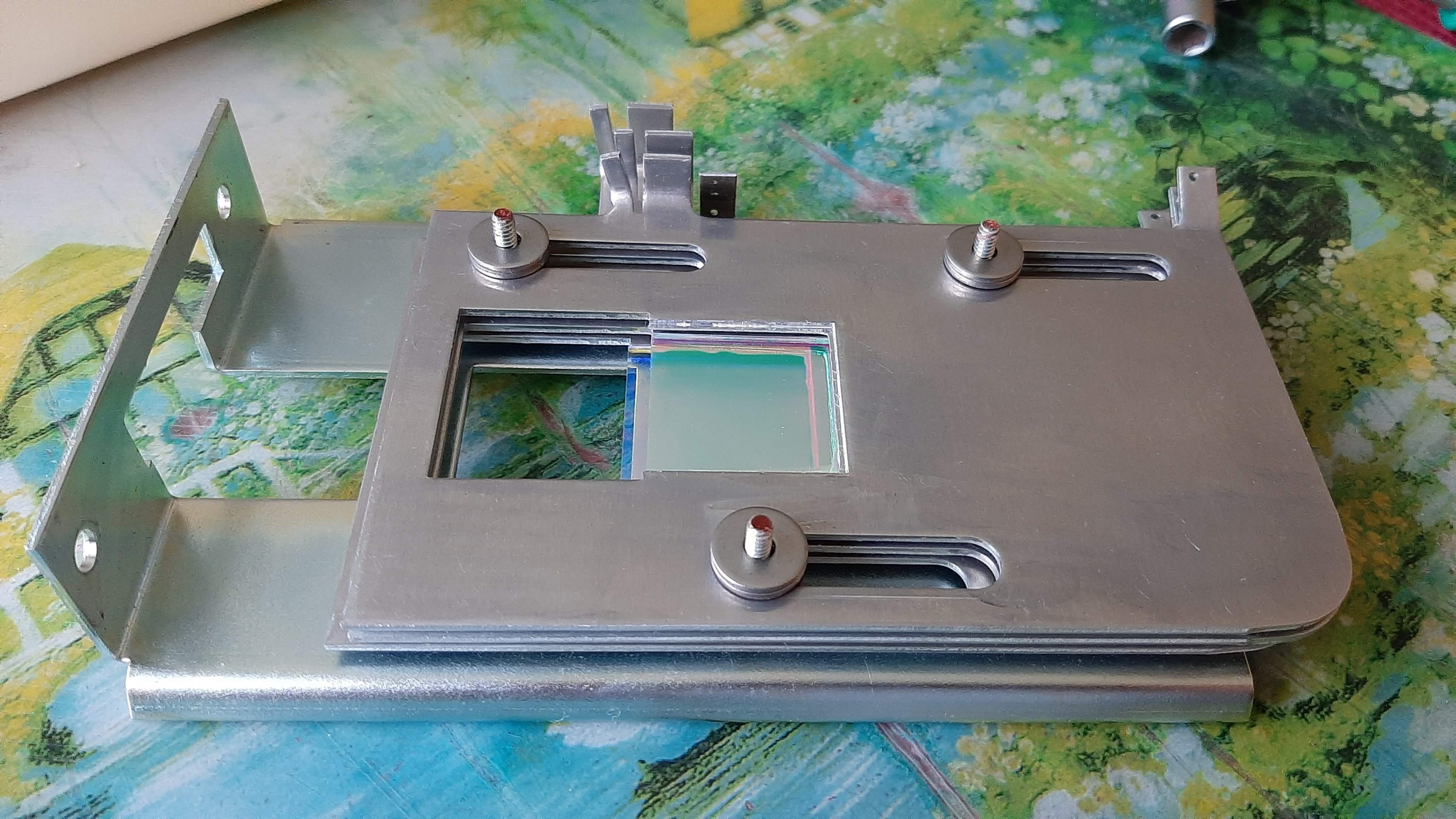

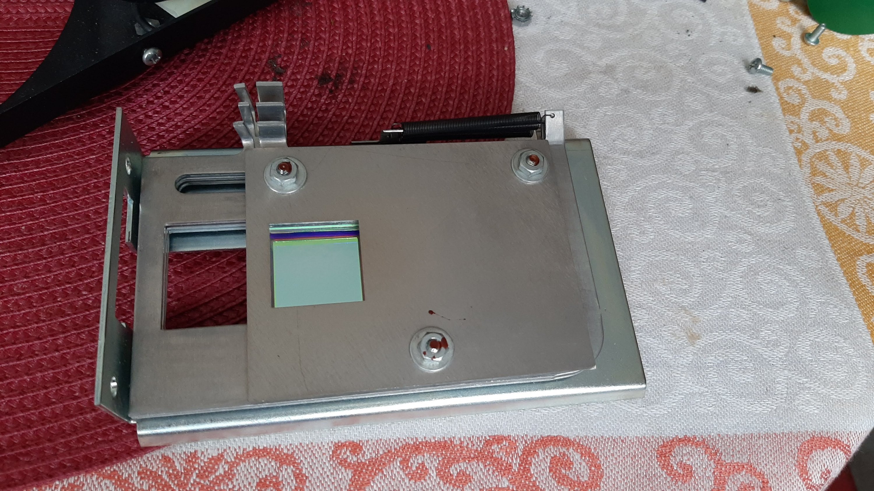

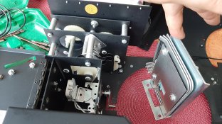

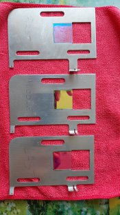

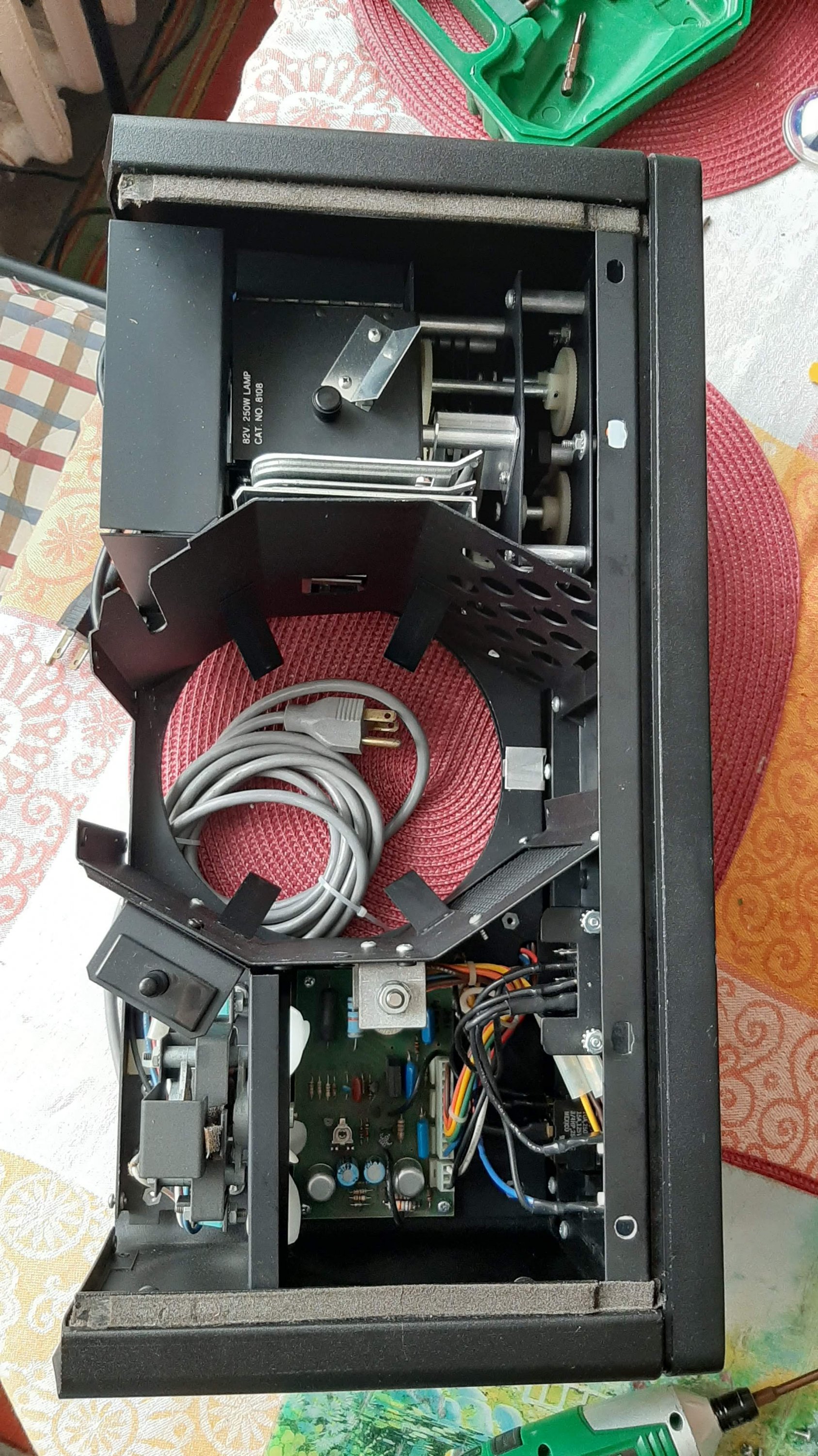

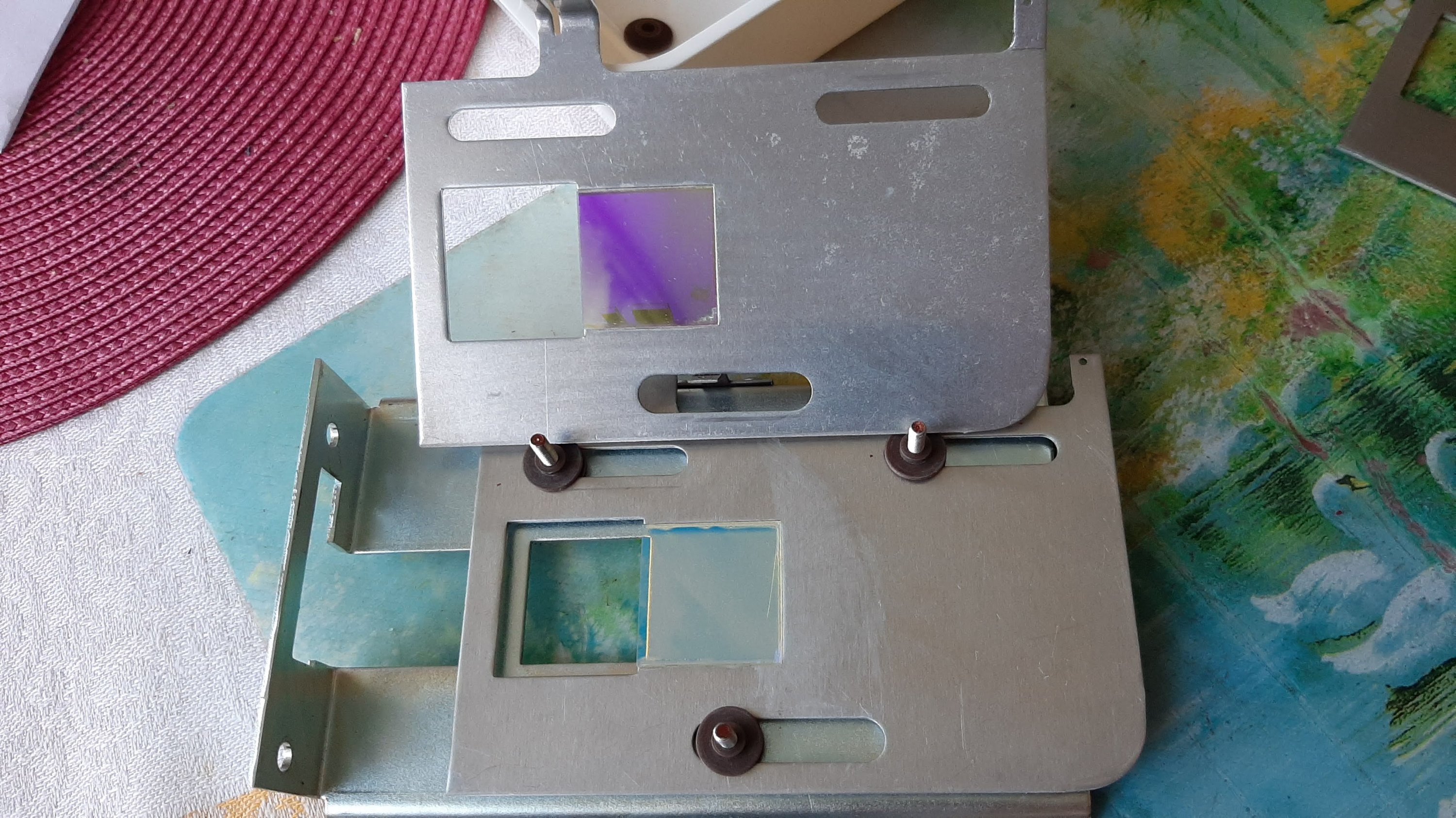

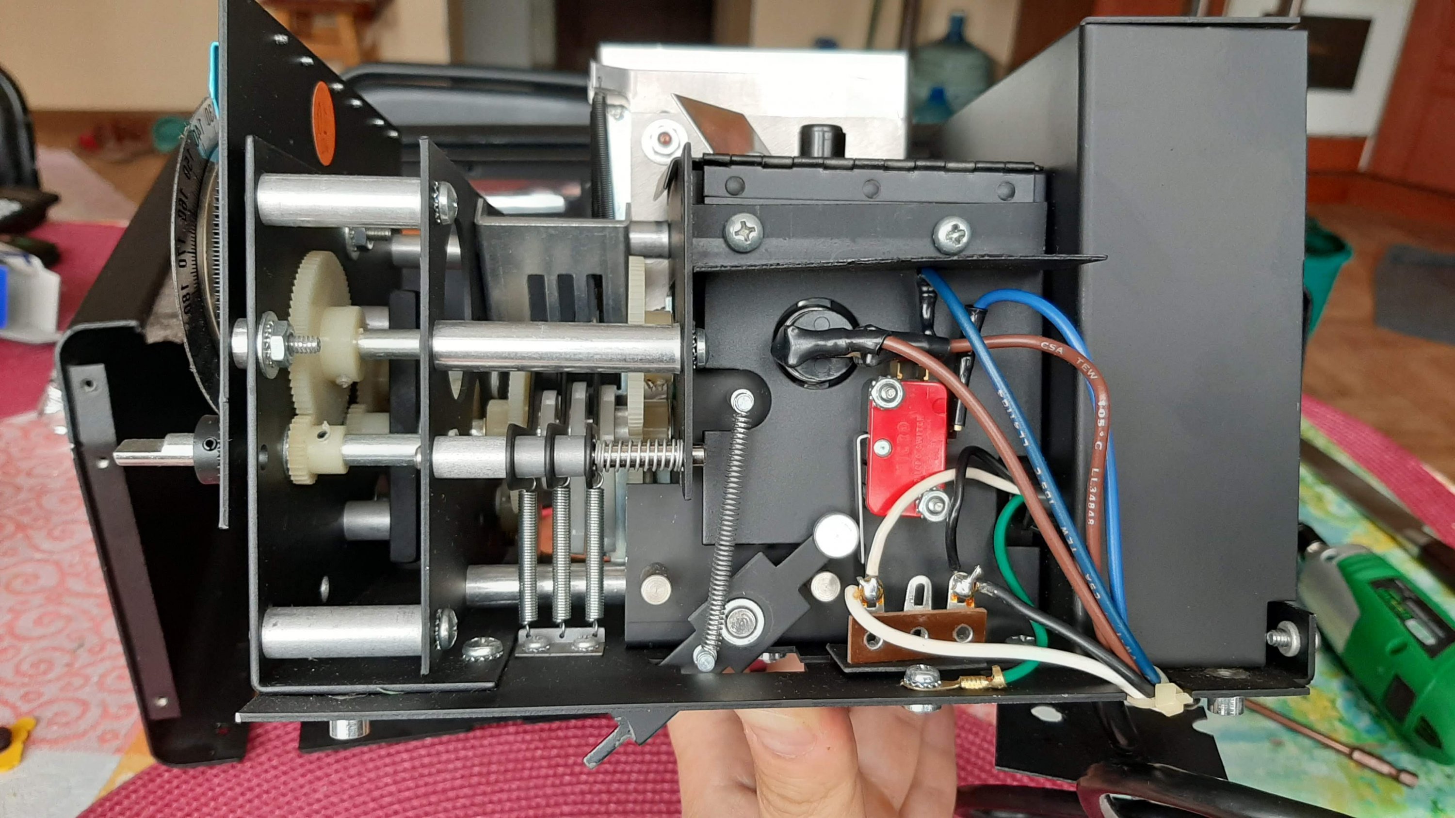

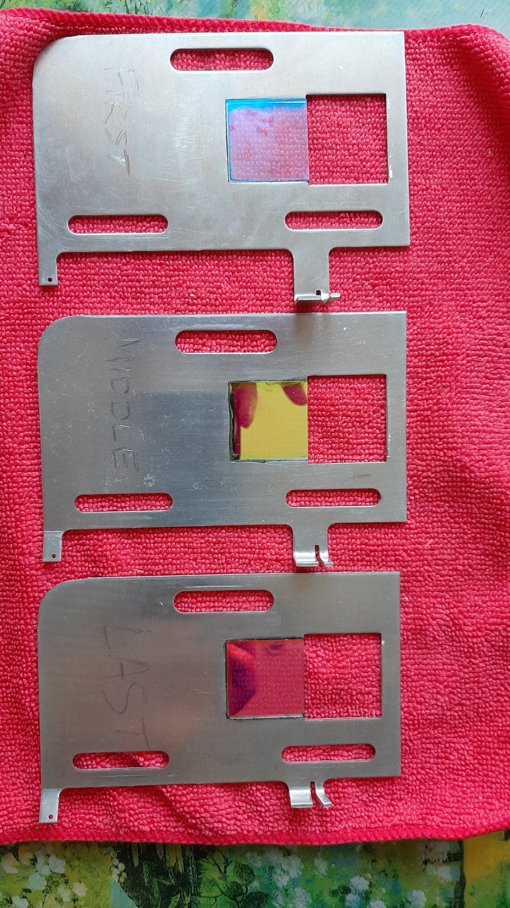

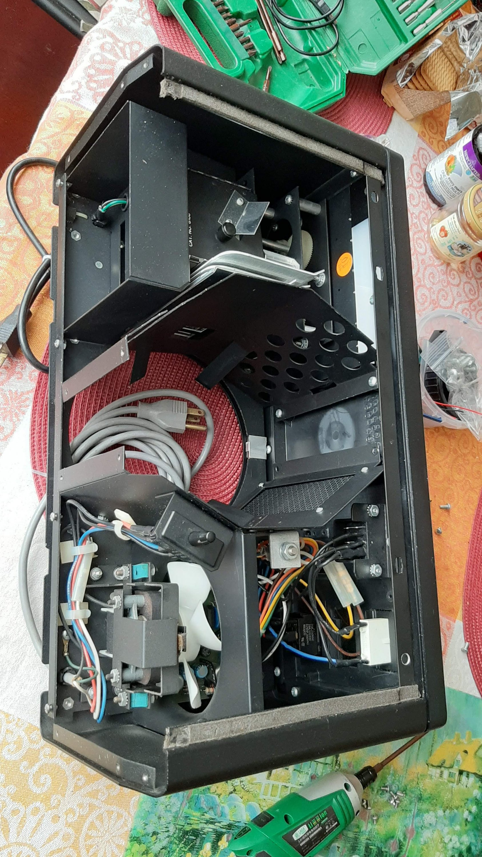

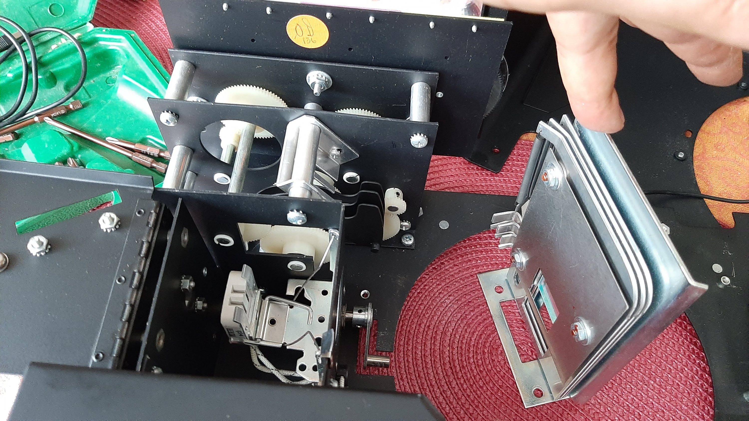

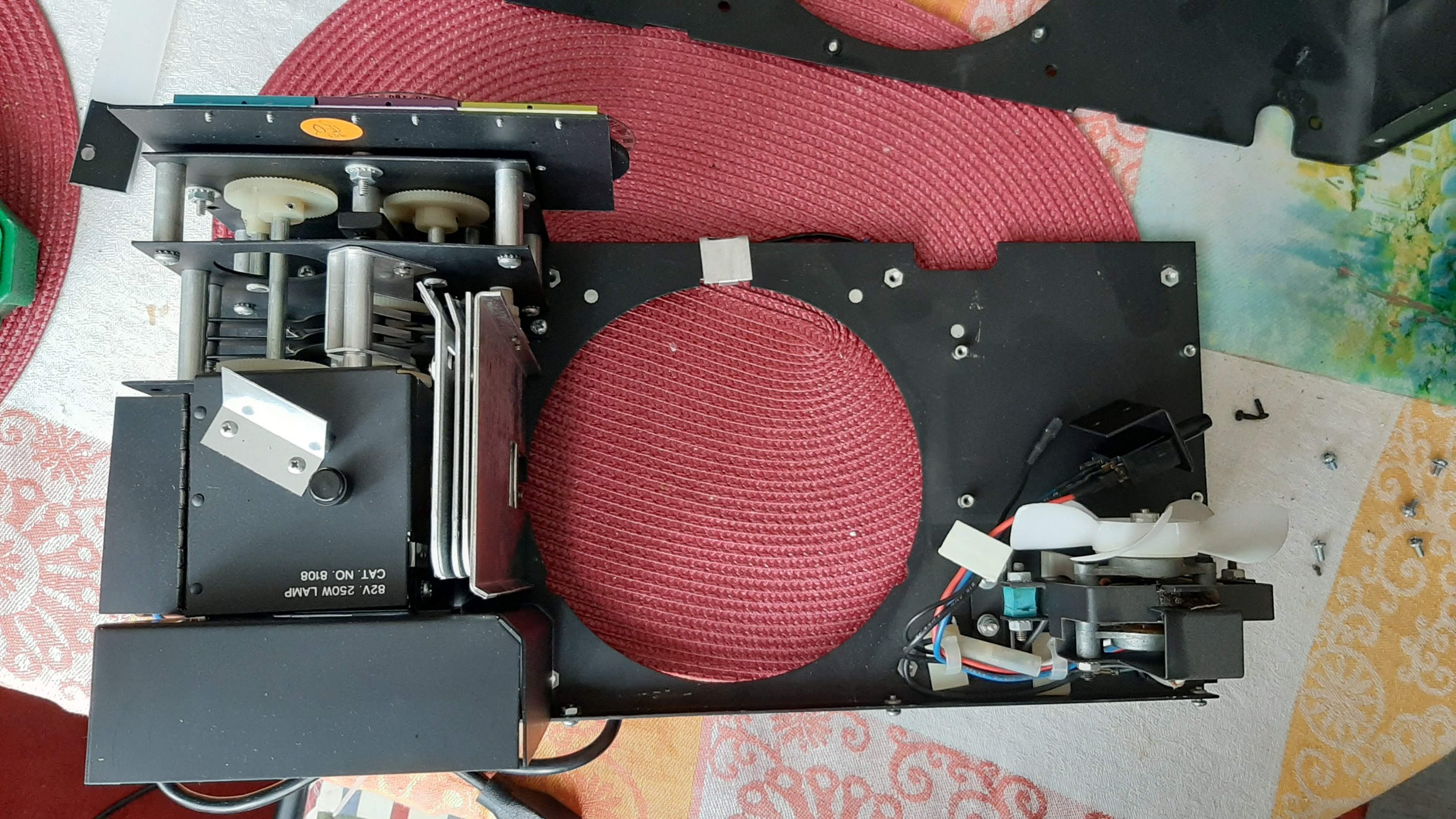

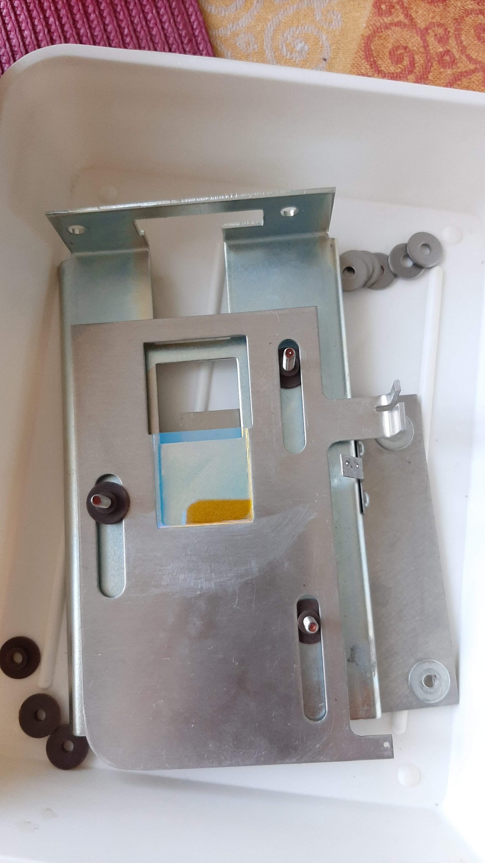

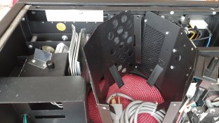

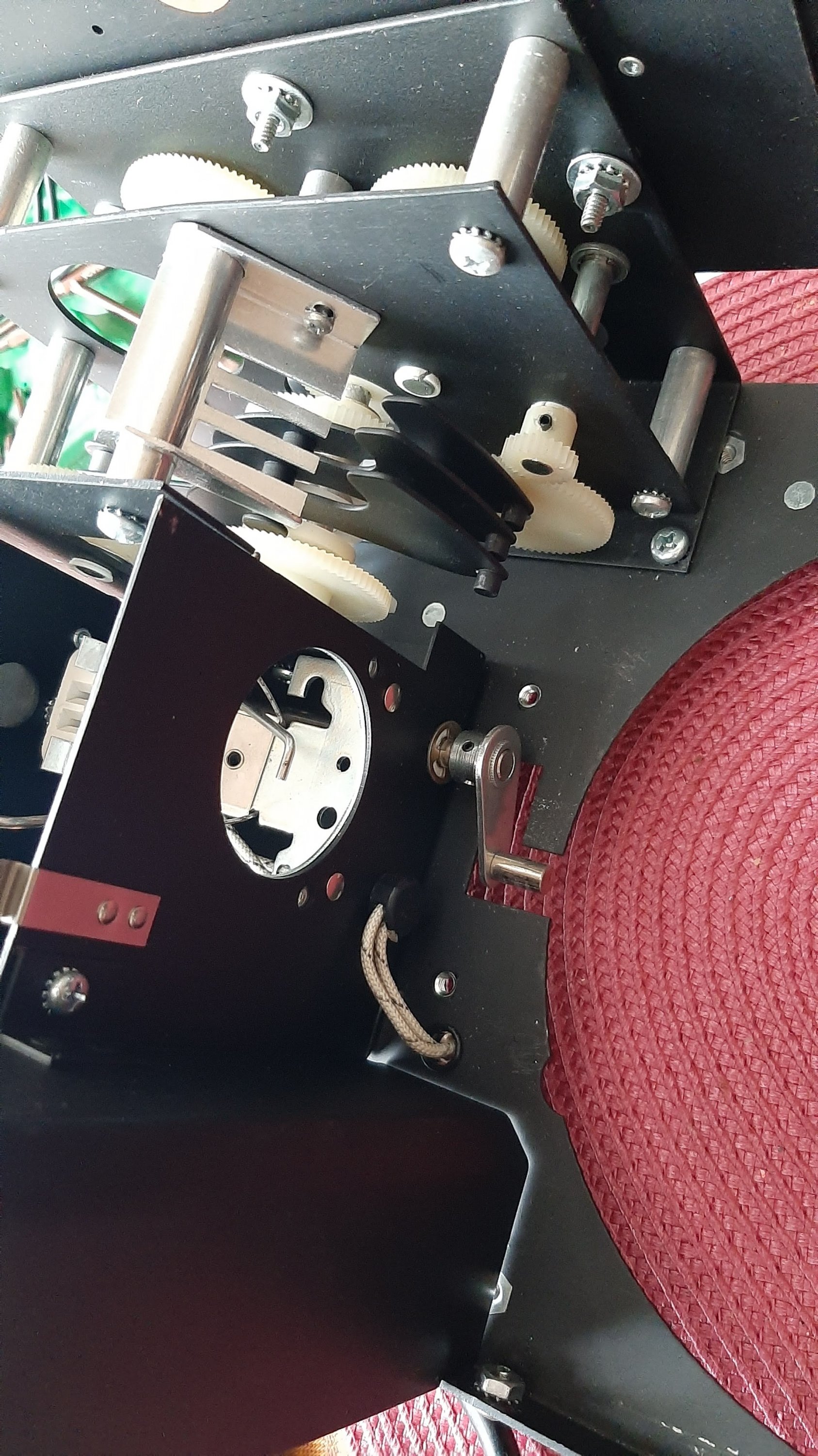

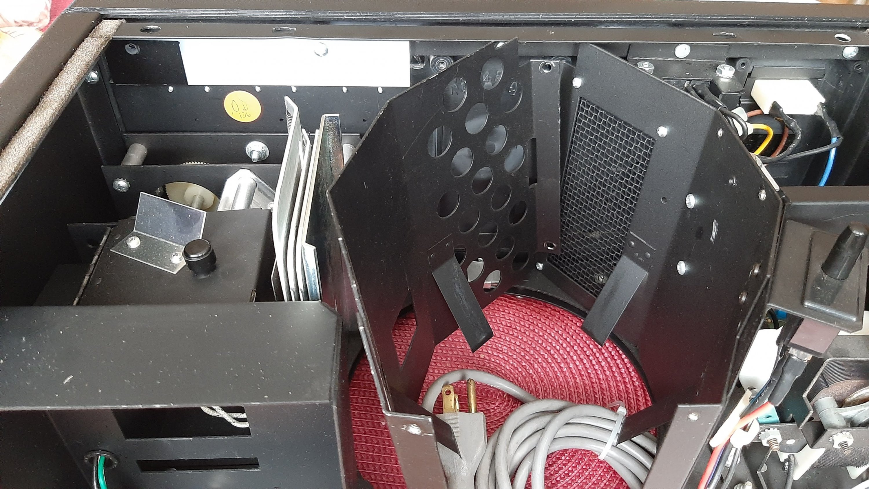

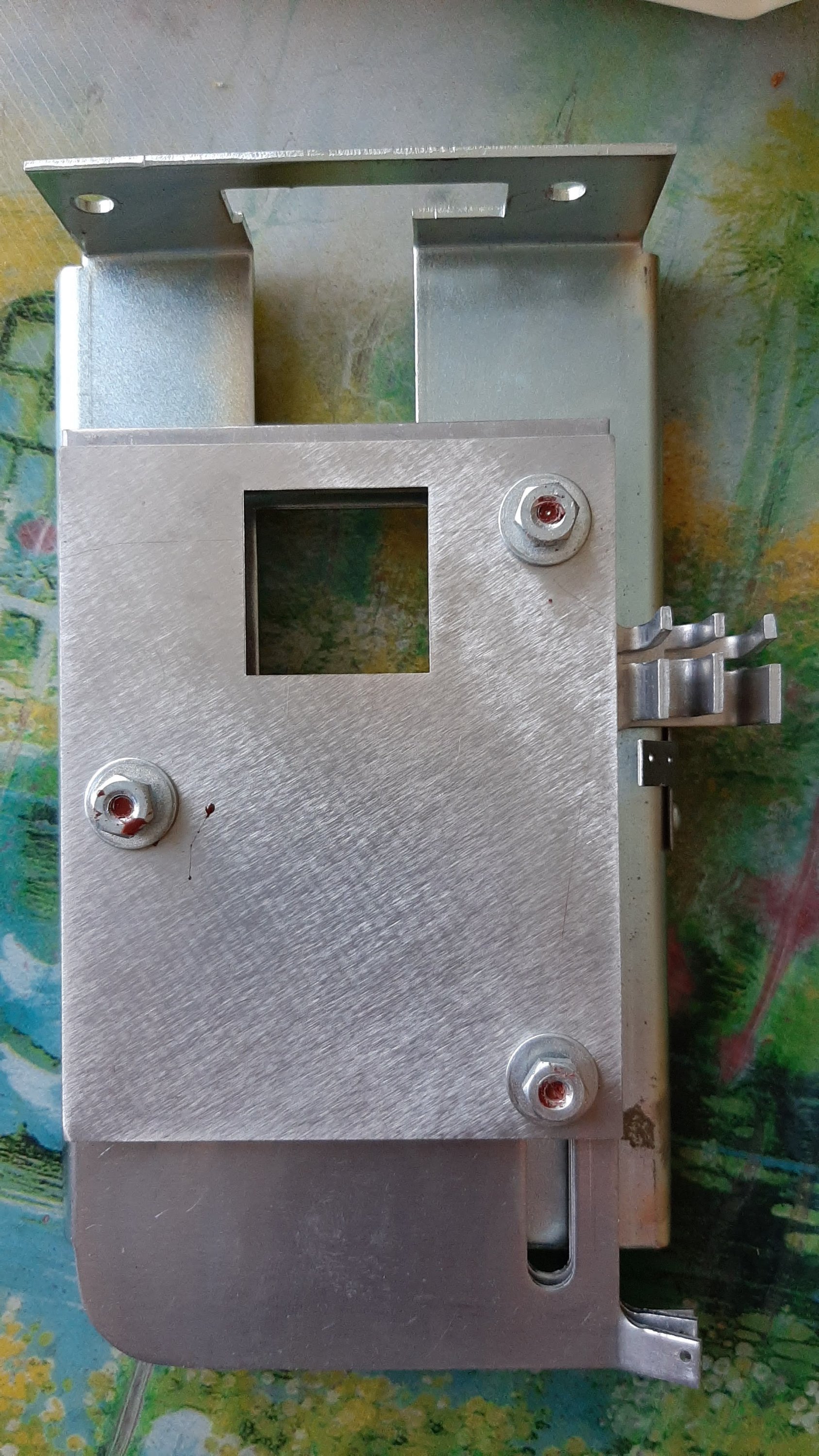

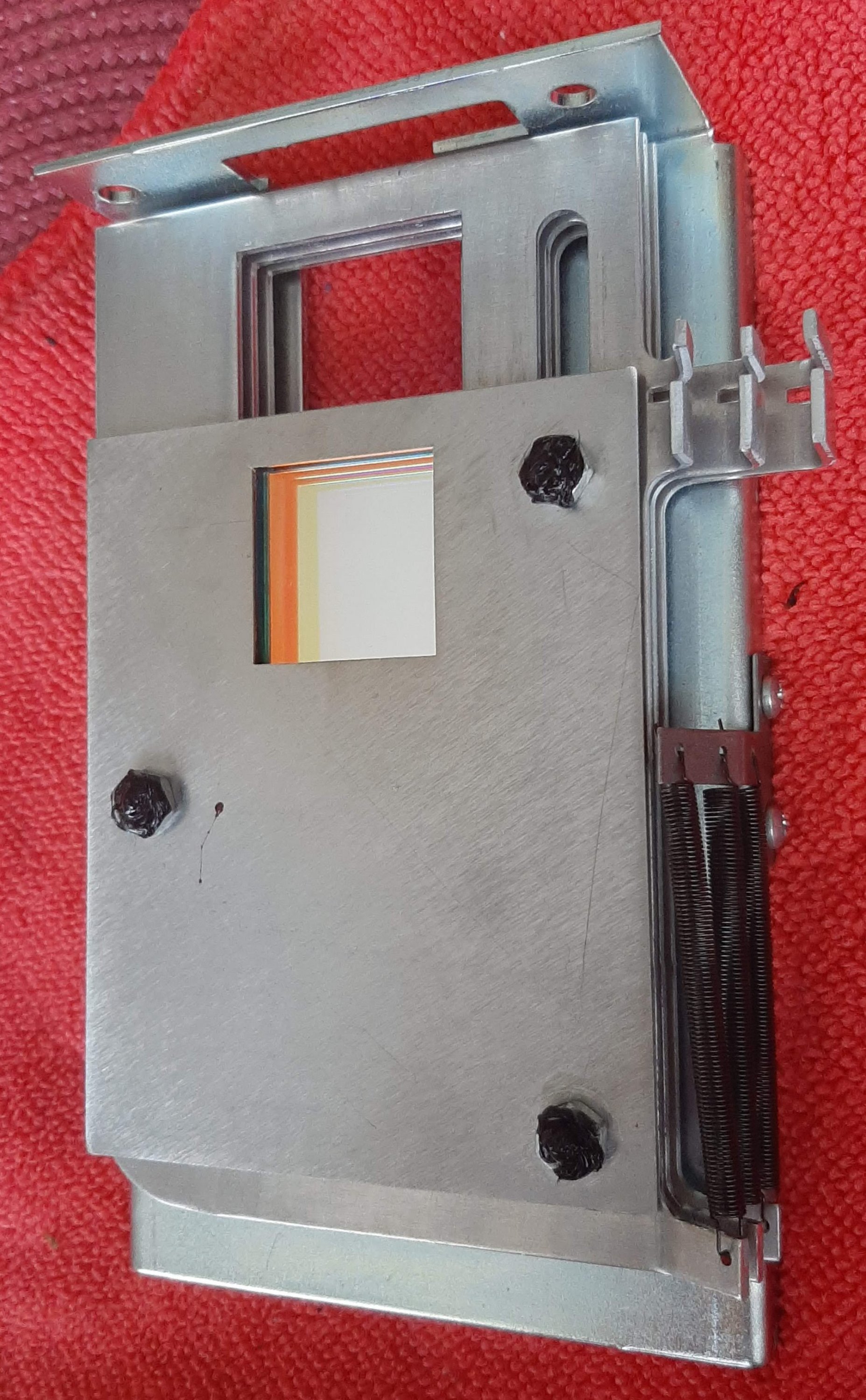

I have a Beseler Dichro 45 head. When I bought it from one of the members here he packed the circuit boards (left in place) very carefully and advised careful re-installation as poor connection where the three boards plug in to the main board is a common problem. Several times I have had odd behavior with the head- LED value indicators not illuminating or with weird values, or a delay in the lamp coming on, or no illumination at all. I dread the Vactrol failure and finding a replacement. Yet each time removing and cleaning the board connections has corrected the problem. I have been lucky so far and I wanted to pass on some valuable advice. I don’t have the 45s head so I don’t know if it is similar inside.
I have an old Dichro head from the USA. So, I had to throw out the fan, electrical plates, and use a halogen lamp for 24V who connected to the power supply 220v -> 24v. There isn't anything that you couldn't repair, except for small color glasses.
P.S. I have no manual :smile:
20200620_144429.jpg 20200620_144433.jpg 20200620_144717.jpg 20200620_145128.jpg 20200620_150219.jpg 20200620_150700.jpg 20200620_152101.jpg 20200620_152114.jpg 20200620_152129.jpg 20200627_140725.jpg 20200627_141530.jpg 20200627_141741.jpg 20200627_154513.jpg 20200627_160625.jpg 20200629_123628.jpg
Hello. Looking for help with my Dicrho 45s color head. It is blowing bulbs. I cleaned all the contacts and measured the voltage at the bulb connections. Voltage is a steady 94 volts. The unit uses 82V 250 W bulbs. Does anyone know the spec output voltage to the bulb socket? If the voltage is correct then the bulbs were both bad. I would have thought the voltage to the bulb socket would be 82V. but I don't have the single line or the specs for the unit. Thanks. David
View attachment 254789 View attachment 254790 View attachment 254791 View attachment 254792 View attachment 254793 View attachment 254794 View attachment 254795 View attachment 254796 View attachment 254797 View attachment 254798 View attachment 254799 View attachment 254800 View attachment 254801 View attachment 254802 View attachment 254803
Those little springs on the filters are difficult. These old ones are analog, no chips. You choose well to get rid of the circuit boards, very obsolete components.
