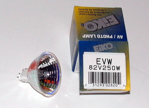

Is FEV the same specs as EVW? When I had some of these heads they were definitely EVW bulbs:
Duncan
Oooh I'm really sorry. You're right. It is EVW. FEV for for my Mole Richardson 200 Watt fresnel. A thousand pardons. I get too smug sometimes remembering my bulbs.
