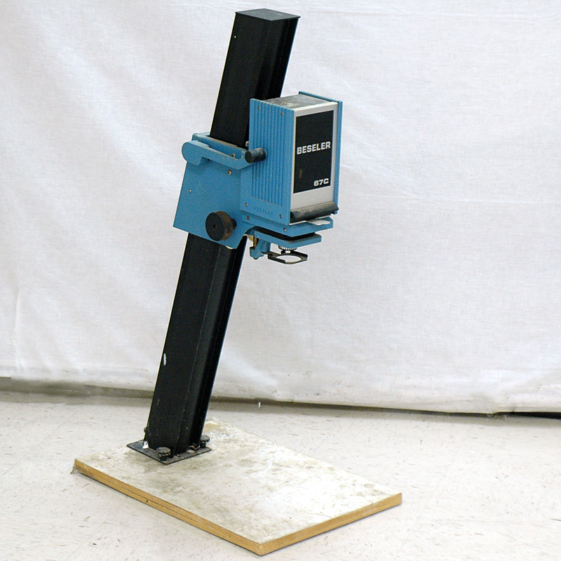

Real bummer here. My 67C XL enlarger won't stay up. I've had it in storage for about 4 years (finally getting around to building a darkroom in my new home!) and when I set it up today, it just won't stay in position - it slides all the way down. I sure hope this is an easy fix. Any idea how to address this problem?
Attached is a photo of this model.

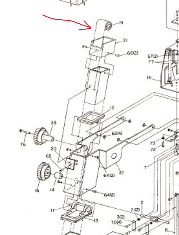

You should have a recoil spring in the top of the column that attaches to the carriage. Check the back of the column top and see if it has become detached.
This is for the 67CP, but it should be essentially the same...

Sorry to also notice your baseboard might be warped! Might have to replace it. A bit of kitchen counter top with laminate from a used counter will work fine.
That picture isn't mine. It's one I got from the internet. Mine is perfectly flat (but it definitely needs some cleaning!).
