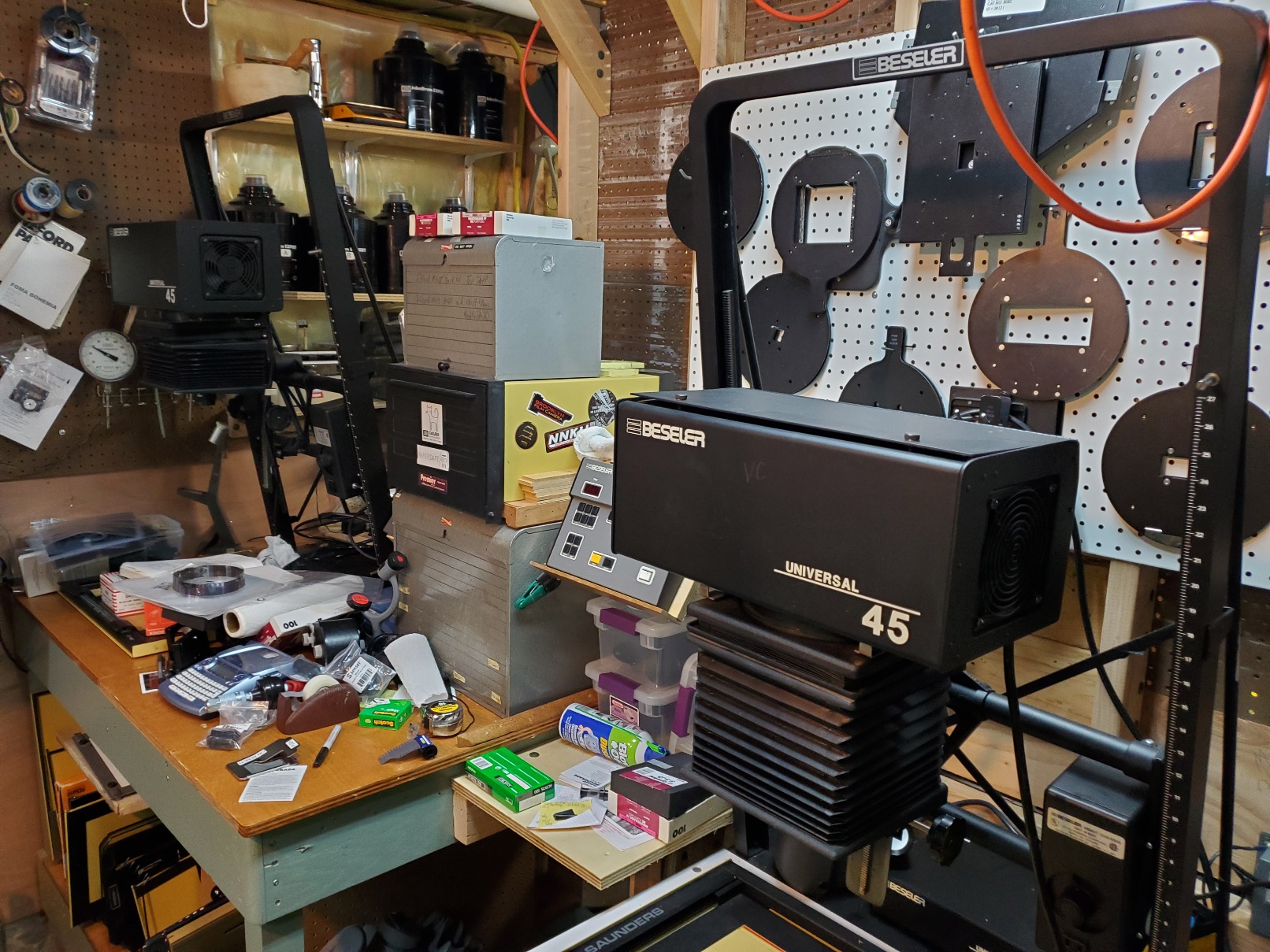

THE UNIVERSAL HEADS THAT I USE 90% OF THE TIME. ONE SETUP FOR VC, ONE FOR COLOR. THESE THINGS ARE NOTORIOUS FOR SOFTWARE AND HARDWARE GLITCHES. MINE WORK, BUT I HAVE BACKUPS. THE CONDESER HEAD SHOWN IS ON A BACKUP UNIT. I HAVE 5 OF THESE ENLARGERS. THE DICHRO S HEADS CAN BE MADE TO WORK FINE, BUT THESE (ALMOST) ALWAYS REQUIRE AN OPTOISOLATOR BE REPLACED. ALL THIS STUFF IS DECIDEDLY 20TH CENTURY TECHNOLOGY. THERE'S COMPANIES THAT MAKE LED LIGHT SOURCES, BUT THAT A WHOLE NEW KETTLE OF FISH

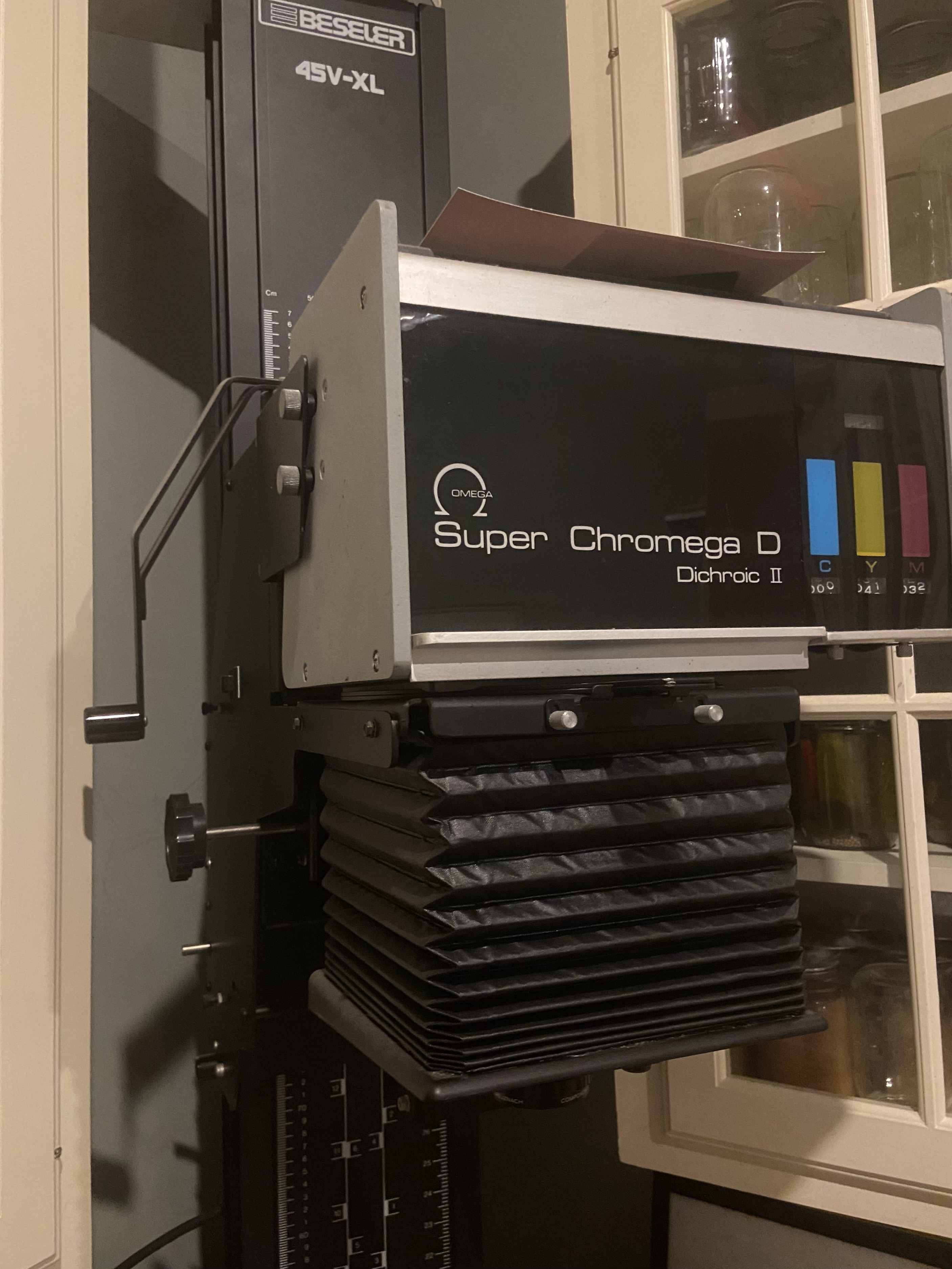

My main enlarger is now a 45v-xl with an adapter bracket too fit an Omega Super Chromega D Dichroic II head. It was the head I was already using on a omega d2 chassis but when I got the 45v-xl it came with the standard condenser lamp house, I already was use too the omega head so I bought the adaptor. I much prefer diffusion over condenser heads.
