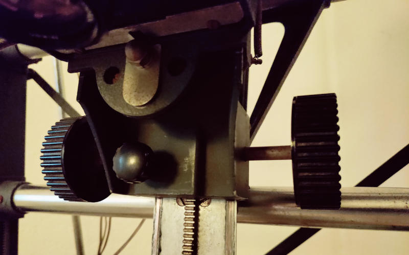

I have an elderly Beseler 45MXT that has a sticky focus issue.
Possibly part of the issue is the plastic guides on the focus rack which when tightened to point where there is no movement leads to a click click as the focus is adjusted and focus is missed be it going up or down the rack.
Do the plastic guides/ slide bearings need to be replaced?
The other issue is the so called focus locking cartridge .
The Beseler parts breakdown offers no detail on what the part consists of.
My enlarger has knob and an all metal plunger that grabs , or doesn't, the focus shaft.
This seems primitive ; I expected a friction spring or nylon plunger; just what should be in the part?
Any help please.?

Could need a tiny bit of lubrication. I would rub a couple milligrams of Vaseline on the aluminum parts. Tiny bit.

The owner's manual specifies Lubriplate.
Yes, I think that is a white lithium grease. Slippery stuff. It doesn't take much. I've experienced the focus bellows jumping a bit. I sold my oldest Beseler 45 I now have 3 setup, newer no problems. These are nice enlargers, not without little quirks.

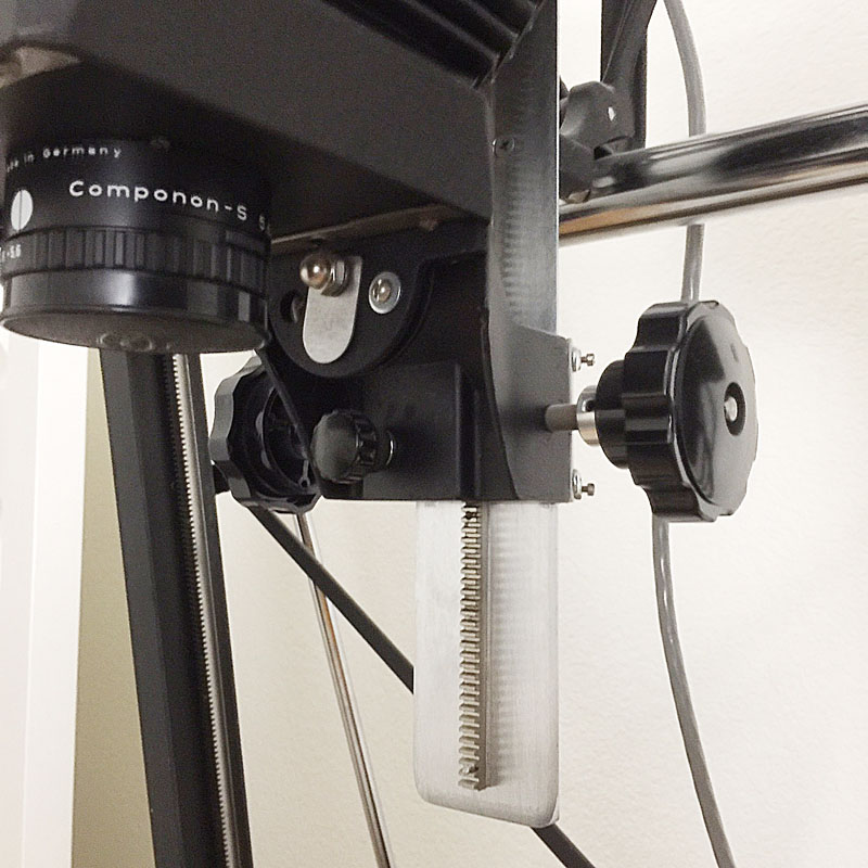

Has anyone pic's of the 'locking cartridge' on the focus rack?
Mine may be a home made replacement.
Here's what mine looks like; Beseler 45MX bought new in 1979.

What is behind the small knob?
I haven't disassembled it to be sure, but based on its position and behavior, I think there's a small block of metal which is behind the focus shaft. When you tighten the knob, you are pressing that block against the focus shaft, making it stiff.

The knob is just a screw that locks the focus in place. So to focus, you loosen the knob adjust focus, then re tighten the knob to hold the focus in place.
FWIW, I've never used that knob to lock focus. I adjust the tension on those plastic pieces until the lens stage moves smoothly, but stays put when the focus knob is released. Never had an issue with unsharp prints due to focus drift.

Link to Beseler parts
There's a knob and a spacer illustrated. This is to lock the lens stage in place. The diagram is for the current MXT model which has a modified lens stage to accept the 3 lens turrets. Wonderful things these turrets.

My mistake, I thought the lock cold be used to create friction on the focus rack, no such luck.
I am going to try and replace the Beseler cartridge with a brass washer and spring !
