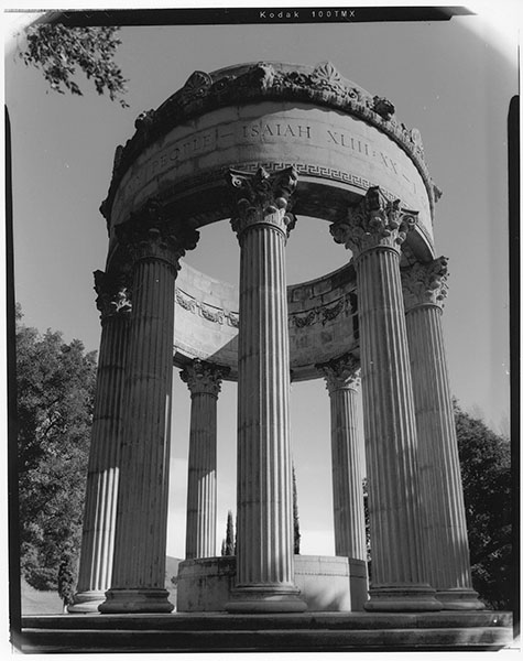

I've attached an example. Yes, the bellows are fully compressed. I'm wondering if, for this type of print, I'll need to change my light source.
The attached is a Tmax 4x5, printed on Ilford MGIV RC at grade 2. Note the corners.

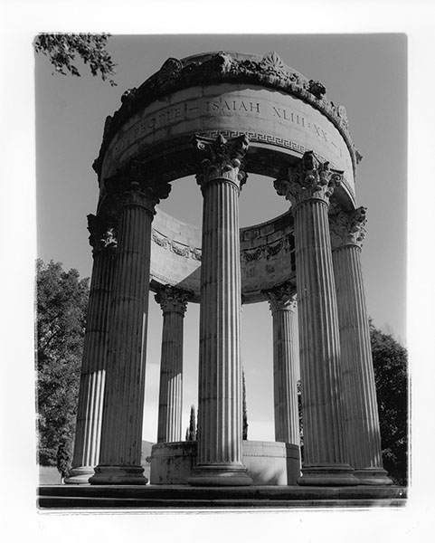

Here is an image using my Beseler 4x5 carrier. I focused inside the blades to show the natural edge of the carrier and the amount of crop relative to the edge to edge negative.
(If you are using the Firefox browser, open each image in a new tab, then tab between them to see the differences.)
