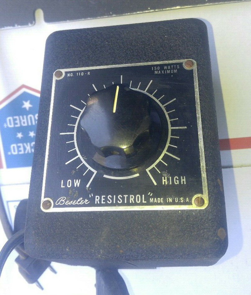

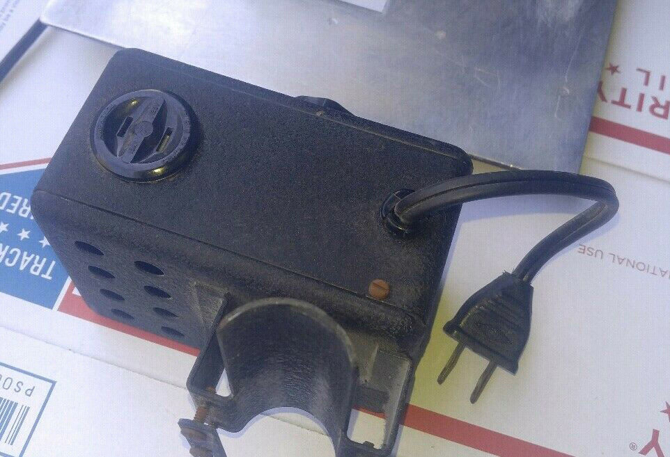

I have a Beseler 45M, the old original one with no other designation than the 45M. Mine has no Resistrol unit, which raises the question if it was ever issured with one. If so I have found a Resistrol off a 45MXT. will it fit correctly on my machine? Here are a couple photos. Thank you.

Good Evening, KN4SMF,
There are older and newer variants of the Beseler 45, but I suspect that a Resistrol unit can probably be used with any of them.
However--I'm not sure it's worth the bother of installing, even though that would probably not be difficult. I have used a 45 MCR-X since the mid-'70's; I can count on the fingers of one hand the number of times I can recall using any Resistrol setting except full power.
Konical
Thank you. I will go ahead and buy the unit, as the price is right. I am figuring using it perhaps permanently set 1 notch below full, just to stretch bulb life. Bulbs aren't as asy or quick to come by these days. Although I have an idea if I follow that route I will probably have some experimenting to do to re-establish what VC filter to use for "normal contrast", since the color of the light will no doubt be yellowed by the reduction.
