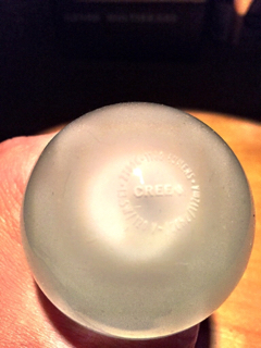

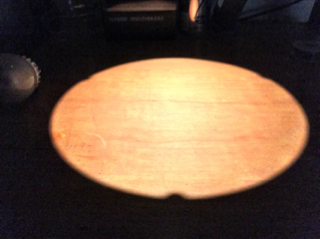

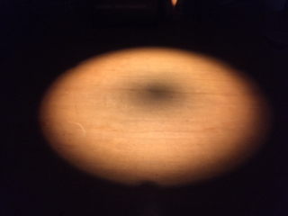

ImageUploadedByTapatalk1430270484.639211.jpgImageUploadedByTapatalk1430270495.557309.jpg
Cree 75W LED bulb. 1100 lumens (13w)
As you can see from the test it did not work. Maybe it's not frosted enough, but the LED's are made to throw light out, just not down. The inner structure of the bulb blocks the top of the bulb which casts a small shadow.
