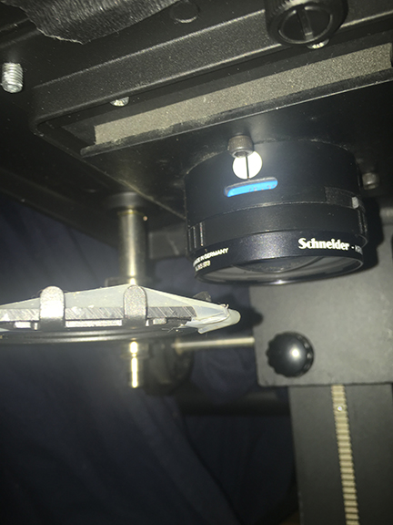

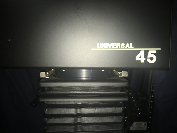

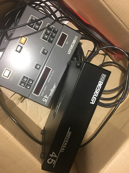

So I bought this baby and I do want to shoot with my 4x5 cameras. Mostly I shoot 6x6 though. This lens on the enlarger is 150mm f 5.6 That should be good for 20x24 prints from the 6x6 film right ? To be honest I am a little intimidated by this machine but I am in the process of building a darkroom right now and will need to be learning how to set it up and use it in a couple of months. Scares me :smile:

I'm not positive, but I think you'll have a problem achieving a 20x24 print from a 6x6 negative on the Bes 45 with a 150mm lens (assuming you're projecting to the baseboard). You'll probably want to acquire a high quality 80mm lens for that much of an enlargement. The good news is that your 150mm Schneider will serve you well for enlargments from 4x5.
That looks like you have a 45V-XL with a Universal 45 head...with the VC controller. I have the 45V-XL with 50, 80 and 150mm lenses with the color controller for the Universal head. Unless you use the enlarger in a room with >8' ceiling height, you will need to set the enlarger baseboard lower than usual...I had mine on a low TV rollabout cabinet when I was in an apartment with it.
The brochure for the 45V-XL says that with 150mm lens a 4x5 film can be projected on the baseboard to 24.25" x 30.75" because of the extra long column of the 45V-XL. That is magnification of 6.7X...applied to 56mm x 56mm neg, result is 14.75" x 14.75"
If you have an 80mm lens, the 45V-XL can magnify to 12.5X, so 6x6 neg results in 27.75" x 27.75" print on the baseboard.

The column is 57", but if you run the chassis all the way up, the height is dependent upon the light source type. Unfortunately Beseler did not publish height with Universal 45 head. (I'd measure mine, but it is not currently set up.) I would estimate it at being 60-61" tall (Beseler condensor color heads get up to 66").
Unfortunately the dimensional specs for the Adjustable Table fail to label Width vs. Depth vs. Height, but simply state: 31 x 25 x 32", and it is also stated that "Maximum full frame print size on the Adjus-Table is 24x36""
Height is either 25" or 32"...if 25" tall table, the fully extended 45VXL+U45 head would be >84" standard ceiling (25" + 60" = 85") but the max full frame print size makes 25" sound like Depth, not Height. In that case on 32" tall table the fully extended 45VXL+U45 head would be >92" standard ceiling (32" + 60" = 92") As I stated earlier, I used a low TV rollabout cabinet with doors, and I just measured that at 18" (18" + 61" = 79"), and 79" is well under the 84" standard ceiling
